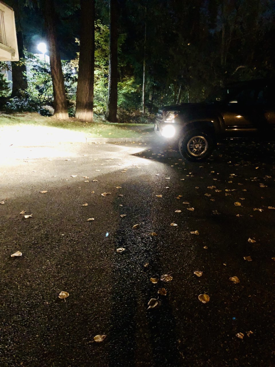

    So I measured the beam angle tonight, using a tape and measuring forward distance vs width distance of the pattern and doing the math to come up with the angle. The OEM H11 'wide angle' fogs project at 75 degrees to the side, which is much wider than the Rigid's 45 degree spec. Other LED fogs seem to replicate a similar width pattern to Rigid. Meaning the OEM fogs cover significantly more area, and provide far more peripheral vision than an LED replacement. Which makes sense then as to why a very weak powered fog like Morimotos that put out less light than stock don't seem that much worse than stock in light intensity, because while putting out less than half the light, they are also lighting only a fraction of the area compared to stock.
    Trying to capture the angle of side lighting in relation to the truck. Fogs only, no headlights. Might have been better to attempt facing the same direction as the light source.

    Thanks for taking the time to measure that. I'm always looking forward to the advancement of automotive lights but it looks like LED still have some areas for improvement.

    Just differing patterns. Keep in mind the 3rd Gen offers 'standard fogs' and the TRD models come with 'TRD wide angle fogs'. I believe this is the same as the 2005-2011 that were the standard pattern, and 2012-2015 which were the wide angle pattern. I didn't think to look at beam width when I had access to an early 2nd gen. The larger area coverage requires a brighter light source to illuminate more area, which is why the OEM wide angle fogs use a 55w 1250 lumen H11 and the standard fogs use a 42w 840 lumen H10.
