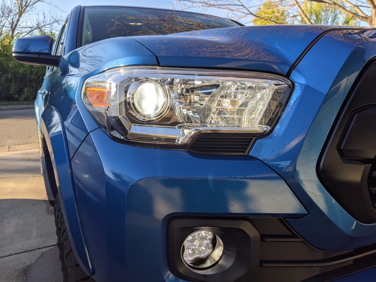

    Installed the Diode Dynamics SAE Clear Fogs yesterday. Much brighter than my Morimotos. Night road test confirms it. Love emIMG_20200402_181252.jpg

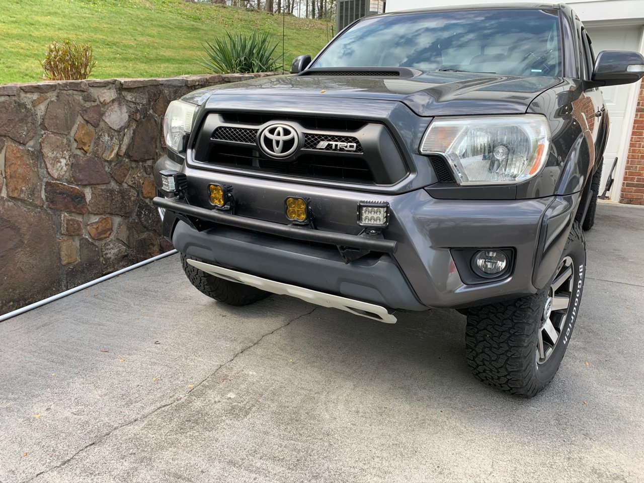

    SS3 Pro’s mounted to replace the KC Slimlites. No night pics but the initial impression of them on inside the garage was impressive. Now I need to find some time at night to aim them better.
    chstaco and herecomesace like this.
