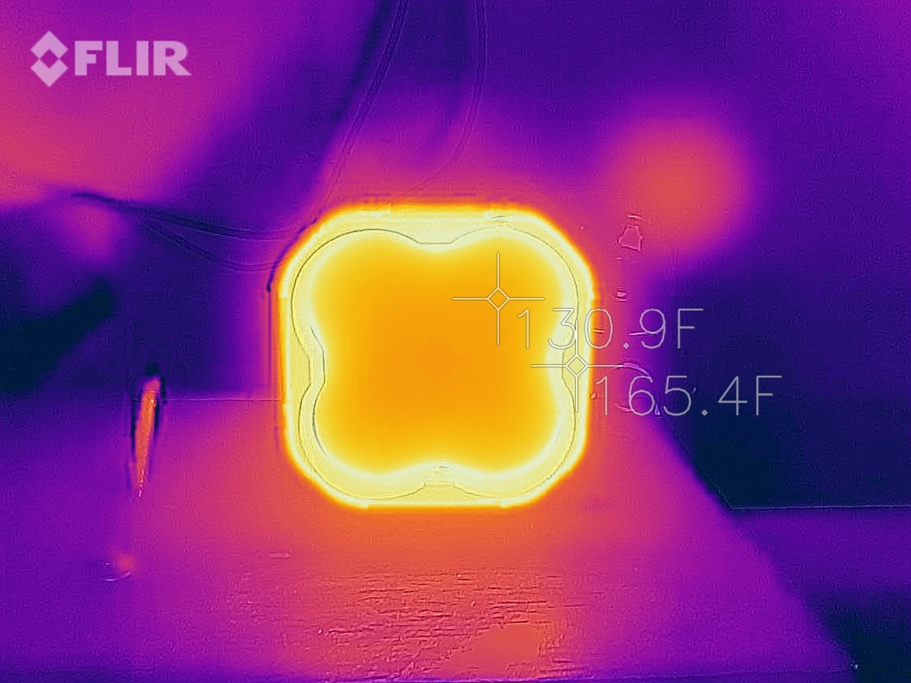

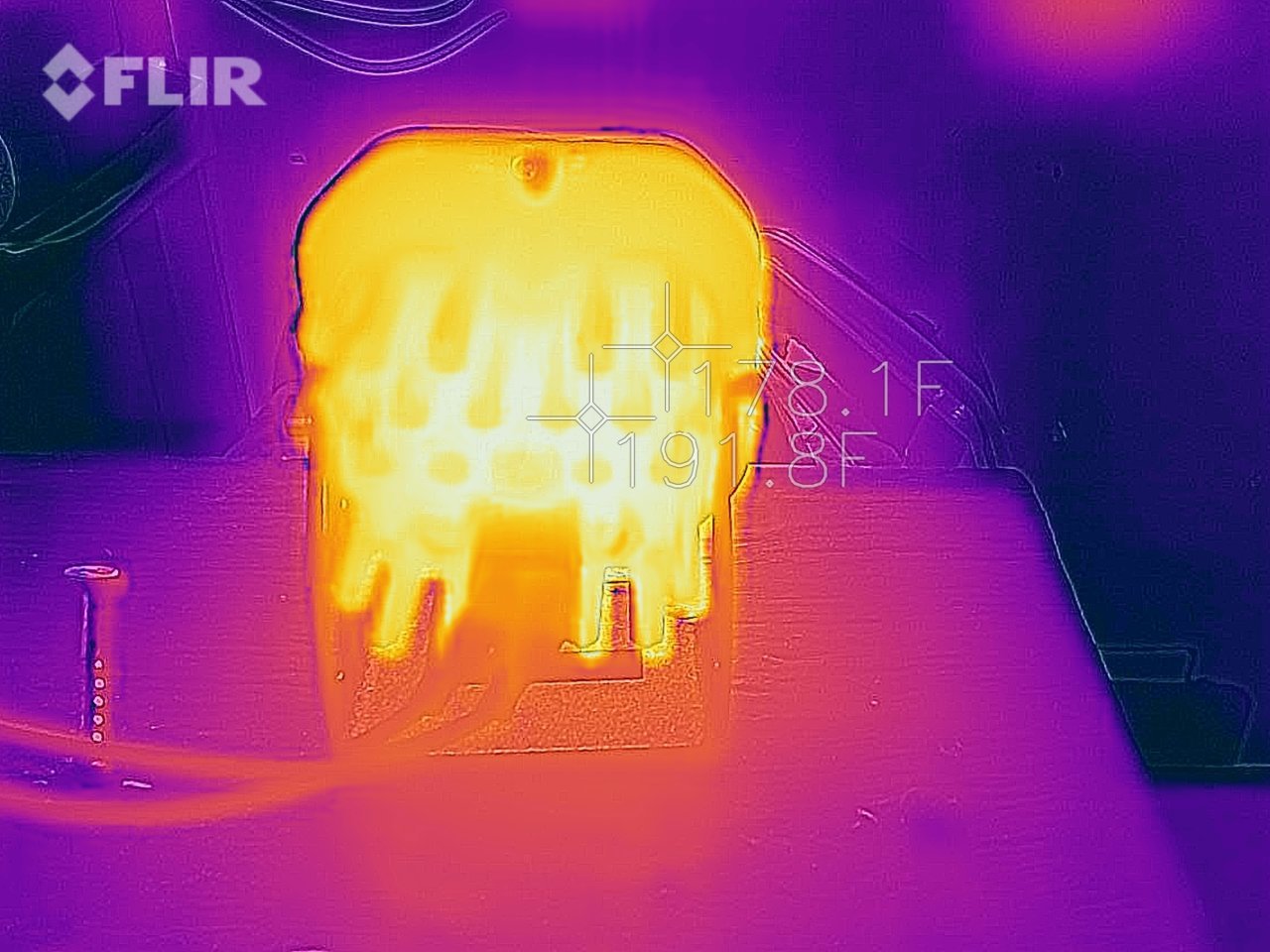

    Measured the SS3 Pros with a new FLIR camera. Measurements after ~20 min runtime in 63 degrees F ambient.
    Back
    Front 6000k Pro w/clear spot optic
    You can see the bodies are quite toasty. The yellow optics would run hotter on the lens than the clear tested here. The thermal spot on the wall in the upper right was when the spot beam was pointed while the lamp heated up.

    #208155
    27,139
    Eddie
    '13 Barc. Red Tacoma SR5 4X4
    Is that in the Sun or in the Shade? :notsure:
  11. Apr 18, 2020 at 7:13 PM
    #3071
    crashnburn80
    crashnburn80 [OP] Vehicle Design Engineer
    Jun 6, 2015
    #156893
    14,772
    Kirkland, WA
    2003 DCSB TRD OR
    63 ambient? As measured by the smart garage door’s digital thermometer, in the garage. :)

  14. Apr 18, 2020 at 8:44 PM
    #3074
    Diode Dynamics
    Diode Dynamics Automotive Lighting Experts Vendor
    May 26, 2016
    #187969
    896
    St. Louis, Missouri
    Cool! Just for anyone concerned - like all our products, the SS3 is age-tested in 85C ambient temperatures (185F). It has a circuit built in to reduce power draw if it overheats as well. The high heat is intentional, and fully within the operating specs. Thanks!
  15. Apr 18, 2020 at 9:51 PM
    #3075
    crashnburn80
    Jun 6, 2015
    #156893
    14,772
    Kirkland, WA
    2003 DCSB TRD OR
    I view high heat as a plus in the fog application and didn’t intend for the post to be alarming in any way. There were 2 traits that prevented me from switching to LED fogs for the longest time. High color temp and lack of heat. Without heat the fogs freeze over in snowy conditions, which is my primary use case, making the product worthless to me. The SS3 Pros run hot, which I like for this application and makes me confident they will perform in the snow when needed. A few have now started to offer selective yellow, which is better for poor weather conditions than high color temps. The SS3 Pros combination of hottest fog, selective yellow color and best in class output by far make the Pros an easy choice for my needs.

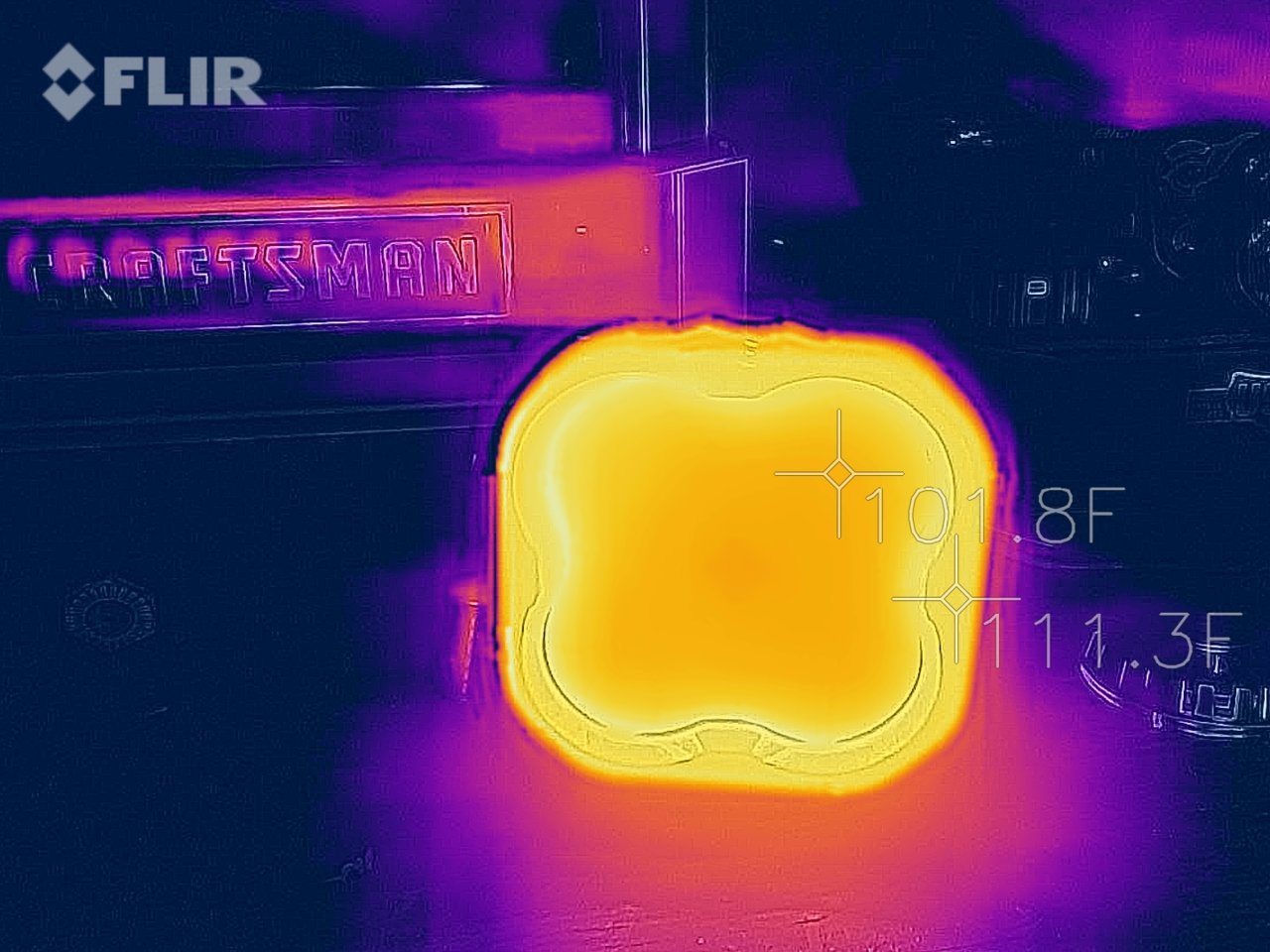

  20. Apr 19, 2020 at 12:20 AM
    #3080
    crashnburn80
    Jun 6, 2015
    #156893
    14,772
    Kirkland, WA
    2003 DCSB TRD OR
    These were run for over an hour and tested at 61 degrees ambient.
    SS3 Sports, 6000k spot optic
    Comparing the Sports to the SS3 Pros, the Pro body is about 67 degrees hotter and the Pro optic is almost 30 degrees warmer than the Sport in 6000k spot.
