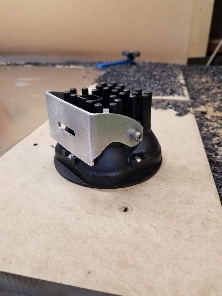

    remember, those BD lights are only a offroad light. should never be used on road. You should like the DD lights, but like you i had major issues getting them to fit, but a custom bracket later and seems to work fine :D

    my dislikes are how large the bezels are, and that caused me issues trying to get them to fit in my bumper. I ended up making custom brackets to get them to sit lower and be more centered in the opening.

    Do you have a picture of the fitment? Before and after the custom bracket?

    Note that he isn't talking about running them in the stock bumper, it is for an aftermarket bumper. And it appears he has the larger round bezel face, vs the smaller standard one or the OEM style one used for the OEM mounts.

    Ahhh make sense. I thought they looked off. I was wondering why it didnt have the angled bezel.
