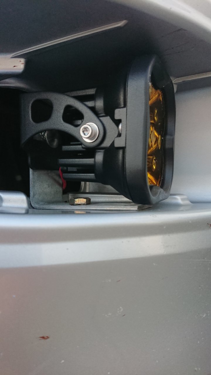

    Yeah, I learned that pretty quick. I tried to use them like my highs for bad weather and they worked awesome for that.
    Mine just has some little molded tabs that I had to trim, you can kind of see them here behind the light (this them mounted upside down)00100lrPORTRAIT_00100_BURST20200404083938556_COVER-01.jpg
