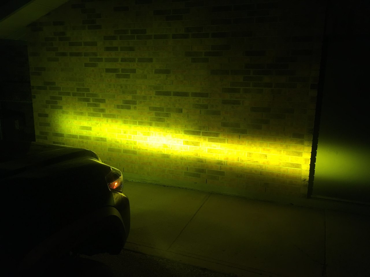

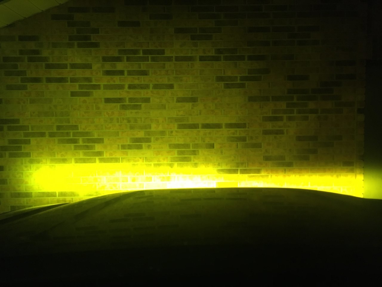

    For anyone curious, here's the BD Squadron Sport WC non-SAE (left) compared to the DD SS3 Pro (right).
    The BD is obviously not meant to be a street fog light, but they still put out some great light offroad. I'll be mounting mine as ditch lights.
    Anyway you can see the wider beam pattern of the DD's as well as the difference in cutoffs. What I found most interesting though was that the selective yellow of the the DD's is a slightly warmer deeper yellow than the BD amber. All of my reading on the internets had me expecting the other way around.

    @Taquitoma it looks like the BD filters out less green than the DD's do. Could just be the spectrum difference of having to filter from a 5000k led versus the 4000k led of the DDs.

    Nice comparison shots. I too have noticed that my S2 ditch lights are decidedly greener than the Diode SS3 fogs. Also nice to see a pattern comparison, it's easy to see why the offroad squadron shouldn't be run on the street.
    That's my guess as well. Kudos to Diode Dynamics for making that decision instead of continuing the trend of handicapping selective yellows with high temperature emitters and heavy filtering.

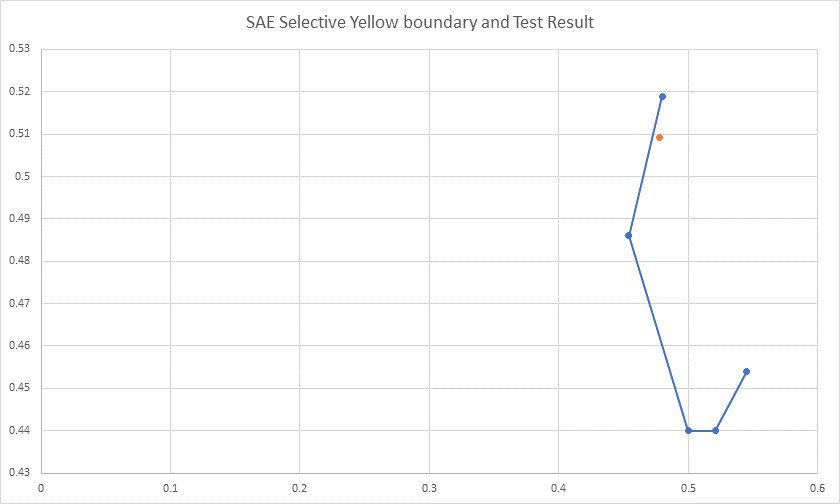

    When we first tested the SAE selective yellow with our standard amber lens it did fail, by a miniscule amount. It was so close to passing that instead of making a custom lens, we decided to improve both the white and amber versions with a slightly warmer LED color temperature (4500k instead of 5000k). This subtle change brings the light within the selective yellow boundary points in combination with our amber lens and also as a white fog lamp to further reduce harsh white glare bare you get from higher color temperatures.

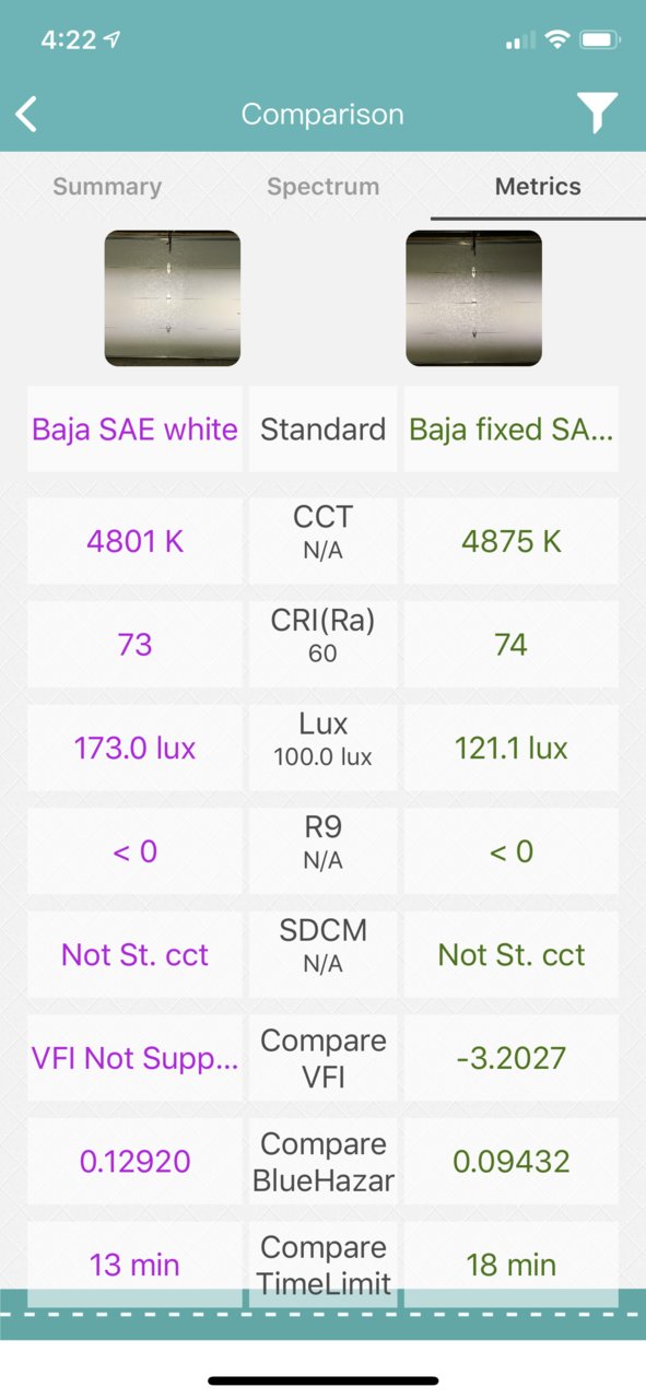

    Thanks for the information, that makes sense to use a warmer color LED to keep your lenses the same and is a more efficient design choice than using darker lenses. Glad to see this detail was not overlooked. It was not clear that your SAE fogs are supposed to be 4500k when they are specifically advertised as 5000k. When I measured the white SAE squadrons most recently I got a color temp of 4875k, which I figured was reasonably close to the advertised 5000k spec (not knowing they are actually supposed to be 4500k). The first SAE Squadrons I measured came it an 4801k. It is possible that by being so close to the edge of the chromaticity window that the LED binning may not be tight enough and some units are shipping with too high of a color temp causing them to be out of spec. While there is always some variance in the LED color temp based on the binning, the units I received were both closer to 5000k than they were to 4500k.
