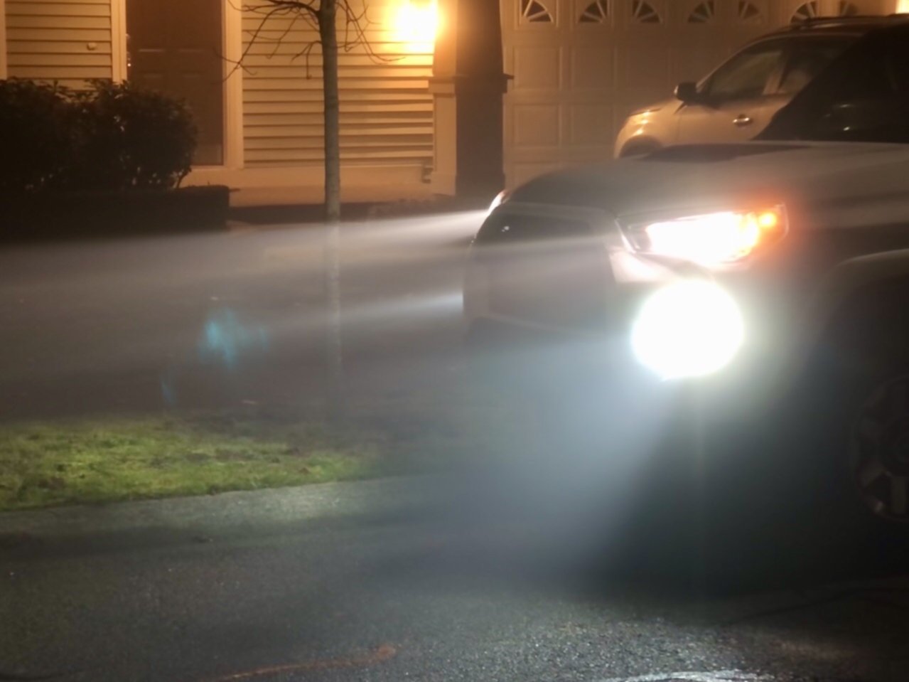

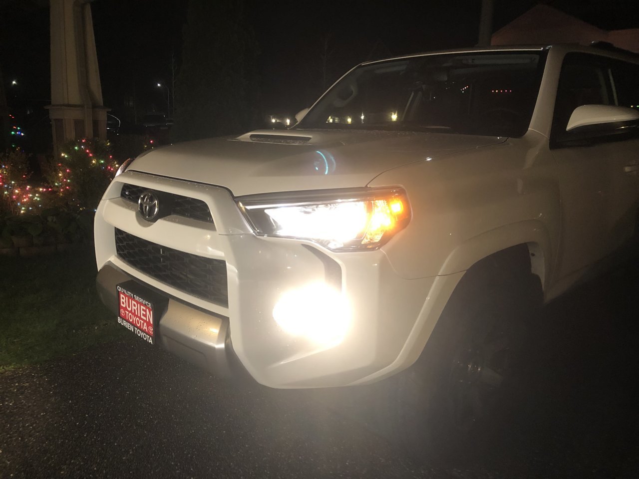

    I used to run Philips LED’s before the SS3’s and glare was atrocious. I would only turn it on when no one was around at night.

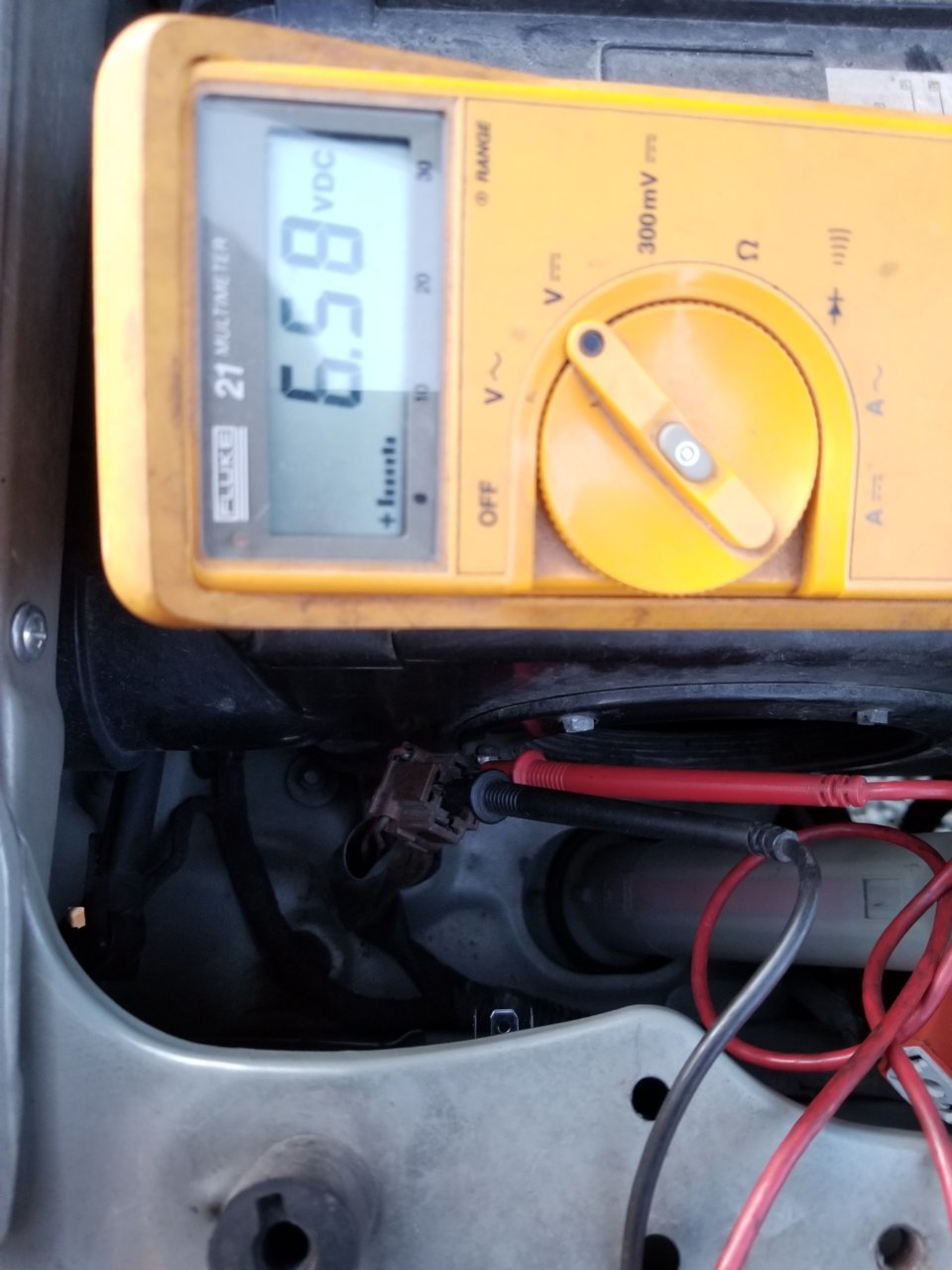

    And mine should be arriving today. Stoked. Now I need to address my electrical gremlin, I've got a ~6.5V leak across my lowbeam circuit when my highbeams are activated, which keeps my lowbeam relay triggered, running both filaments simultaneously. Not good. Replacement headlight switch didn't fix it previously.
