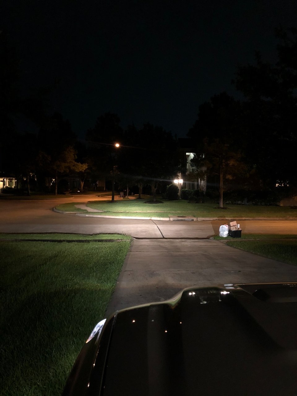

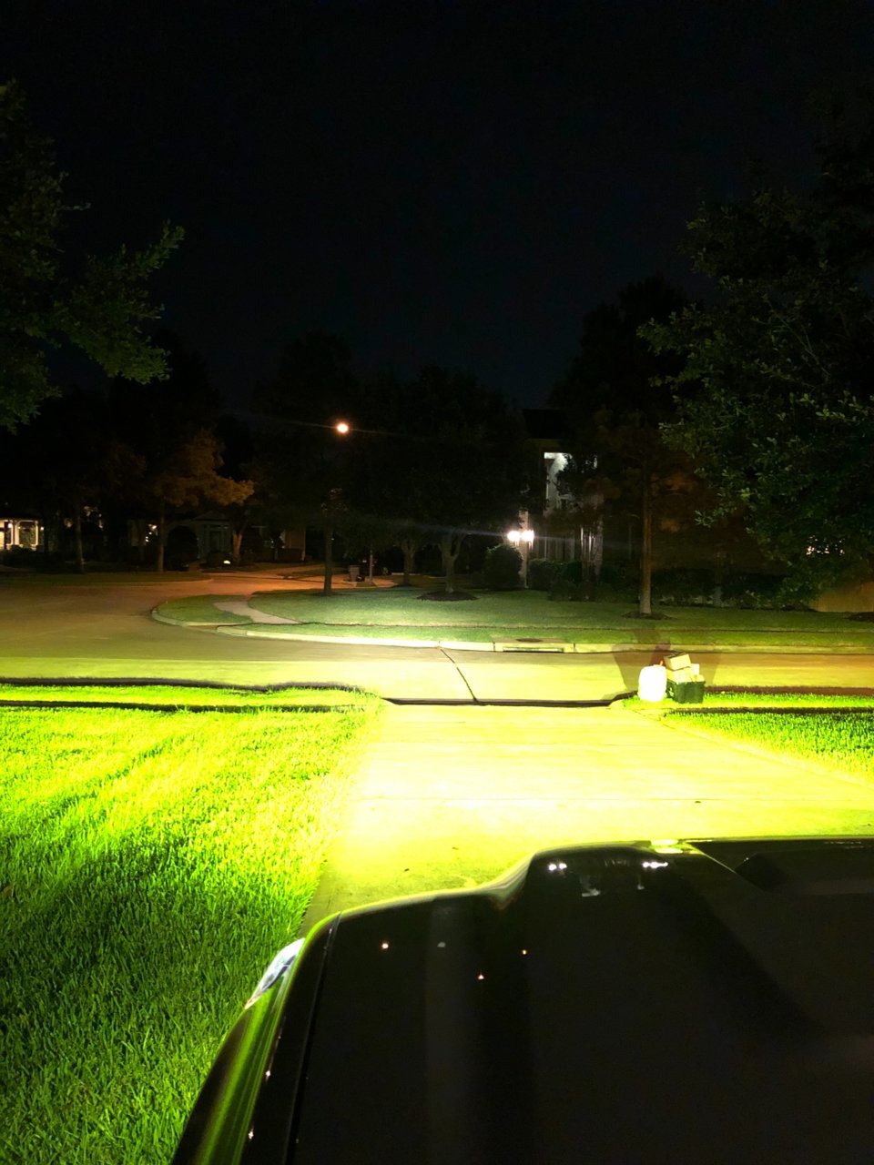

    Here's a couple of photos for anyone considering diode dynamic's SS3 Pro fogs. The top photo is headlights only, the bottom is headlights + fog lights. I locked the exposure before taking the photos which is why the second picture looks so much brighter. In my excitement I forgot to take a photo with the stock fogs but whatever.

    Well... They look awesome! However, I think we may have another issue :facepalm: (This is what I get for placing a stocking order way in advance :rofl:)
    Check your email :bananadead:
    For everyone else scratching their heads as to what I am referring to I believe that the above photos are what you will get when you place a yellow lens over the cool white Diode Dynamics LEDs.

    6000k emitters + yellow lens = green output. Highly unlikely to fall in the legal selective yellow chromaticity window requirement. Higher color temps require darker amber lenses to correct the output to selective yellow. You’ll notice Diode Dynamics SS3s have the lightest yellow lenses as they use 4000k emitters. Bajas are slightly darker as they use 4500-5000k emitters. Rigid’s are darker still as they use even higher color temp emitters. While the SS3s can swap selective yellow to clear for 4000k, you shouldn’t swap the 6000k white with a selective yellow lens, as the output will be too green.

    It was a production error that struck some of the earliest orders in this latest run. My stocking order was put in very early, and as a result I was the recipient of some of the first lights after production. Myself, nor the customer, modified the lights that he has.
    The only reason I even post up is because I don't want anyone thinking that the color temp that he was showing is representative of what one should expect. It was just an error. We're getting it taken care of! :thumbsup:

    Yes, we did have an error in a single production batch, which we've been able to isolate - we are working to notify any affected customers now so we can get things swapped out. We have implemented a number of new controls in our production process already in order to avoid any further error like this, as well as additional FMEA steps in production setup in order to prevent errors like this in the future entirely. I'm sorry for the trouble, but please feel free to reach out to us directly if you do not hear from us or your dealer soon!

    One thing I am noticing now more clearly, after reading up, is how fog lighting really does not help distance vision at night and can actually hurt it.
    For the last two photos posted with and without fog lights, notice how the other side of the street is actually better defined without fog lights than with. Imagine if current vehicle speed was 25mph, which configuration would be safer. Particularly the curb and gutter edges and height. The presence of significantly more light in the foreground actually detracts from definition at distance.

    Yep, intense foreground lighting from the fogs that overpower the headlights is very bad for distance vision.
