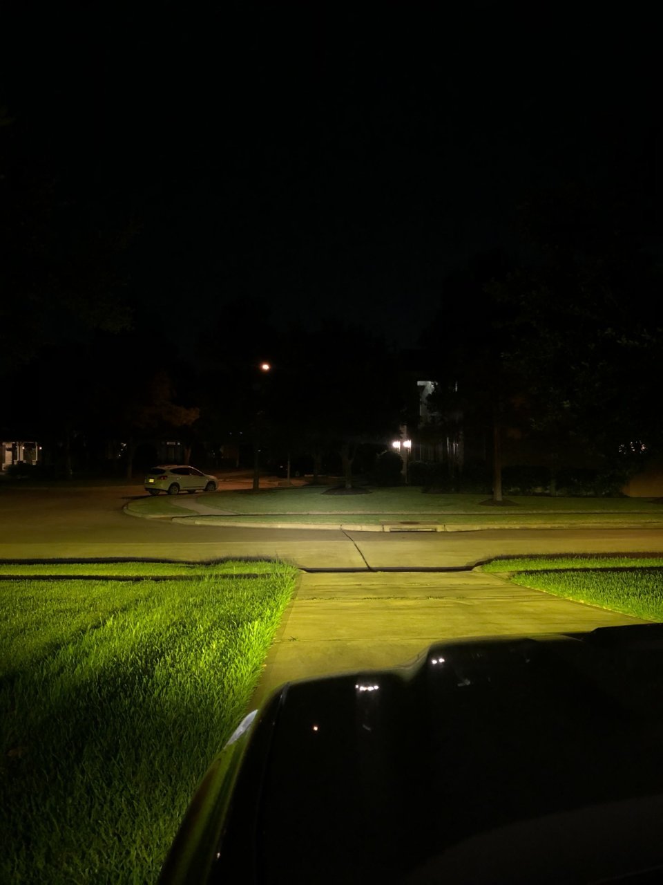

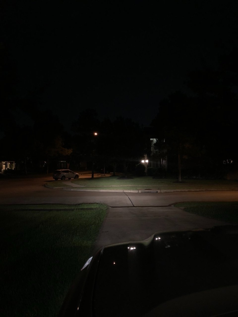

    Alright, let's try this again. These photos are meant to showcase the correct color profile (I may need to angle the lights down a bit), as my previous post was with the wrong color temp LEDs. First photo is headlights only, second is headlights + DD SS3 Pros. @Diode Dynamics was very quick about sending the replacement set after finding out about the production error in my previous set, so props to them for that. @memario1214 was also incredibly responsive and helpful throughout the whole process - you guys should all buy your lights through him. The build quality is excellent (like way better than stock), and the correct color profile is much easier on the eyes.

    #3300
    memario1214
    memario1214 Hotshot Offroad Moderator Vendor
    Oct 1, 2009
    #23628
    20,149
    Colton
    Missoula, MT
    SOLD - 05 Dub Cab TRD Sport 4x4, CURRENT - '21 Tundra MGM Limited
    Oh yeah! MUCH BETTER!
