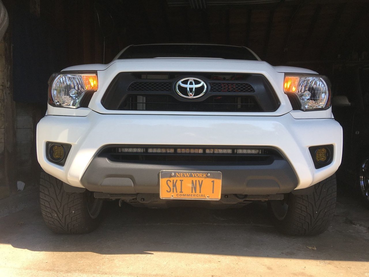

    Yes, I'd recommend the best stuff you can buy in both patterns - but each for a different use. The DD SAE fogs are currently the best you can get and they work great for illuminating the sides of the road and a bit out front for driving in nasty weather. Although not recommended, you can drive with them on whist on the road and if properly aimed, not bother oncoming drivers. I chose the Selective Yellow because it penetrates snow and fog better, but the Clear versions are pretty sweet too.
    I use the high beams and the DD 30" Stage Series LED bar (I have the bar wired through a relay to come on automatically with the high beams) for long distance vision. Because the DD bar is so powerful, I'd recommend the all Driving pattern over the Combo. And trust me, this bar absolutely blows away all cheap Amazon bars as well as the Caliraised dual row bar it replaced. As with any high beam or LED bar, you don't want to use it when any oncoming drivers are near. Proper aim is critical with any long distance lighting and it took me a few tries to get this one right.
    As for the Ultimate Headlight Upgrade, it will give you killer low beam performance without bothering oncoming drivers. On high beam, it will significantly improve your distance vision. Put all three of these together and it's an awesome combination. Here's what all three look like on my truck:

    Which brackets are you using for the light bar?

    CaliRaised hidden light bar brackets.

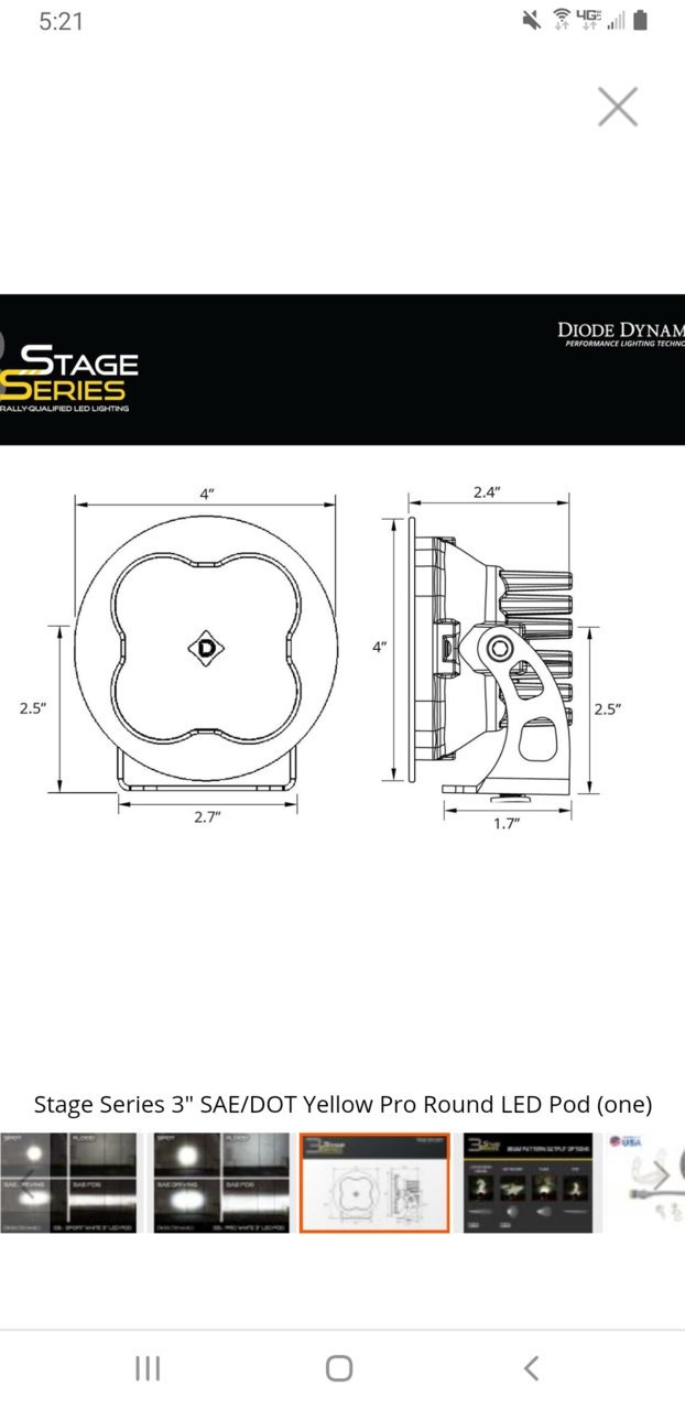

    Does 3 inches mean it includes the outer plastic bezel or diagonally across just the led portion.

    3" is the approximate width of the lens portion. Here's what you're looking for as it relates to those flush mount ones you have listed. :thumbsup:

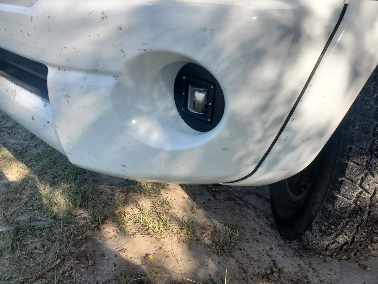

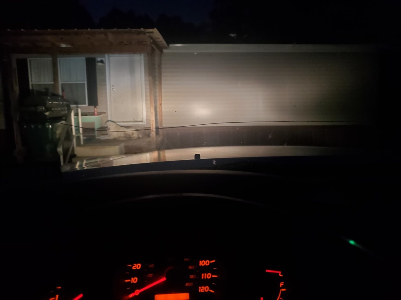

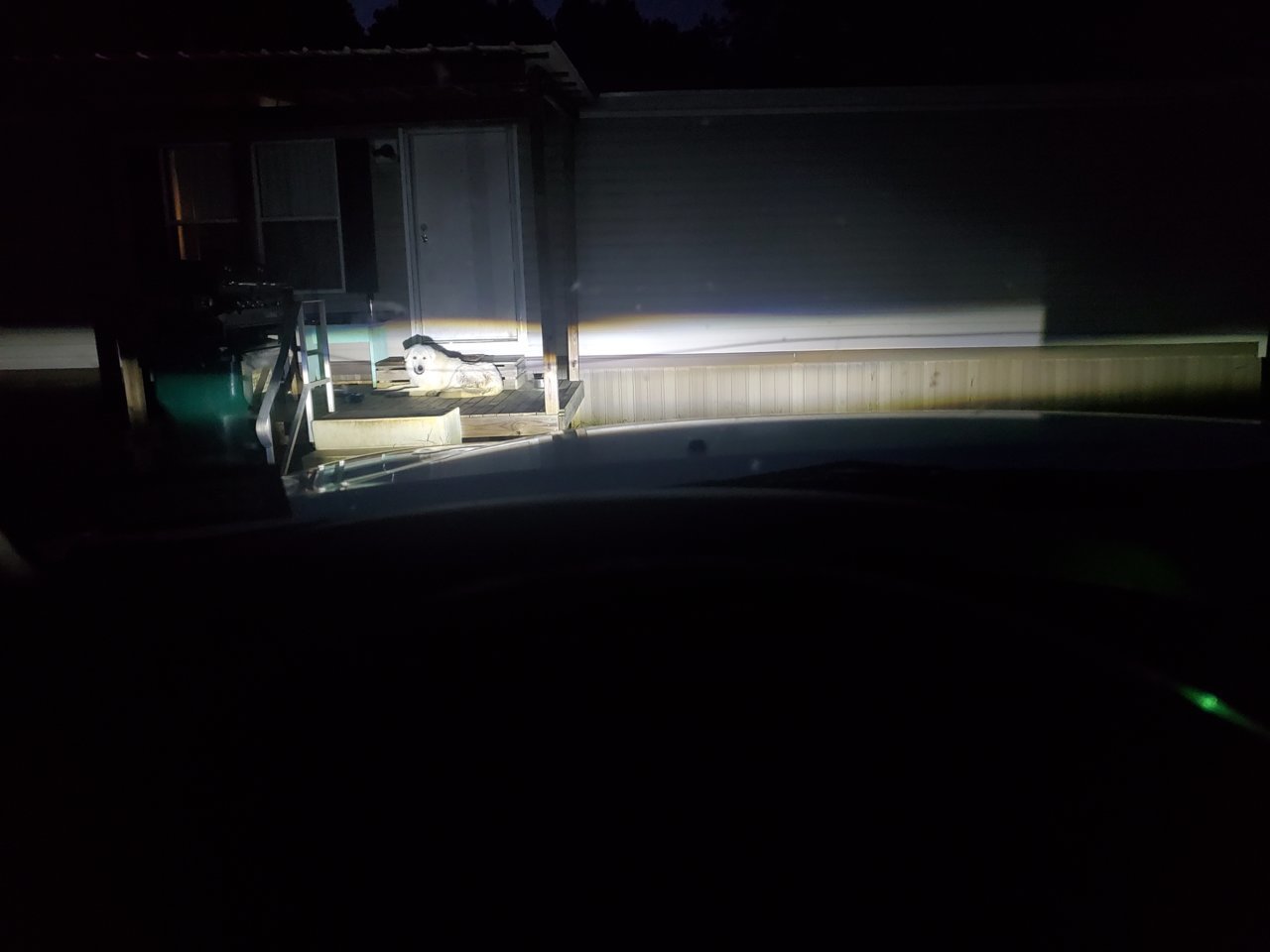

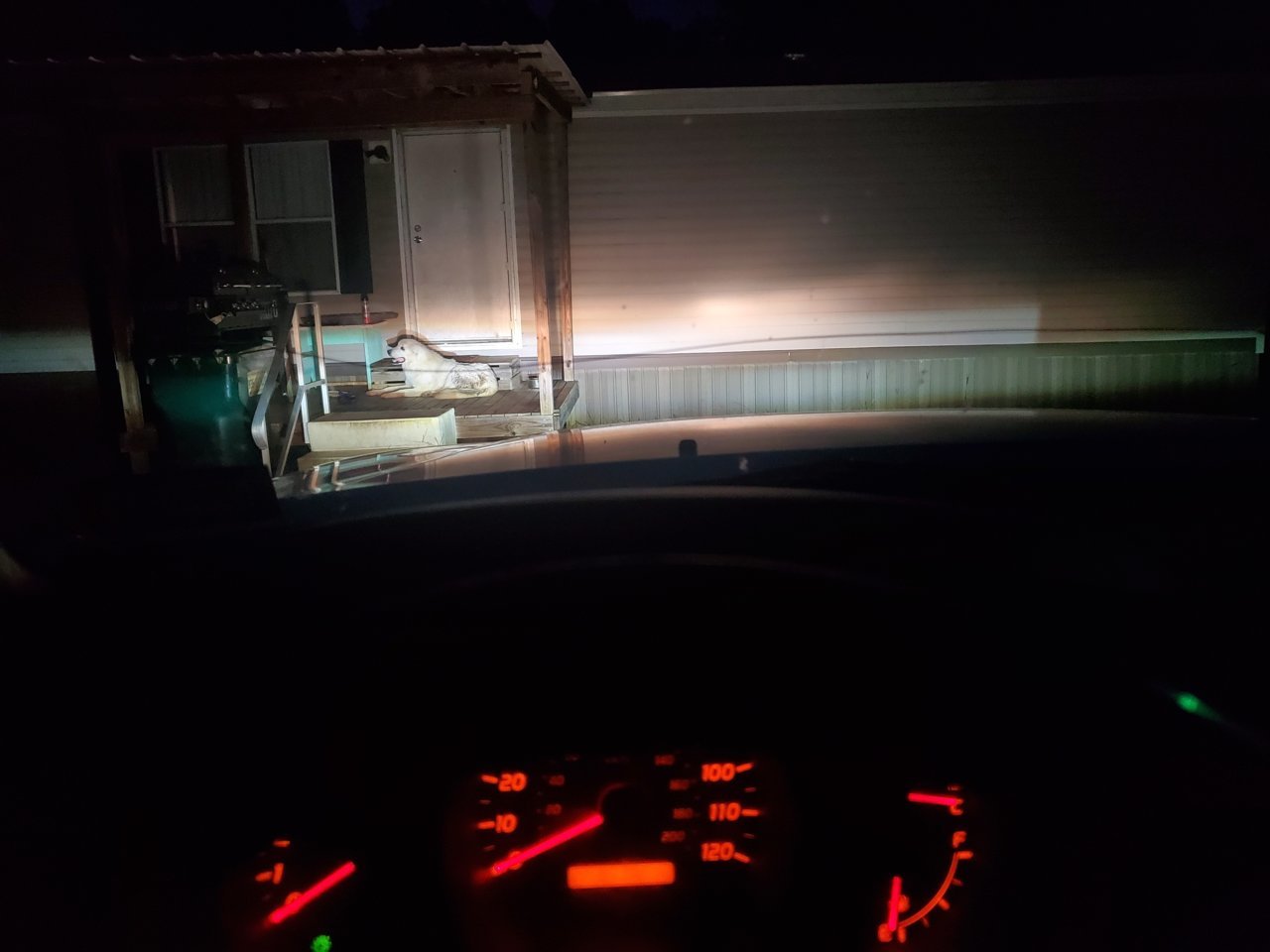

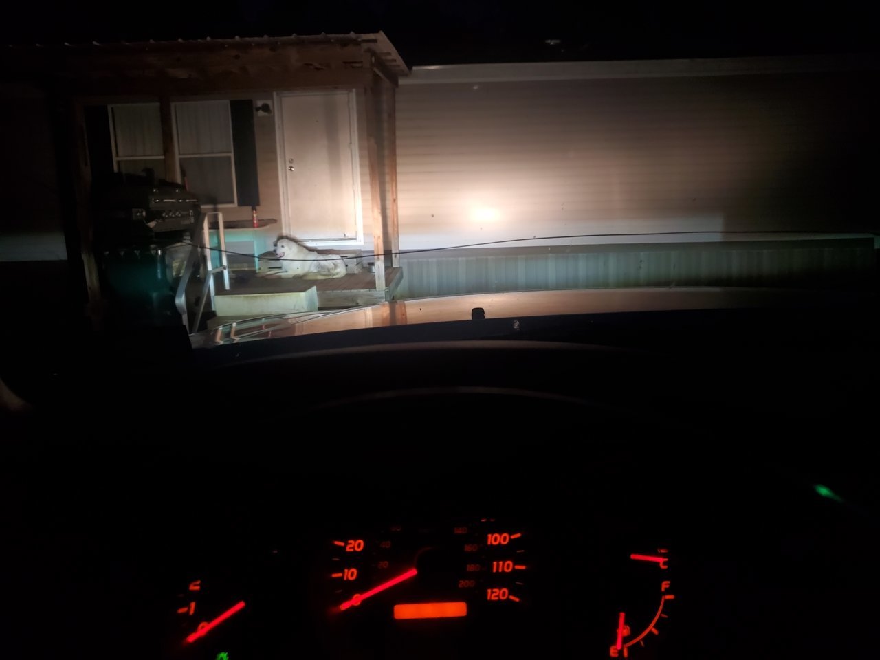

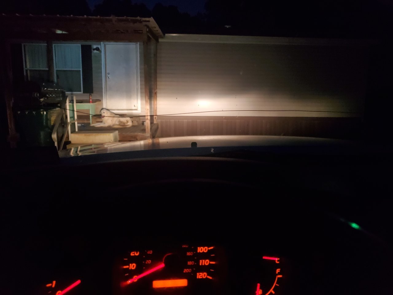

    I bought the offroadtown led pods mentioned here, with a set of @caliraised led brackets, thanks caliraised for the awesome brackets! Perfect fit, easy to install. Great cutoff line on these pods.
    Pictures are with halogen bulbs in headlights:
    LED pods only, pods with low beam, pods with high beam. And low/high for reference.
    Lol, dont mind the dirty ol mutt. She's just been enjoying the mud left by the hurricane.20200830_201641.jpg

    I accidentally looked into those pods once, I couldn't see out of one of my eyes for an hour. So if your dog acted strangely afterward, you know why.
