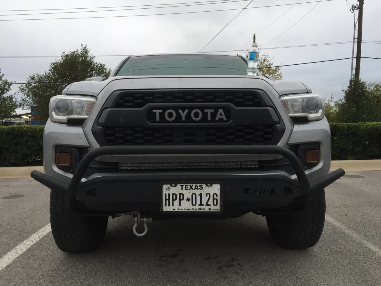

    @crashnburn80 my rigid sae fogs put out very tall beam pattern. They light up overhead signs on freeway. The pattern I get from them is also pretty narrow. Is that normal? And if not, could you guide me to correcting it somehow?

    Do you have a picture of them installed?

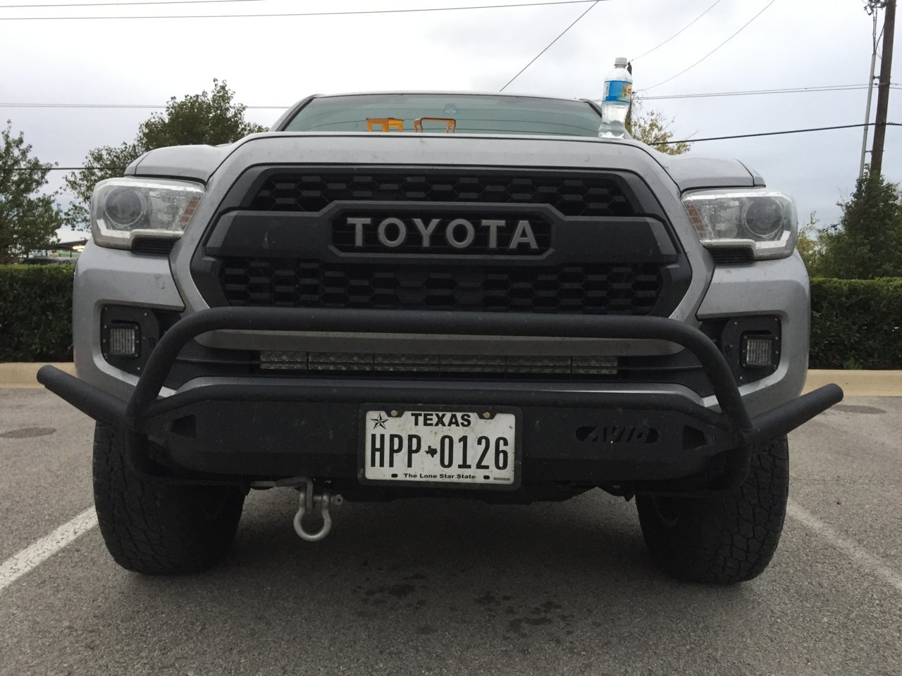

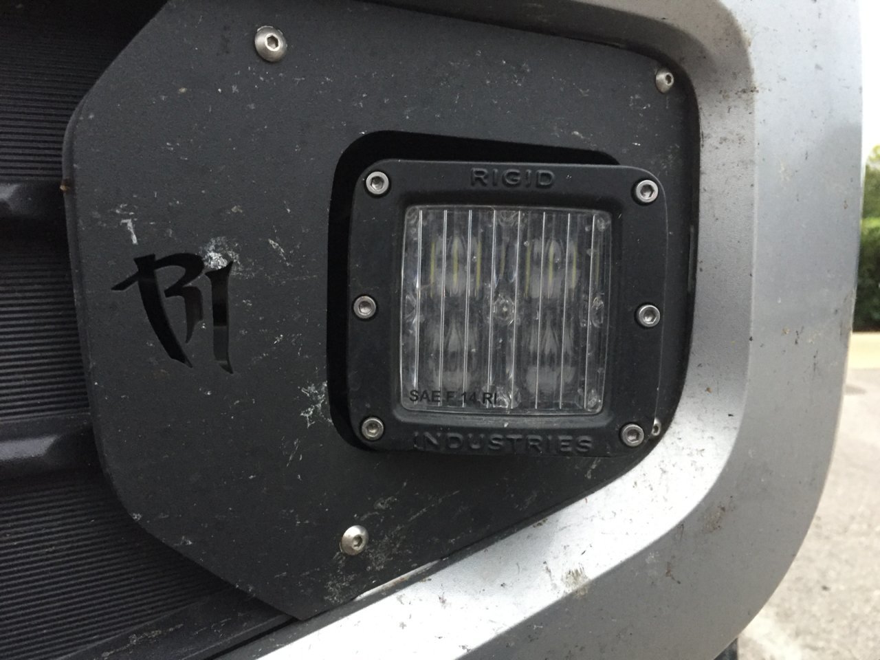

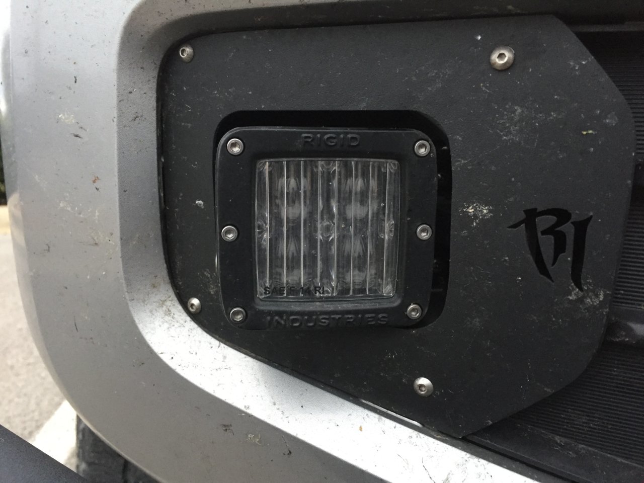

    C04E9707-0B42-4306-9931-810E190AEE79.jpg 44FC4BA5-D991-4D3A-AE3A-81B7C6259B2C.jpg 15B8BE25-282C-4E79-965F-220E75A18CEC.jpg C842A192-38AE-4711-BC47-EF0FA612DC86.jpg

    Looks right, installed just like mine. Weird you have a tall beam and not a wide beam.

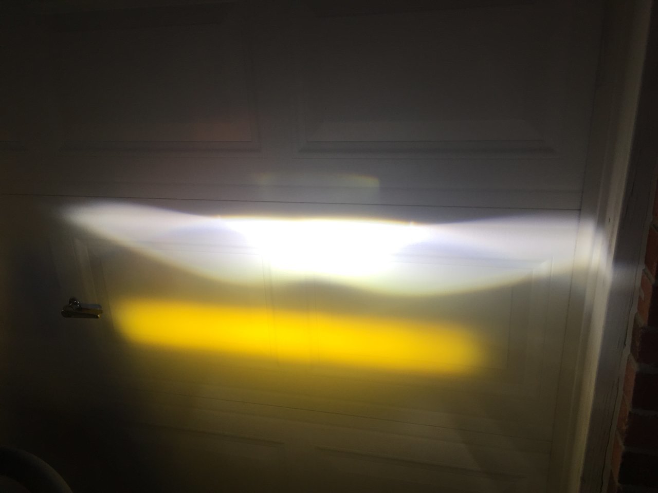

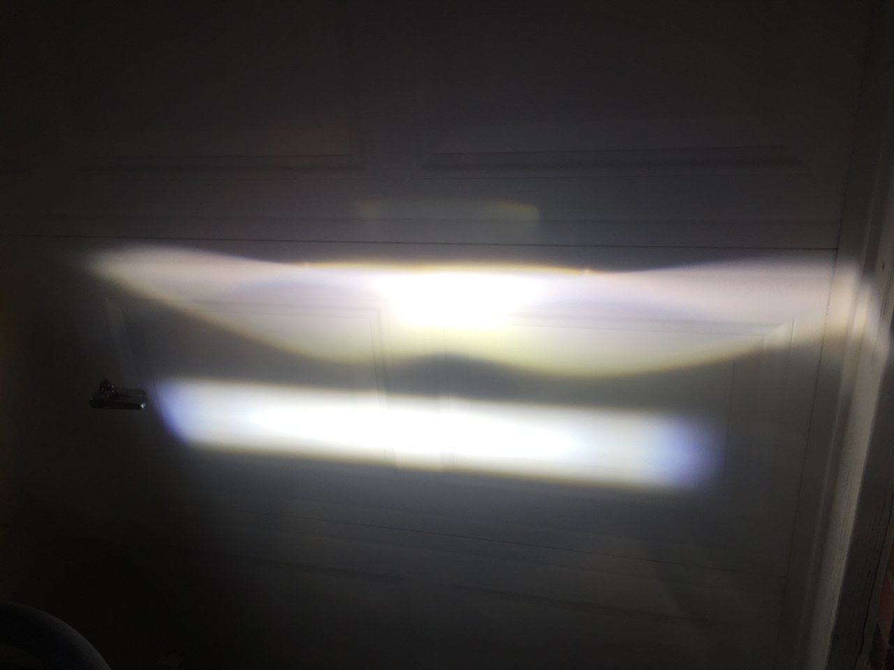

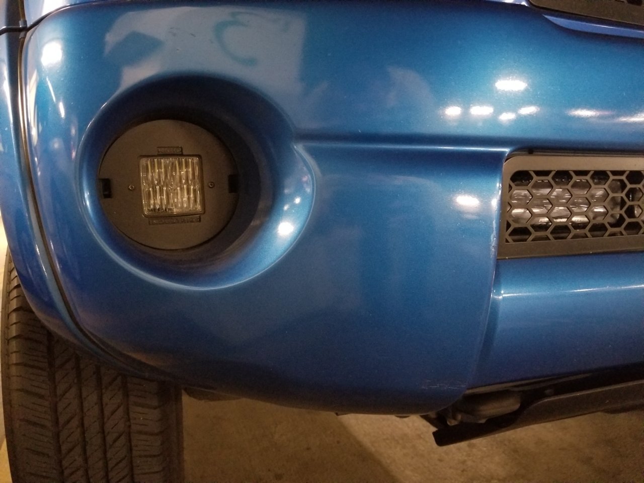

    Looks similar enough to yours. Notice how headlight has more spread than fogs, which makes no sense.
    These are both pics of just one headlight and one fog light, with and without cover.
    E1056B2B-72E9-41E5-9AC9-DCBD1E22CA5F.jpg A63ACE94-433B-47AD-B08A-1AEB05B05B21.jpg

    Based upon that picture I would say the rigids are doing what they are supposed to. Your headlights however appear to have some light that angles up on each side. My bet is that what's causing the signs to light up. Stock headlights? Mine have that because they are crappy depo aftermarket lights that i had.

    No, I am sure the fogs do the lighting up. I have checked with fogs on and off. The beam looks very tight up close, but if I back away from wall, it is actually very tall. They act like high beams.
    The headlights are stock, with decent cutoff. They are aimed a little too low actually, so the fogs actually illuminate farther out.
