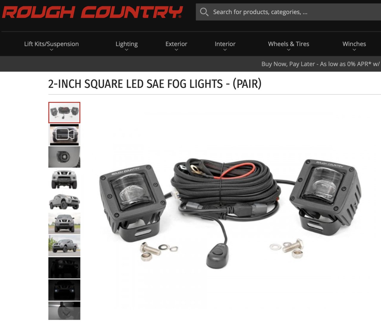

    LOL I definitely wouldn't buy a Rough Country suspension product. Just interesting they had rebranded a light already tested in this thread.
