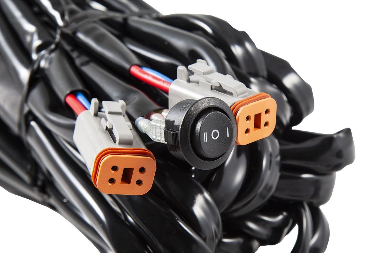

    Do you have a picture of the three way switch?

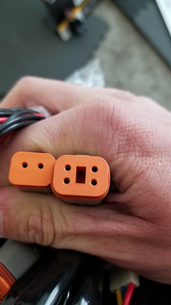

    The SS3 and many other lamps uses a Deutsch DT connector with two pins. The C2 uses a 4-pin connector. You would need to either purchase an adapter, or splice the included 4-pin to the harness to get a 4-pin output on it. Then, yes, you'd have only two wires, so you'd lose the backlight feature. It would work just fine to power the main light though!

    The SSC2 has different pin positioning and a slightly larger plug. Just no dice all around, unfortunately.

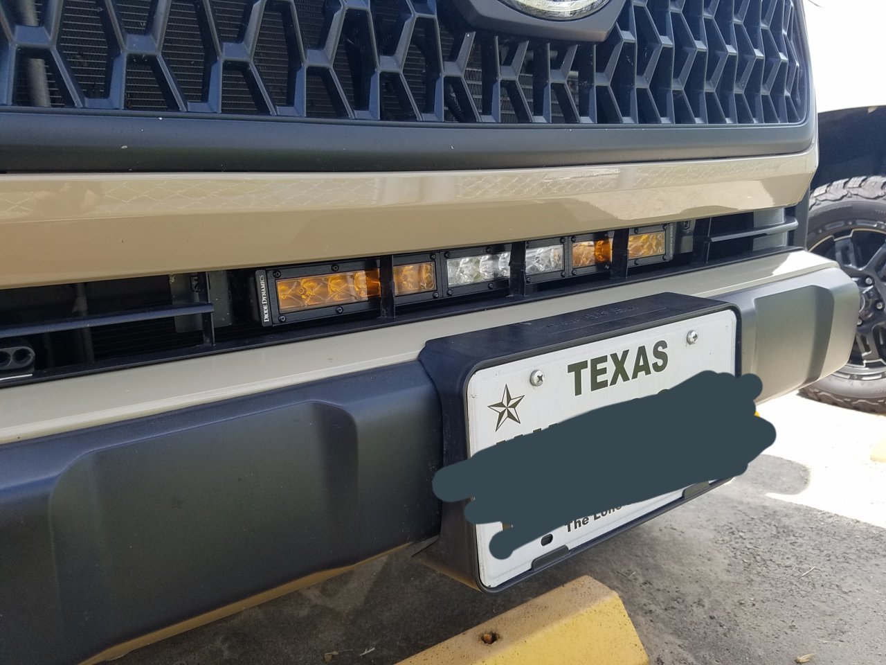

    So i figured this would be a good place to share this little light "hack". As yall know its hard to find a place to mount the ss3 pods to use as driving lights on the 3rd gen. I will eventually get some though and do the lens swap for that 4000k color. Originally I bought the diode dynamics 18in bar in white and long story short..i found using a combo of two amber (2000k) and one white (6000k) you get a nice color pretty damn close to the philips h9, which i run in my low and high beams. The lens for the bars are 3 bucks a pop..soo worth it.

    Looks like a good compromise!
