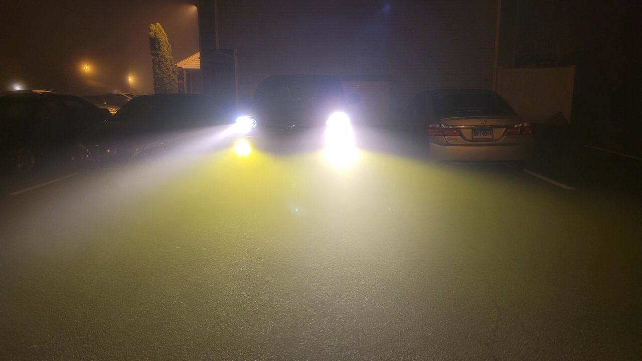

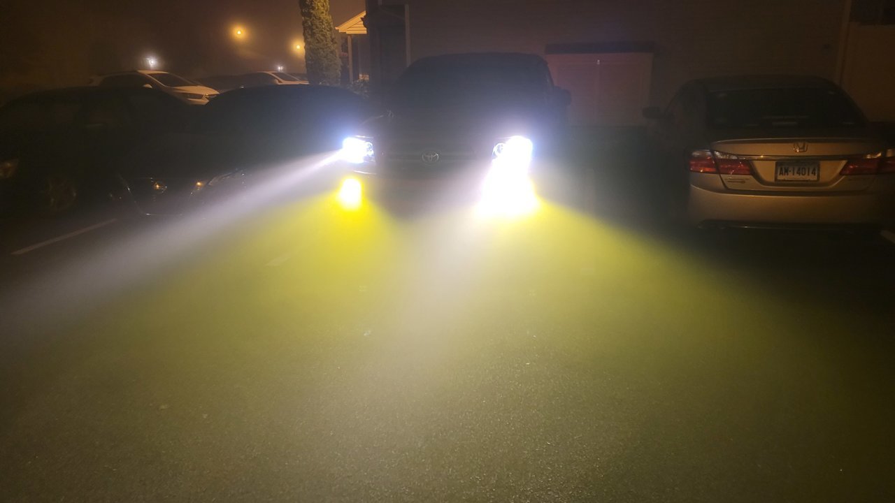

    I finally got to see my SS3 sport fogs performing in the fog since I installed them in the spring. Weird weather this summer. Either way they perform great and looked good doing it to.

    Great picture showing how wide those suckers are.

    And always nice to see somebody with any kind of light properly aimed!

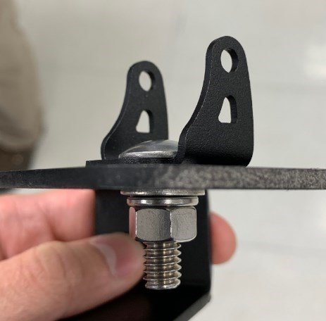

    OK, got some quick answers. The fitment between rectangular slot and the square head of the bolt is intentional, to avoid any possible chance that the carriage bolt would not fit in the bracket. We have to allow for some degree of manufacturing tolerance in sheet metal parts and standard pieces of hardware, especially after considering coatings which can add thickness. The dimension of this allowance is very small, and with the carriage bolt being stainless along with the bracket, there's really no concern about it stripping out.
    For the stackup of the hardware and mounting it in your application, I suppose it depends on what you're trying to mount to. Please see the stackup in the photo below - it is very tight and secure when torqued down, with no play. Perhaps you may just need a slightly larger hole in your mounting surface?
