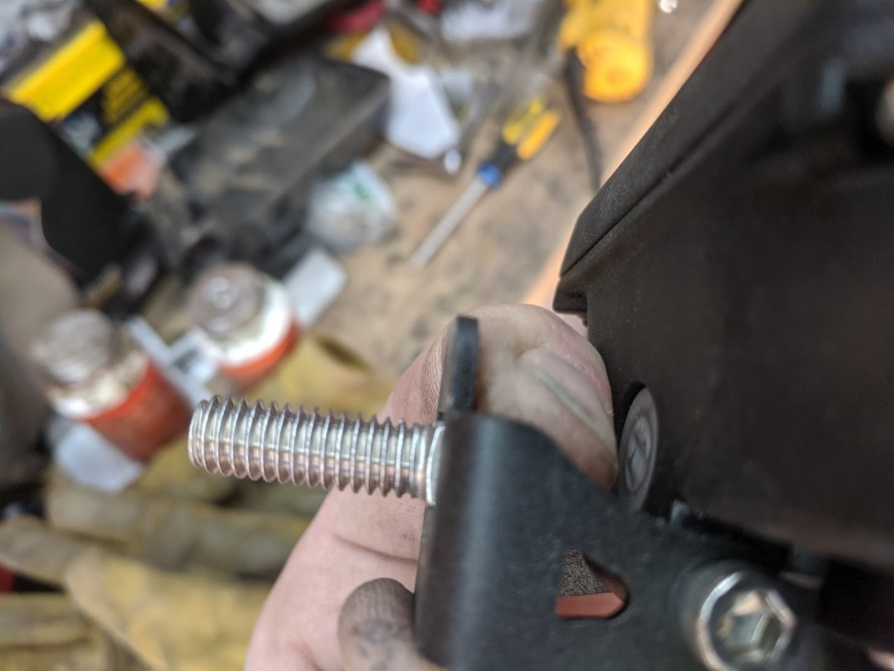

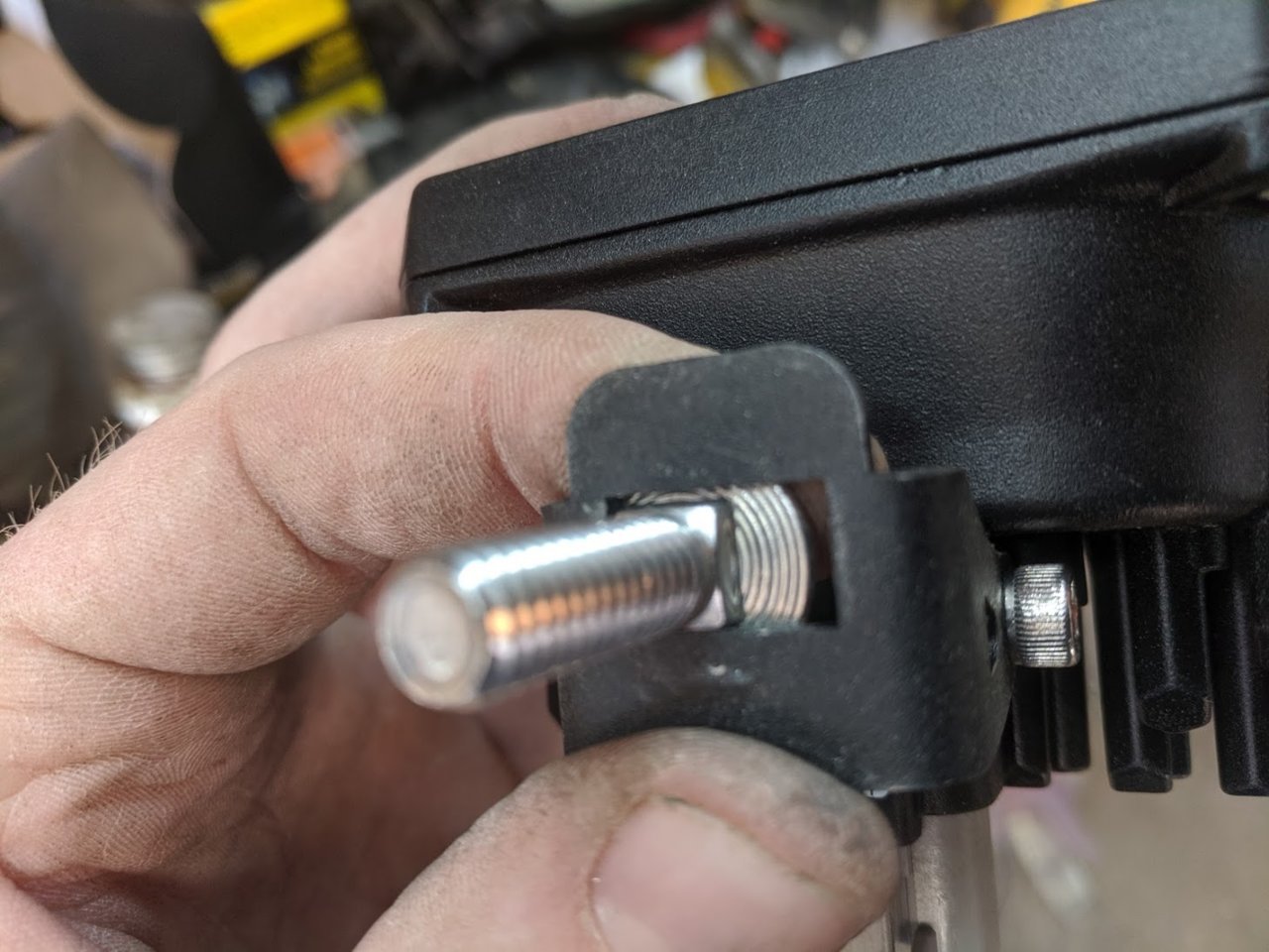

    Yeah i still think that if they just used thicker material for the mounting bracket, it would solved all the issue's.
    @Diode Dynamics

    Understandable suggestion! There are reasons to keep the bracket thinner. From a manufacturing standpoint, it is far more difficult to achieve the 90 degree bend radius on a very small bracket like this when you increase the material thickness. In general, we try to keep the brackets only as thick as necessary, to make them manufacturable, and also avoid extra weight and cost to you.
    There shouldn't be any problems when mounting in a 3/8" hole. We've added that to the mounting instructions to avoid any problems in the future. Sorry for the confusion, and thanks for your support!

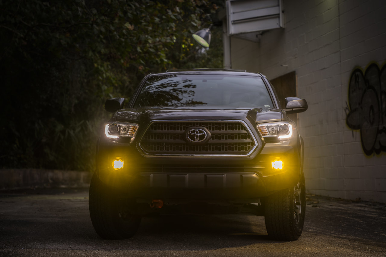

    Can’t wait to install these. Ordered the clear driving and flood lens to enjoy the 4000k goodness.

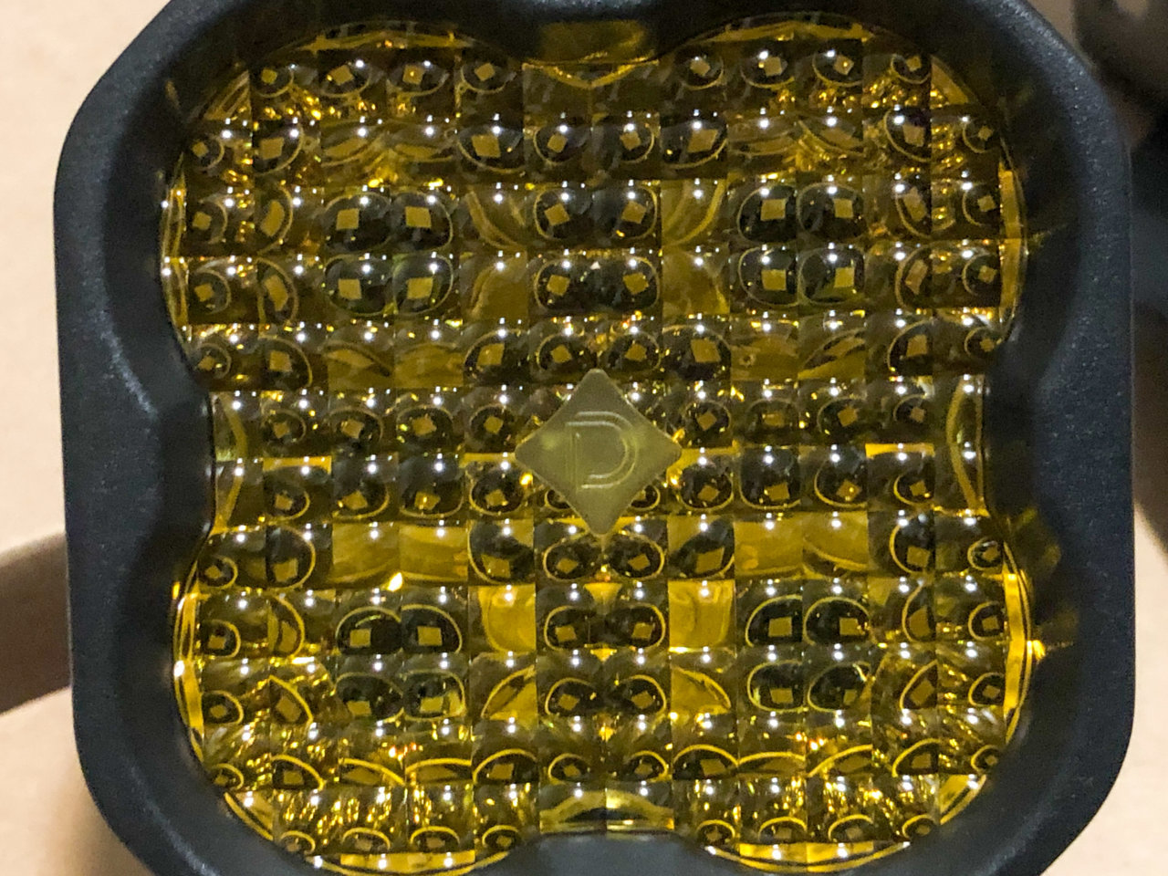

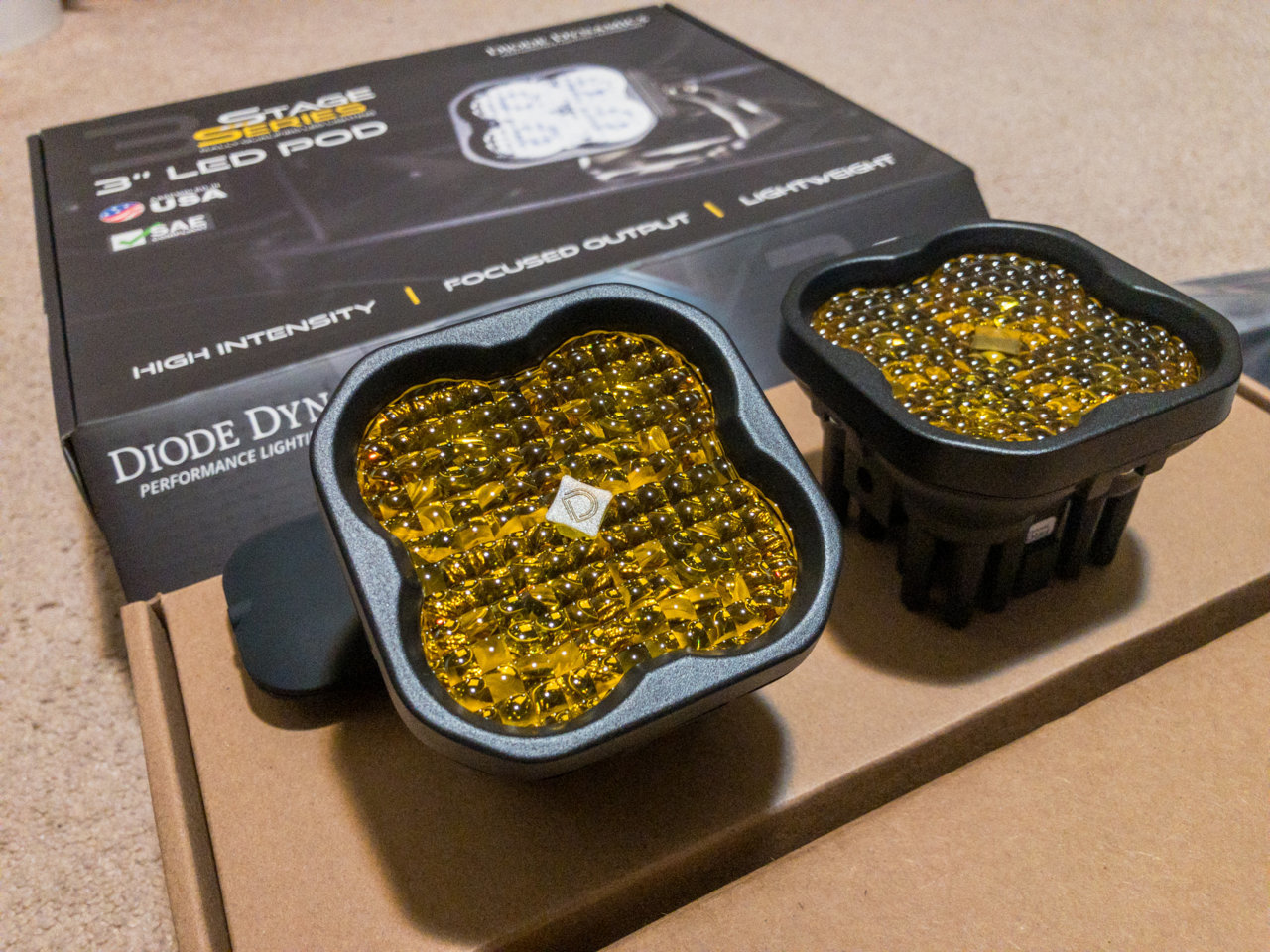

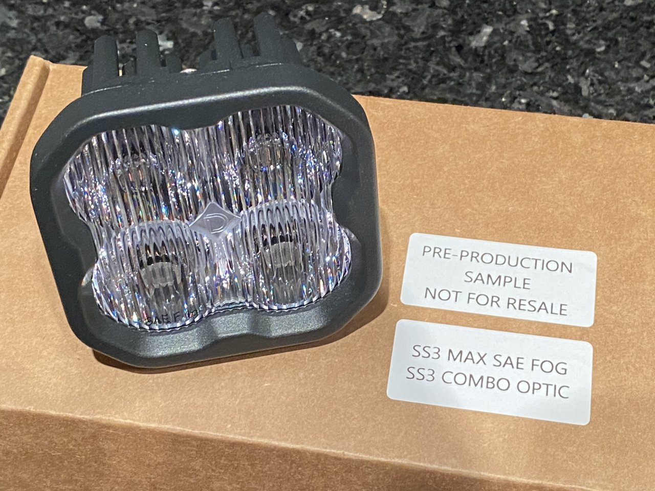

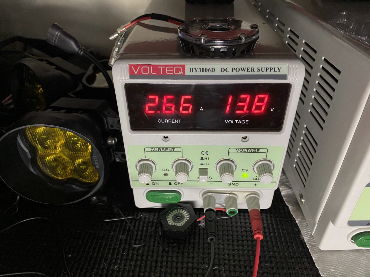

    The Diode Dynamics SS3 Pros are the current highest output intensity fog in this thread, followed closely by the SS3 Sports which provide sharper cut offs than the Pros though lower pattern intensity and slightly smaller area coverage. I currently run the SS3 Pro fogs in selective yellow, and my only significant critique has been I wish the cut offs would be sharper, even though they fall within the legal SAE F-spec compliance requirements. So how do they compare to the new SS3 Max fogs?
    SS3 Pro SAE Fog
    The new SS3 Max SAE Fog

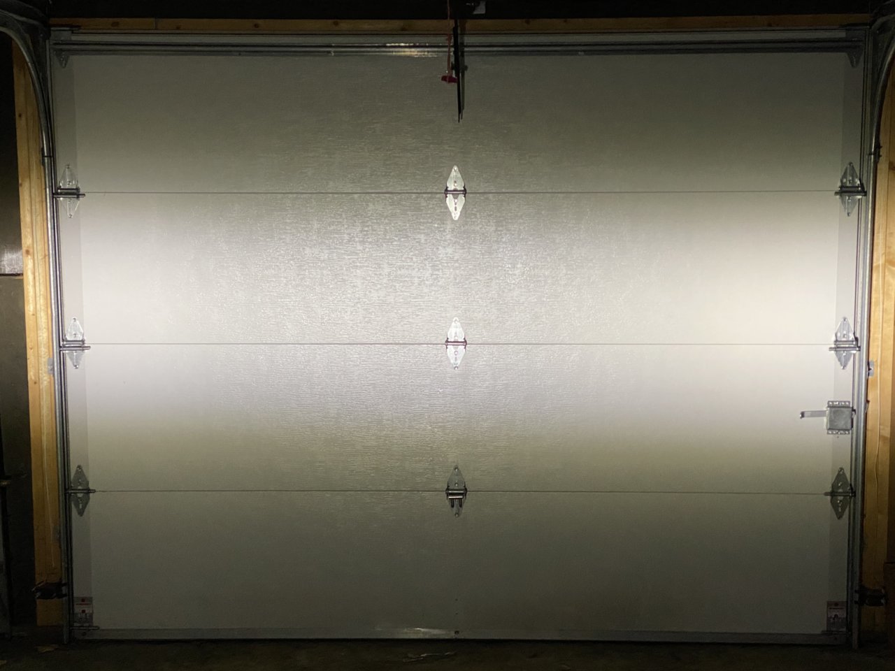

    The new SS3 Max has far better focus and sharper cut offs than the Pro, meaning less glare to oncoming drivers and less reflection off precipitation for better poor weather performance.

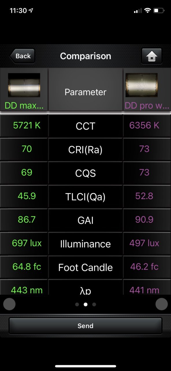

    But what is most interesting, is the +40% output intensity of the Max over the Pro! As shown by the lux measurements below.
    I cannot even begin to emphasize just how ridiculous this product is. The SS3 Pros set a new bar for output performance in the SAE fog segment, and the SS3 Max redefines that with significantly higher output intensity while also providing better cut offs for less glare than the Pros. The Max provides significantly higher output with better beam pattern discipline.

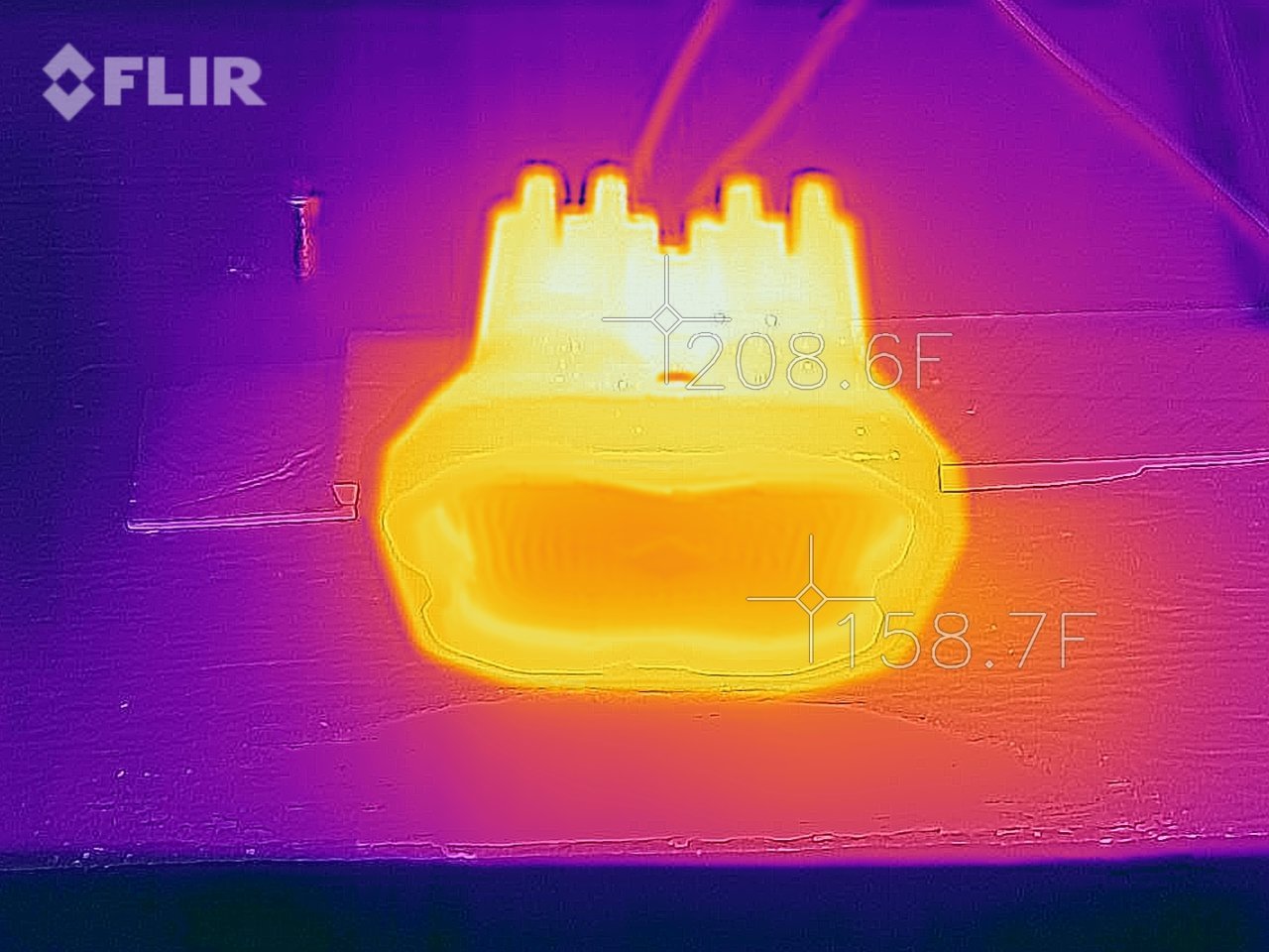

    The SS3 Max is power hungry, but after 30 minutes of run time I have their draw at 36.7w. Power draw initially starts around 40w and drops as the pods heat up.

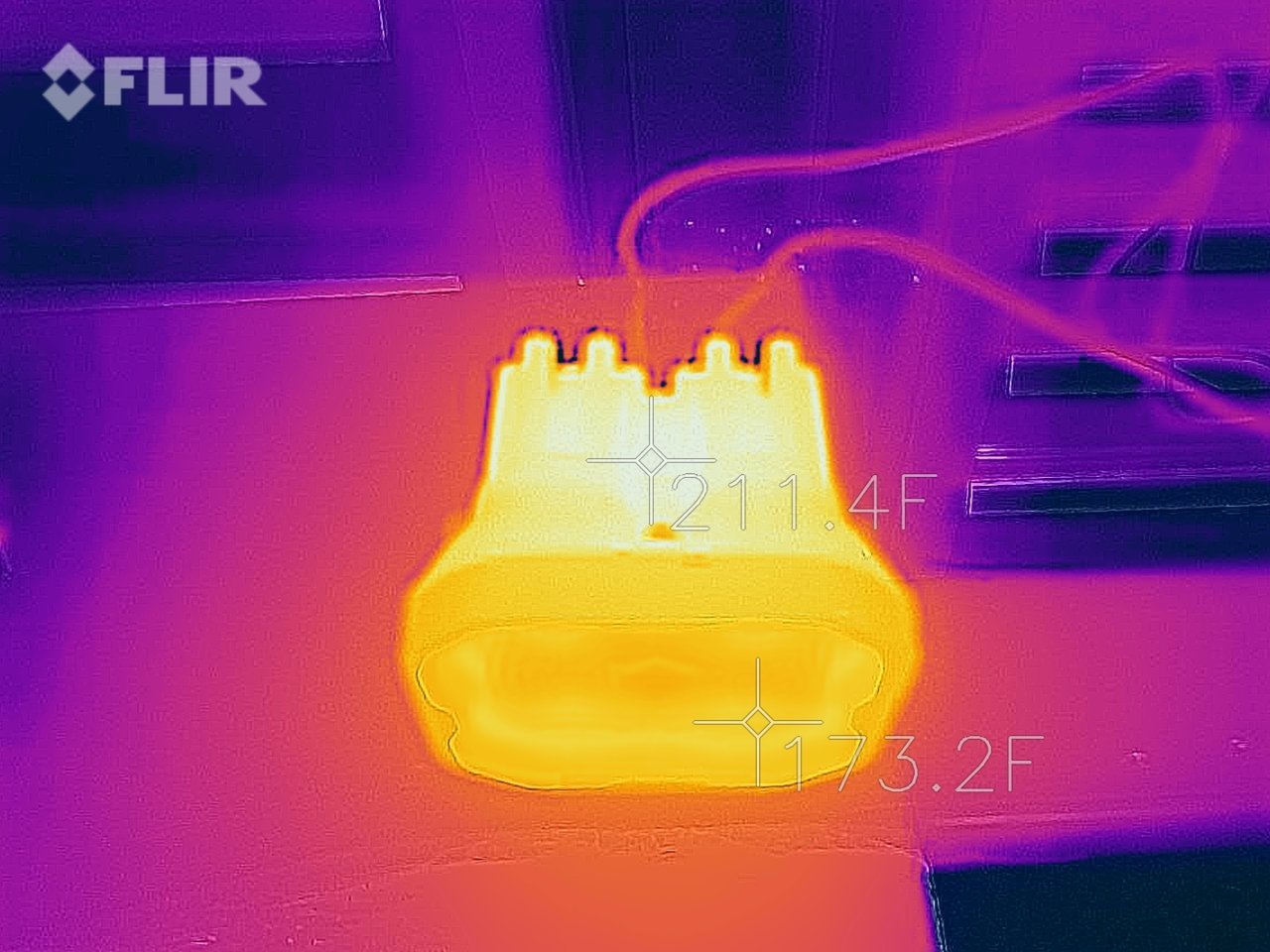

    The SS3 Max runs scorching hot, with body temps approaching 210 degrees and clear lens temps approaching 160 degrees (tested in 60 degrees ambient). Selective yellow optics not available at this time of testing, but selective yellow lens temps would run hotter.
    So power-wise these are only slightly more powerful than the Pros once output is stabilized, why is the output intensity so much higher?

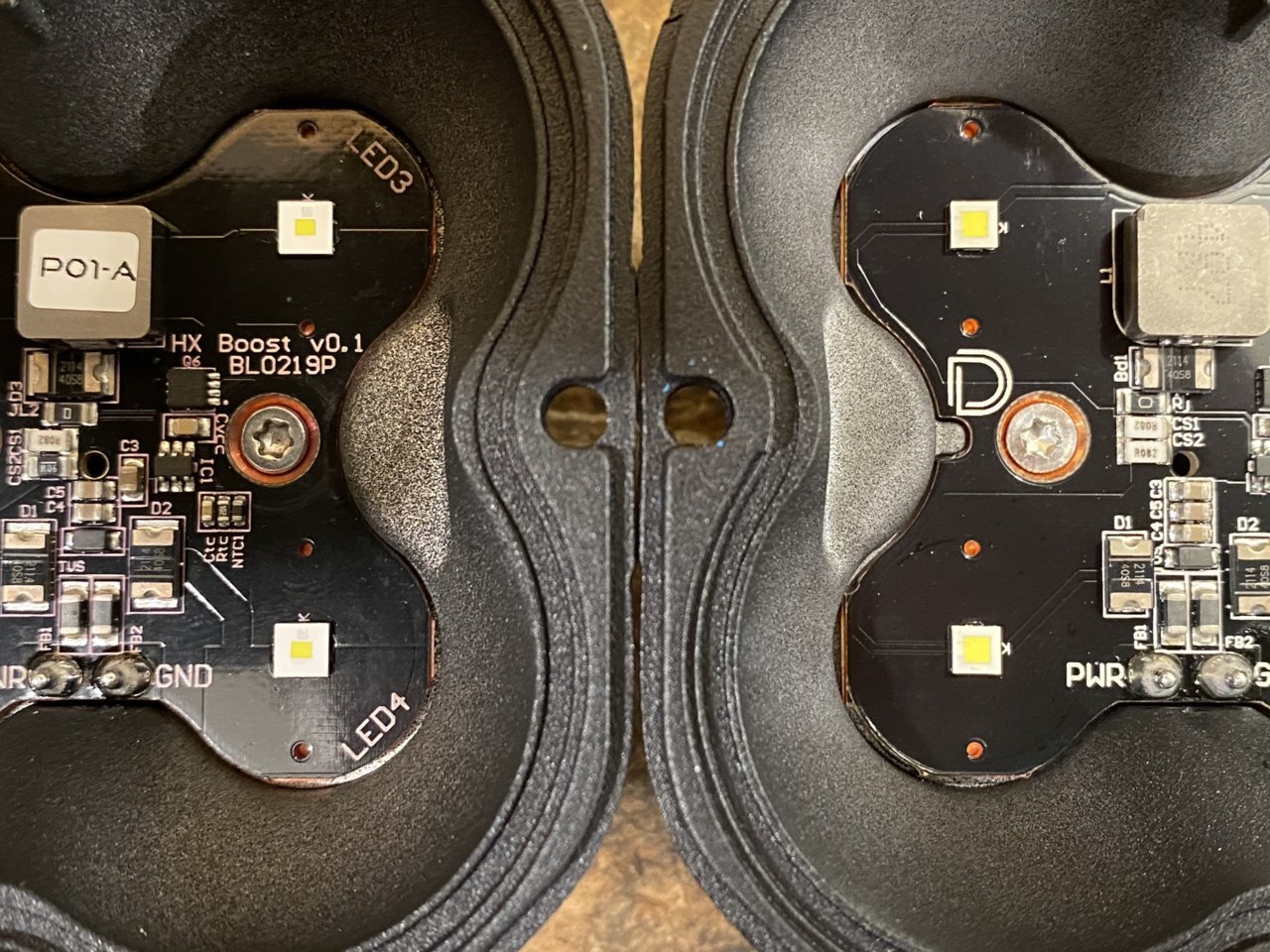

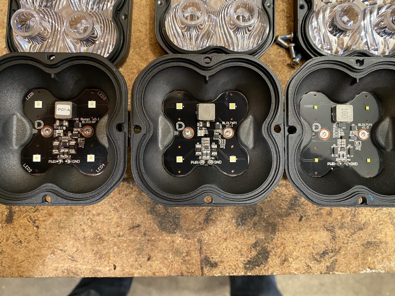

    Recall that in a focused optic a smaller light source provides greater focus and therefore higher output intensity as described by Philips here. In comparing the emitters the Max emitters are smaller than the Pros, providing better focus. The Max also appears to have a revised circuit board.
    Max vs Pro vs Sport
    Closer look at Max vs Pro
    The emitter set used in the Max is currently only available in 6000k, meaning no 4000k option. At this time a selective yellow lens is not yet available for testing (it will need to be darker to correct for 6000k vs 4000k), but should be coming soon. Since the emitters are 6000k heavier filtration losses will be incurred to correct to selective yellow, which will also mean hotter lens temps. While Diode Dynamics has a best in class optic efficiency with their 4000k emitters + selective yellow optics, I'd anticipate a more typical mid-high teens in output loss with a selective yellow optic for 6000k, but with the incredible performance of the Max would still place it light years ahead of the competition.
    It is remarkably impressive for a company to launch a next gen product that completely redefines the standard of what is possible when they already own the top spot in the market and the competition hasn't yet responded in a meaningful way. As an extreme lighting enthusiast I am drawn to products that truly push the limits of what is possible and lately no-one is doing that better than Diode Dynamics.

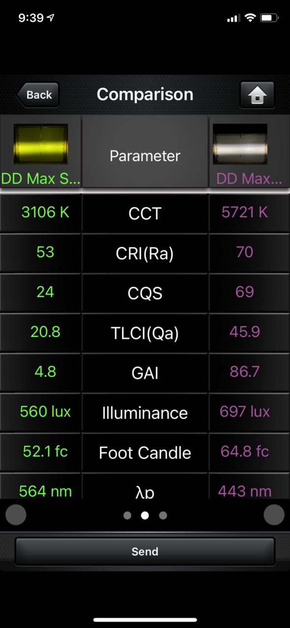

    MAX Selective yellow update below, originally covered in post #4420 here. The max selective yellow optic was not available at the time of initial release, and was later added on 1/25/2021. The review has been copied here for convenience.
    Diode Dynamics SS3 Max Selective Yellow
    This post is imperfect, which I will explain later in the post.

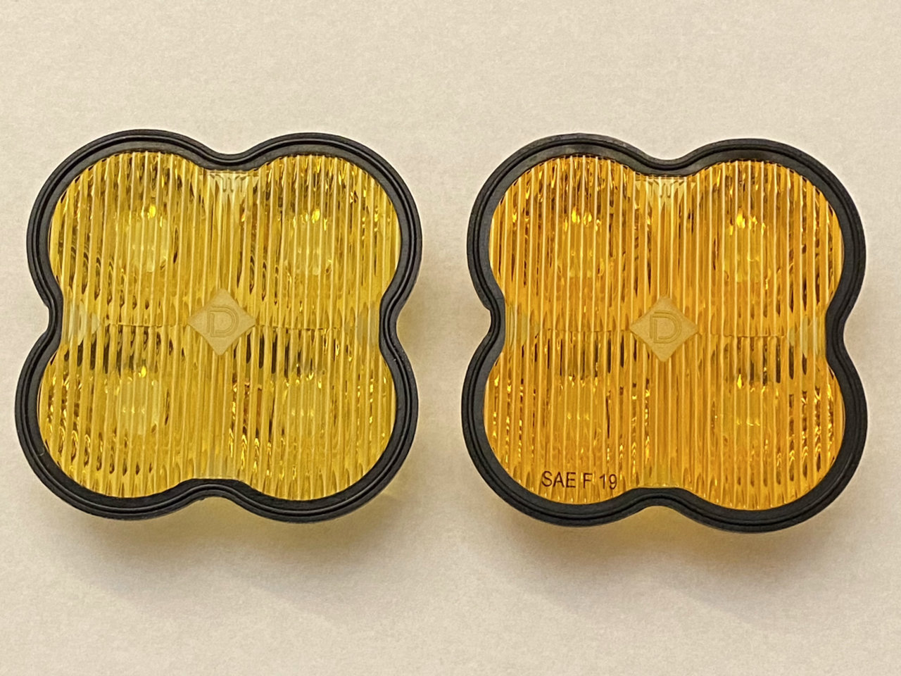

    The selective yellow Max uses 6000k emitters vs the industry best optimized selective yellow Sport/Pro using 4000k emitters with a lighter filtration optic, meaning that the Max will require a darker optic for greater color correction and incur greater losses than the Sport/Pro.
    Sport/Pro (left) vs Max (right)
    Again the Max output has a tighter pattern with better cut offs than the Pros while also providing higher intensity output.

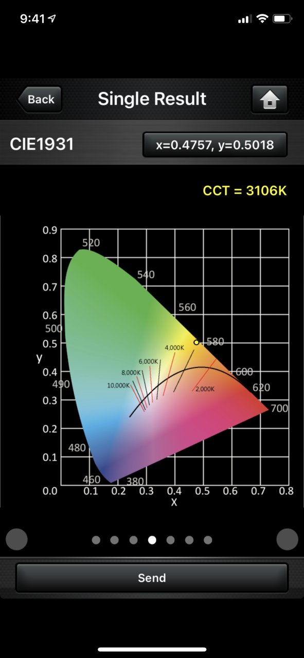

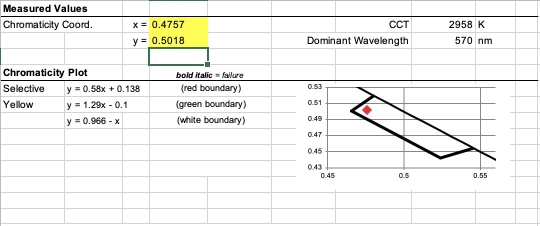

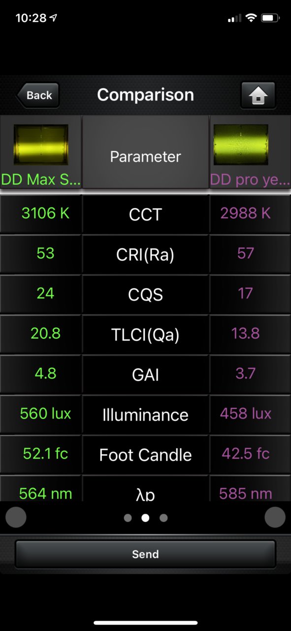

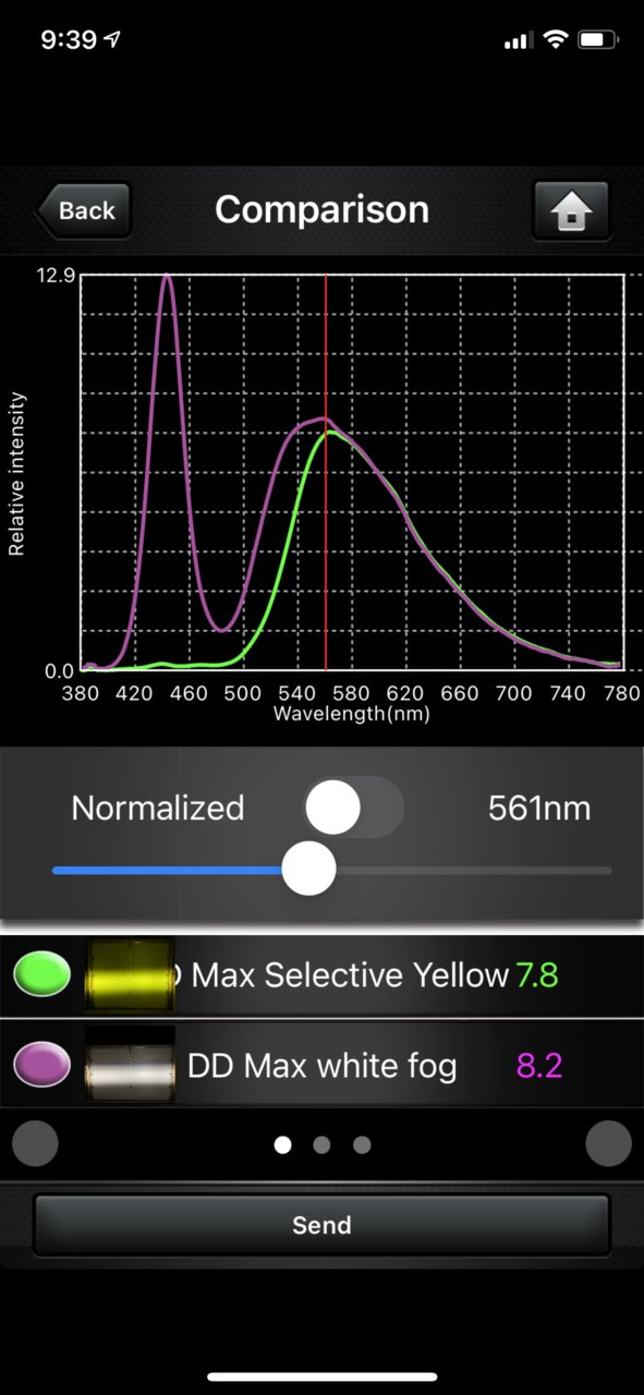

    Correcting a high color temp lamp (6000k) to selective yellow tends to have a more green hue than correcting a low color temp lamp (4000k). Pictured below is the SS3 Sport (top) in selective yellow vs the Max selective yellow (bottom). It is a little difficult to tell in the photo, but the Max has just slightly more green hue. I was actually anticipating more green given the 6000k emitters, so while the color isn't as rich of a yellow as the Sport/Pro, it still exceeded my expectations and came reasonably close to the Sport/Pros.
    The spectrum comparison chart shows the yellow optic eliminates all short wavelength light.
    Comparing the selective yellow Max output values to the white Max, by my numbers the selective yellow Max optic incurs a loss of about 19.7%. This is significantly higher than the ~8% loss of the Sport/Pro selective yellow. To be fair Diode Dynamics has optimized their selective yellow lamps with the Sport/Pro far more than any other company in the industry by using lower color temp emitters paired with lighter filtration optics to provide highly efficient lamps with low losses. So higher losses are expected on the Max with 6000k emitters.
    Selective Yellow Max CCT Plot

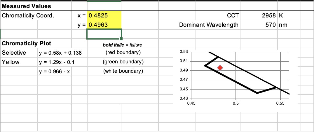

    SS3 Max Selective Yellow Chromaticity window plot. With the 6000k emitters it still falls in the legal selective yellow chromaticity window.
    Vs SS3 Pro Selective Yellow Chromaticity Box
    The Max runs scorching hot, which will excel in snow/icing environments. These selective yellow lamps have the hottest lenses recorded yet, meaning they will be best able to combat icing compared to all other LED fogs. As someone who semi-regularly dives across remote mountain passes at night in the snow, this feature is of significant importance to me. Having your lamps ice over in the conditions for which they are intended to perform is unacceptable, which will not be a problem for the Max selective yellows. Keep in mind the lamps are intended to run at these temps, so there is no cause for alarm.
    How do the numbers compare to the Pros?
    Based on my numbers the Max comes in at about 22% higher output intensity than the Pros with much sharper cut offs, which is better in every regard but maybe not as appealing as the white version.
    But here is where things go a little sideways and why I mention earlier that the data is imperfect. 15-20 minutes had been adequate to get the LED fogs to stable operating output in the past. However, Diode Dynamics Max fogs are so much more powerful that I believe the previously used stabilization period is inadequate, and in retrospect likely applies to the Pro fogs as well. If you were paying close attention, the peak amplitude in the spectrum comparison chart between 500-600nm comparing the Max white and Max selective yellow should likely have been identical, but it is not. So I do believe the Max and possibly Pro stable values are a few percentage points off vs what I have logged. It shouldn't make a difference in the big picture, but as a data driven individual it bothers me.
    The selective yellow Max is the highest performing selective yellow lamp on the market, with better cut offs and higher output intensity than anything else available. However the 6000k white Max offers performance advantages in output intensity over the higher filtration losses experienced by the selective yellow Max.
