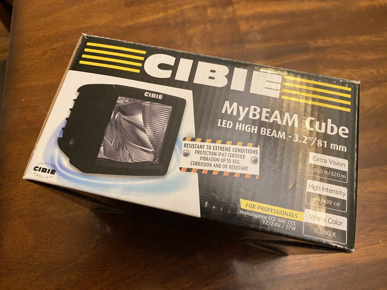

    Is that also a PIAA product? I've seen the Cibie brand, but never found a distributor stateside.
    Edit- and you're still a tease bby

    Time to split this thread into a dedicated J581 version as well.
    They do look identical to the PIAA product, though interestingly the Cibie box lists Valeo for service, so I suspect they are rebranded Valeo products which could be used by multiple brands. One of my issues with PIAA is they don’t publish any performance specs, other than make believe ones.
