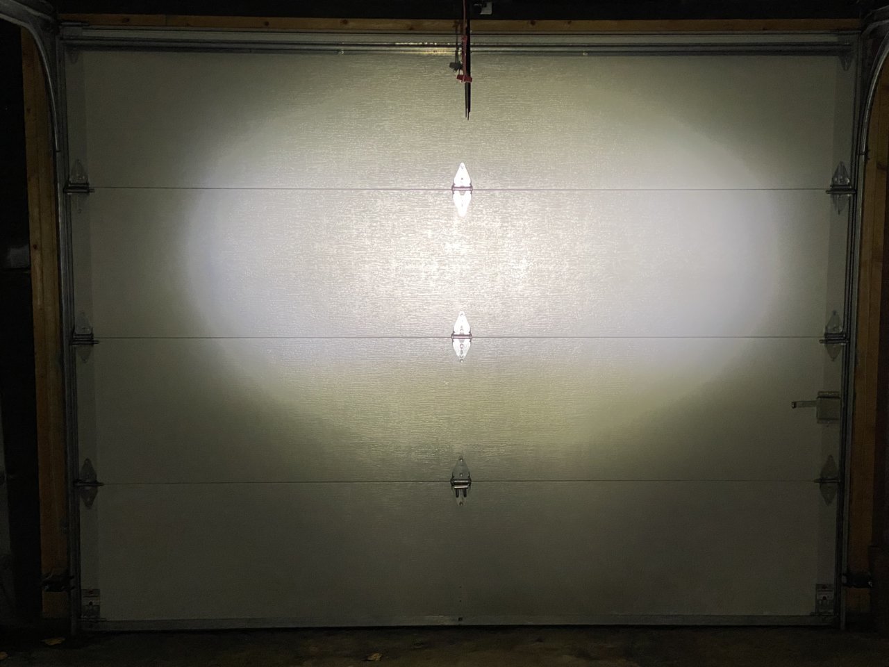

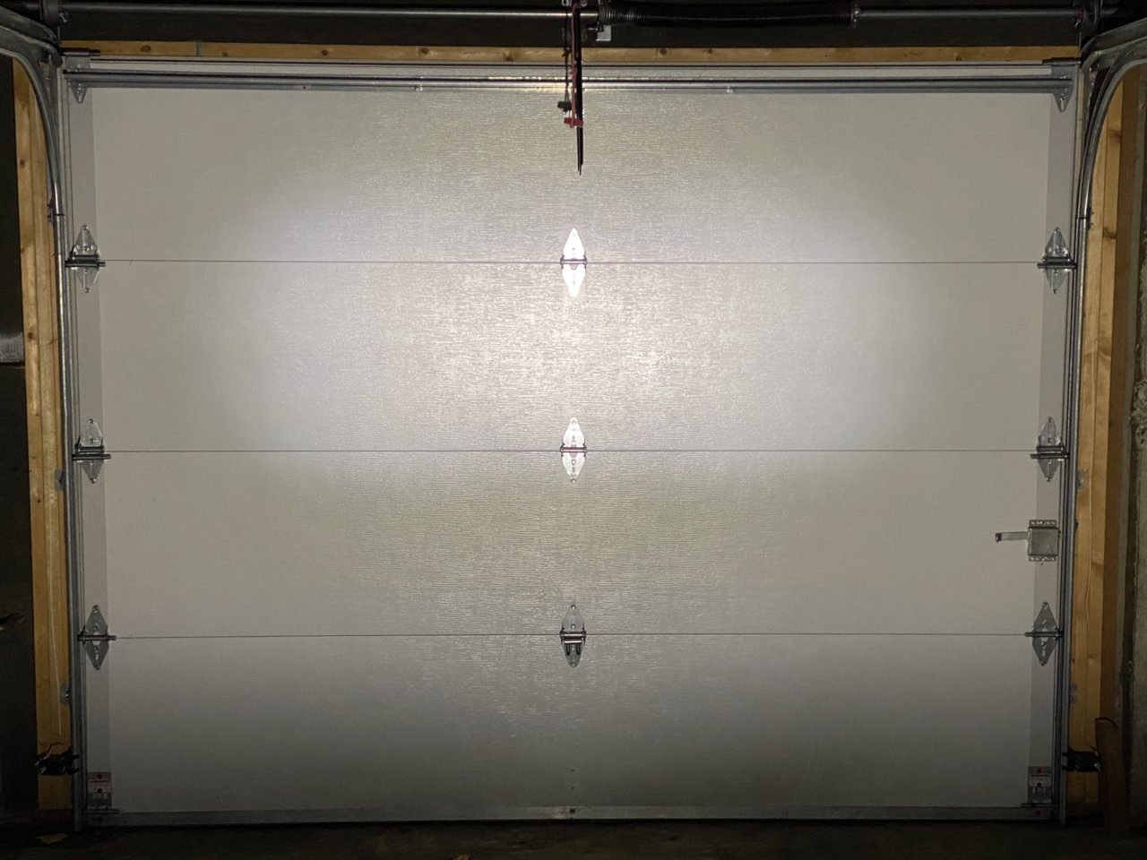

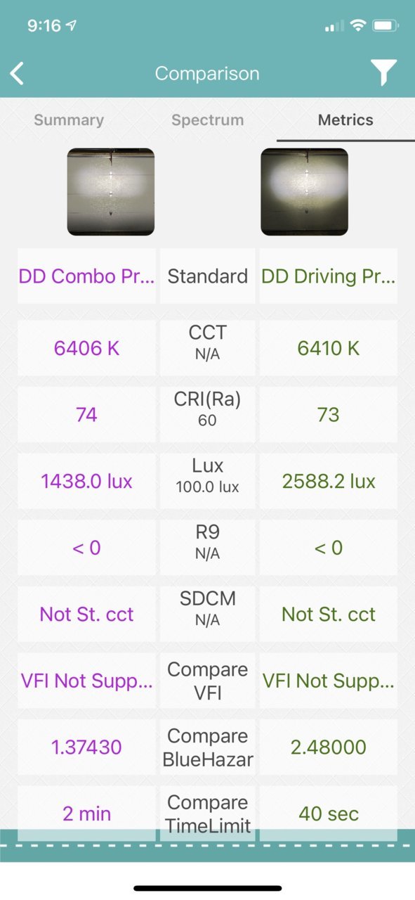

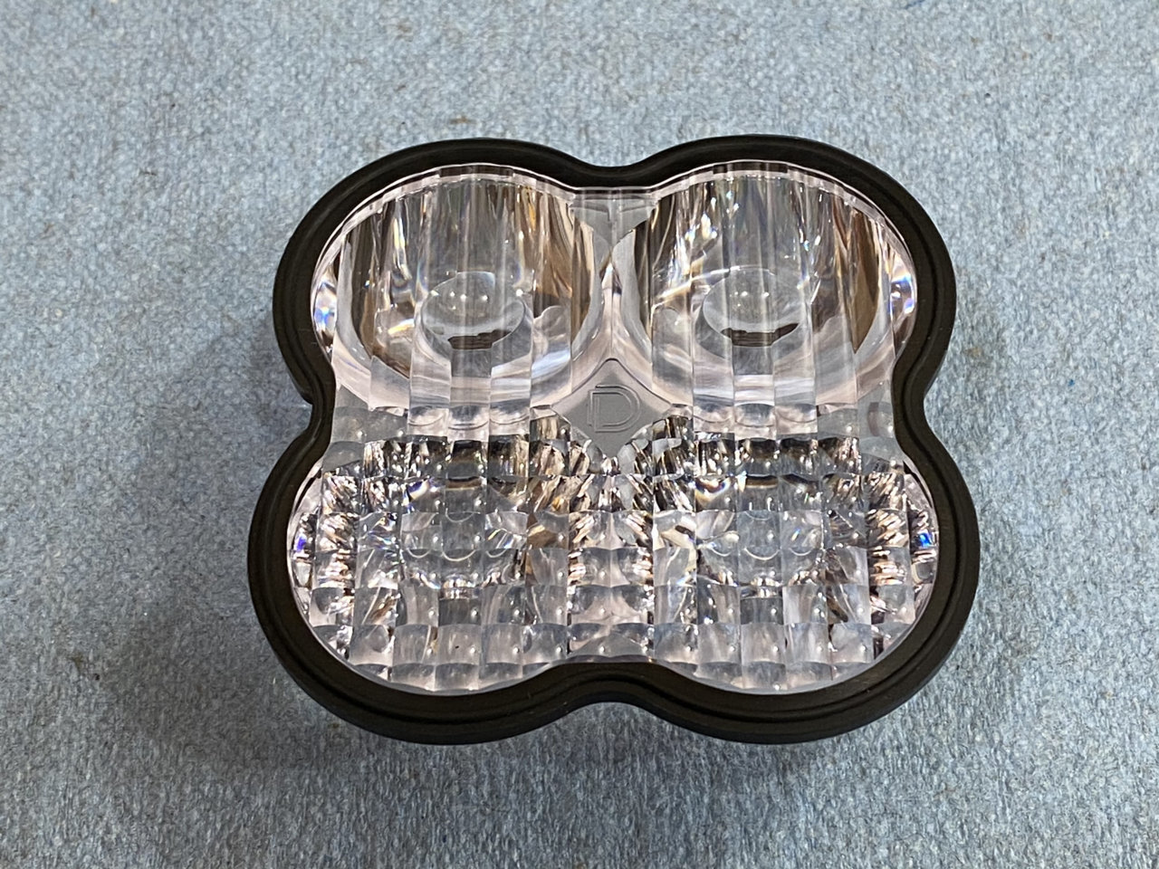

    Not SAE, but here is the SS3 combo which combines half Driving and half Flood, as tested in the Pros. The flood optic will benefit substantially more from the increased output of the Pros vs the increased focus of the Sports. Increased focus with smaller emitters (like the Sport) is primarily beneficial in a focused optic, and a distributed flood optic is the opposite of that. In flood, more lumen output wins over improved focus, so for this optic I would recommend the Pro or the Max.
    The Combo optic
    Trivial in relative placement really, but you want a driving optic to be as high as possible, so it makes sense the driving optic would be on top and the flood on bottom.
    Driving vs Driving & Flood combo
    SAE Driving pattern
    Combo Driving and Flood pattern
    As one would expect the driving hot spot isn't quite as intense in combo and there is a lot more light everywhere else outside of the dedicated driving pattern, with a smoother distributed pattern vs the highly focused driving only pattern.
    So the combo optic takes approximately a 44% loss in peak intensity over a dedicated driving pattern optic, which makes sense since half the pod is now a lower intensity flood pattern. It isn't that less light is being produced, just rather than concentrating it for distance projection vs it being distributed to flood a much larger area at lower intensity. Combo patterns are typically best suited for off road use, where you want to combine a flood light for near field trail illumination with improved far field distance illumination. On the trail at night, or even forest service roads, a broad flood pattern can be beneficial, but for dedicated street use a driving pattern is typically more appropriate.
