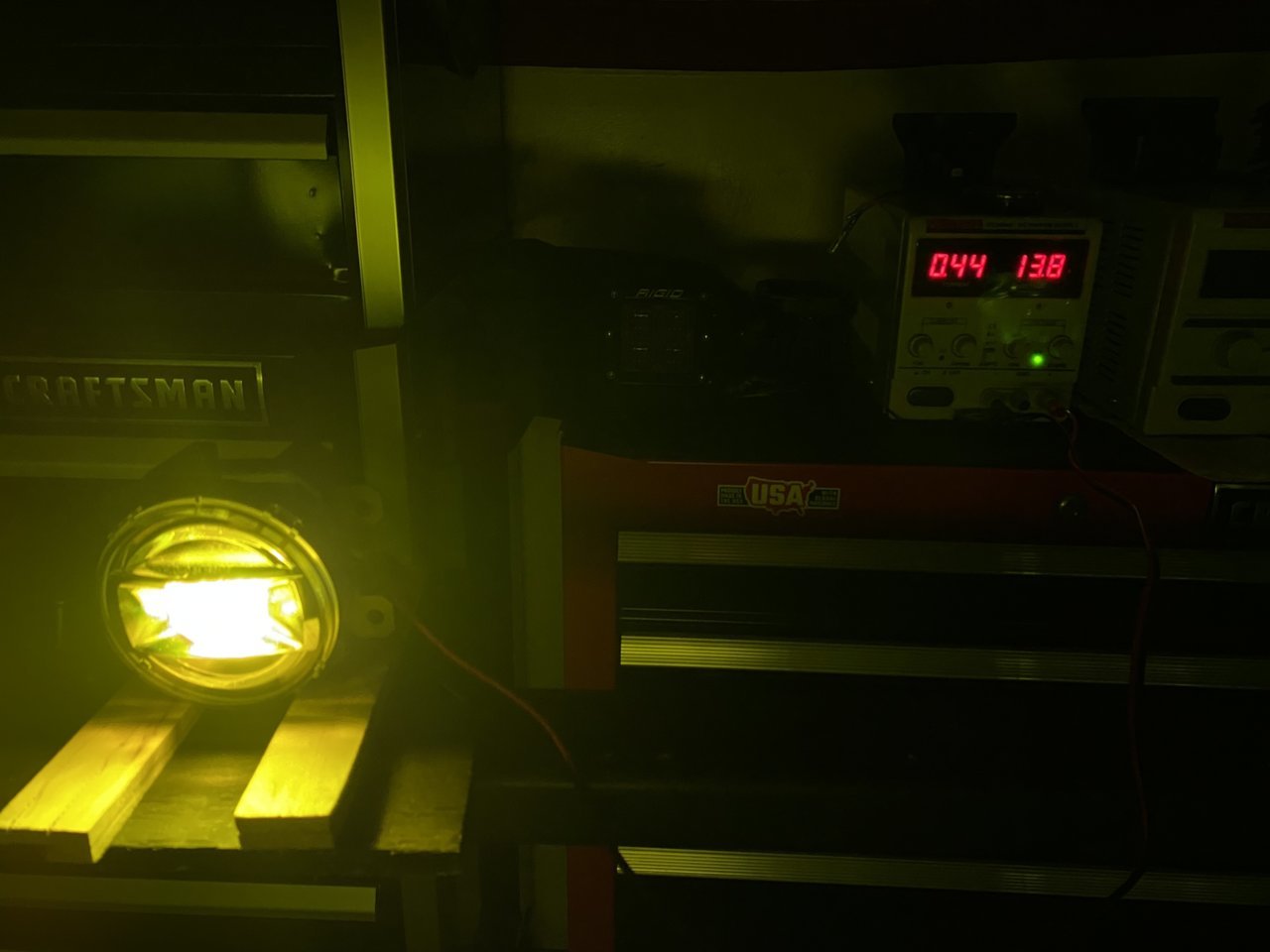

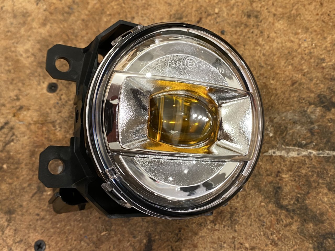

    A while back I experimented with running Subaru fogs in my Tacoma, which were a direct swappable replacement and offered some advantages over the OEM Tacoma fogs. However, these Japanese Subaru fogs (part #H4517FL011) are for 2015+ WRX and do not fit the Tacoma platform. But I figured I'd share the data anyway.
    The fogs are a selective yellow F3 spec fog, similar in design to the Valeo OEM Toyota LED fogs, though unfortunately Toyota does not offer a selective yellow version.
    As typical with this style fog, the cut off is extremely sharp, and the pattern is nicely uniform with a very wide angle of projection (not shown in the photo).
    After 15 minutes of run time to reach a stable operating temp, the fogs pull about 6.1w.

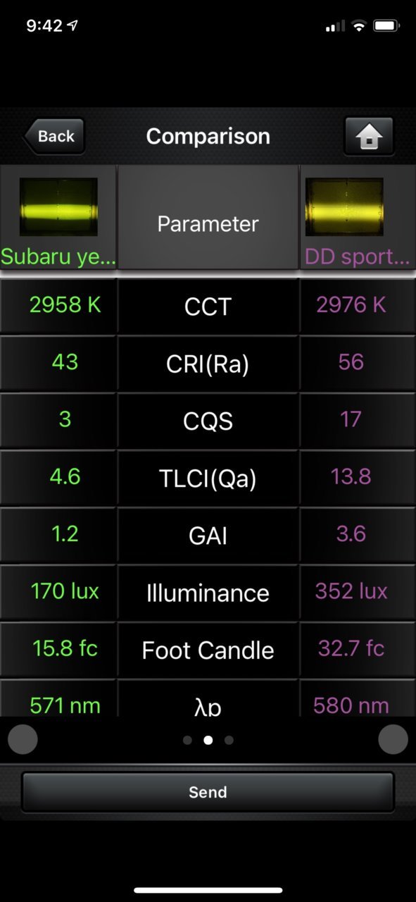

    The fogs do have a greener hue than say that of the Diode Dynamics Sport fogs, which are also an F3 spec fog. The dark yellow projector optic of the Subaru fogs would imply they are running 6000k emitters. Due to the low power draw of this lamp, the front lens barely gets warm meaning it will provide insufficient heat to combat icing in snowy conditions.

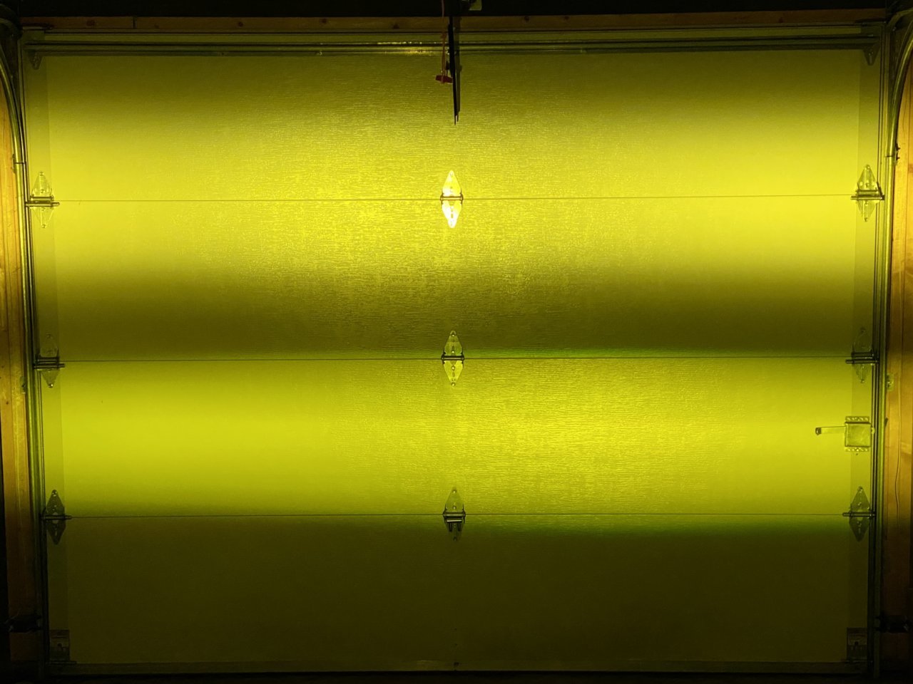

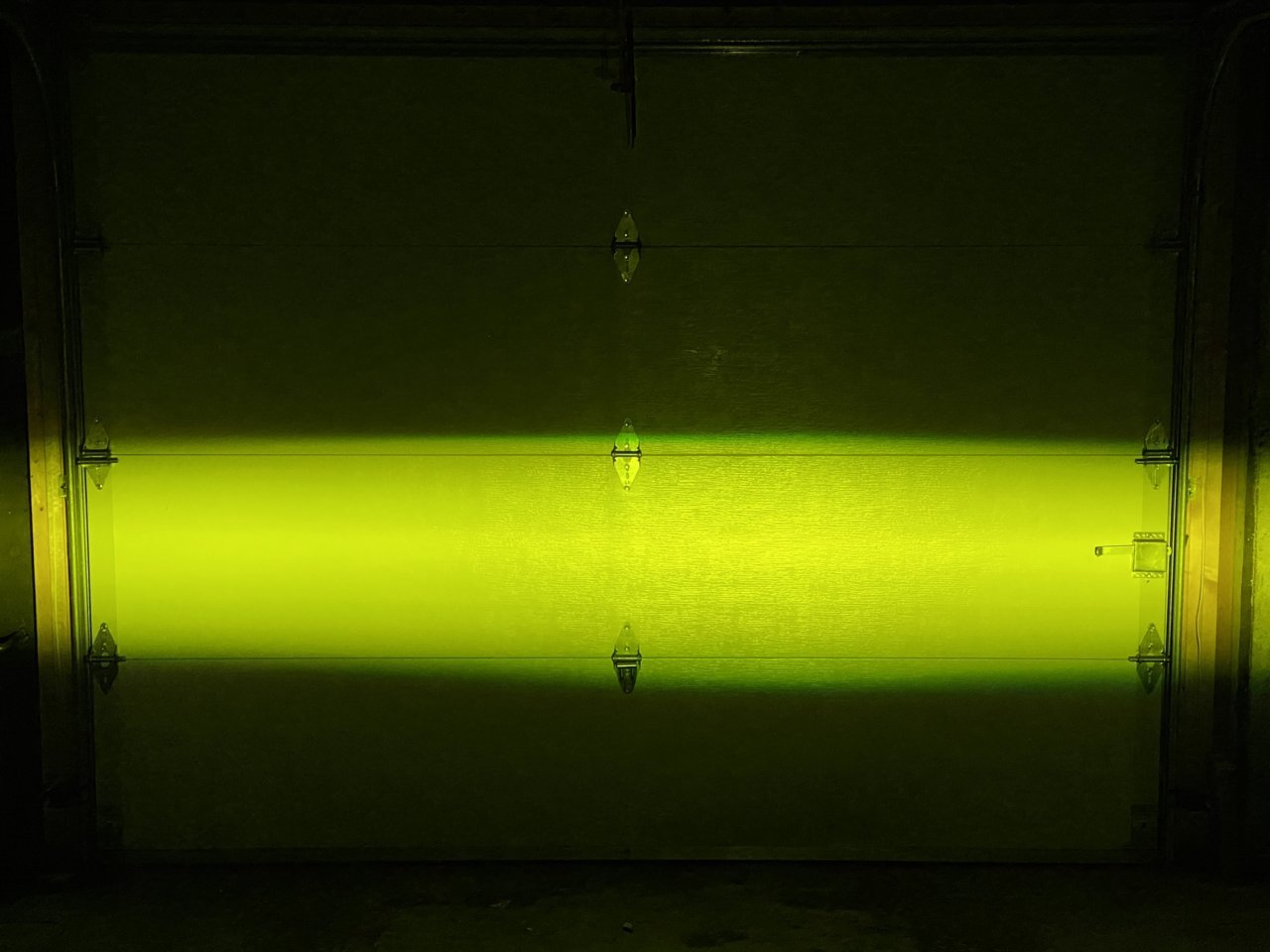

    Output as measured at 18'. Subaru F3 fogs vs Diode Dynamics SS3 Sport F3 fogs
    The SS3s come in at over 2x the intensity.
    Diode Dynamics SS3 Sport fog (top) vs Subaru fog Bottom
    The projector cut offs of the Subaru fog provide much sharper cut offs than the Diode Dynamics Sport fogs. The photo doesn't do the best representation of color, but the SS3 is a bit more yellow vs the Subaru unit more green. I did verify the Subaru fog does fall into the SAE selective yellow chromaticity window.
    Based on my measurements and some basic math, these look to have a beam pattern of 69 degrees wide by 6.6 degrees tall.

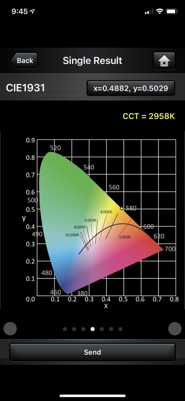

    Subaru fog chromaticity plot
