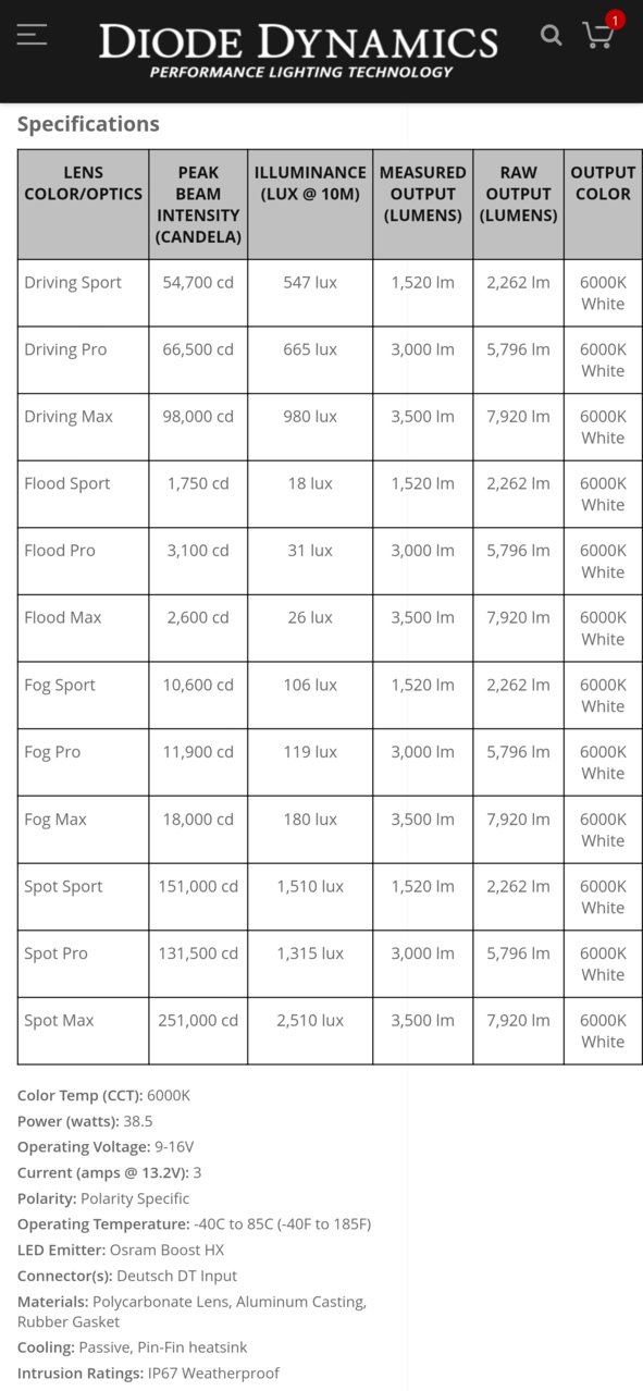

    Moving along... It's interesting to see that the Max improves every optic except for the flood, where the Pro edges it out. Yellow specs are not yet released.

    That is interesting isn’t it. The key benefit of the Max is using a smaller emitter for improved focus, with slightly improved output over the Pro. Improved focus only helps in focused optics, aka Spot, Driving, Fog. Going to a distributed pattern like flood makes sense that output intensity wouldn’t play into the Max’s strength of increased focus. Still surprising to see the Pro come out on top for flood.

    What surprises me is to see the candela and lux numbers for the sport in the spot configuration. Are those number correct? Is the spot really better than the pros?

    For Spot, in peak intensity yes. I think I have a post in here somewhere comparing the two. Because Spot is an extremely focused optic, and the Sport emitters are smaller and more highly focused than the Pro, the smaller light source works with the highly focused optic to produce a more focused spot beam, resulting in higher intensity output. However, the Sport spot is a smaller spot pattern than the Pros, so there is a trade off.
    While this article by Philips talks about how shrinking the light source improves focus and therefore increases output intensity in focused halogens, as shown by the Tungsram products in the 3rd Gen headlight thread, the same concepts apply to smaller more focused LEDs:
    https://www.philips.co.uk/c-e/au/ca...es/technology/improve-your-lights-easily.html

    Also a good example though of how just looking at lumens doesn't make sense either. Candela will give you a far better idea of peak pattern performance, but it also isn't the full picture without the pattern comparison. Similar to how the Pros are only a little higher in peak intensity vs the Sports in fogs, but the pattern is also much larger on the Pro which isn't something noticeable in the performance specs unless looking at the beam pattern angles.
