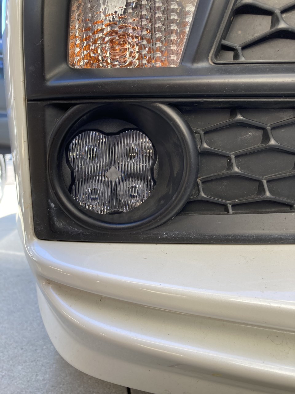

    Yep, I was thinking the yellow would get hotter. Just wanted to dispel the theory that we might need oven mitts (for clears at least). I touched both lens and black outer ring which I think is metal and connected to the body.

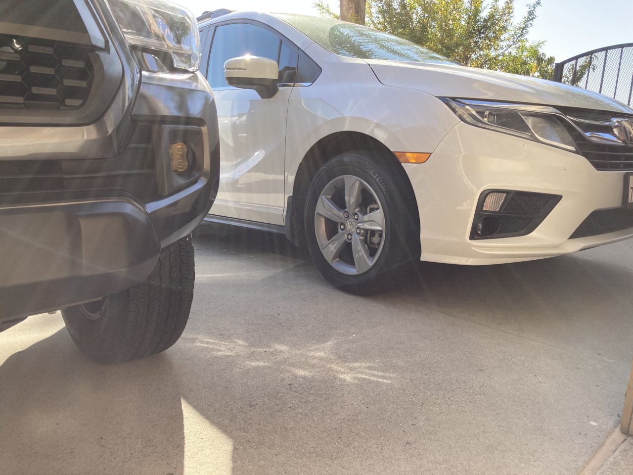

    It may simply be that the brackets provided aren’t workable on a 2018 Odyssey. DD states they are compatible with 2019+ but the model year redesign was 2018 and I found another person who had done the same thing so it seemed possible. Indeed the mounting holes line up perfectly so they are securely mounted. The brackets permit some level of adjustment but I had to push the pods as far back in the bracket as possible to clear the obstructions in front since the OEM fog lights are a little smaller. As a result, pivoting up/down is limited.
    With all that said, and noting this location has a slight incline, I can't help but be surprised at how the light spill extends all the way to the roofline. It’s not excessive in volume but it’s noticeable. I really wish I had a shot without the headlights on. I might just go back tonight or somewhere safe and unplug the halogens to get some photos with just the fog lights.
    @Diode Dynamics out of curiosity, is there any possibility of a modified bracket with another few mm of depth for fog placement? That could be a longer arm with same size slot or a larger slot. There is plenty of room behind the light inside the bumper. I might be able to accomplish this myself with a dremel.
    I’ll see if I can get a few more pictures tonight. Perhaps I’ll back both vehicles up and get a side by side on my garage doors. I intended to do that last night but the install took longer than I had budgeted and I was zzzzz

    Another point worth mentioning is that the Honda sits way lower than the Tacoma. So the lighting is just different.

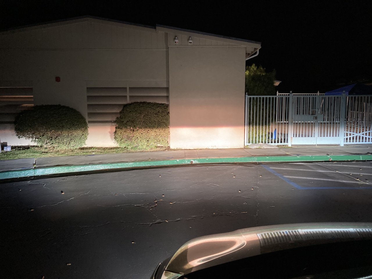

    Foggy night a few days ago. H9 low beams and SS3 pro fogs, plus 4000K pro driving lights. Love that color... Not sure I'll like the Max yellow as much, trying to resist spending more money!

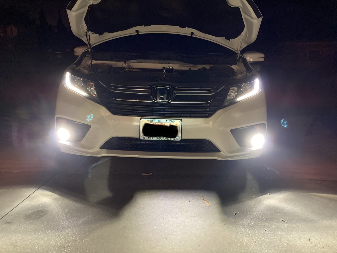

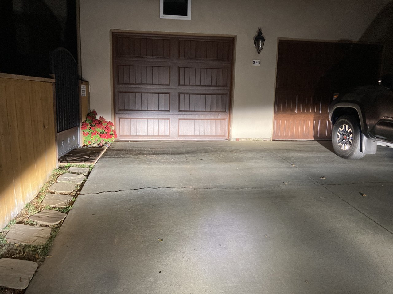

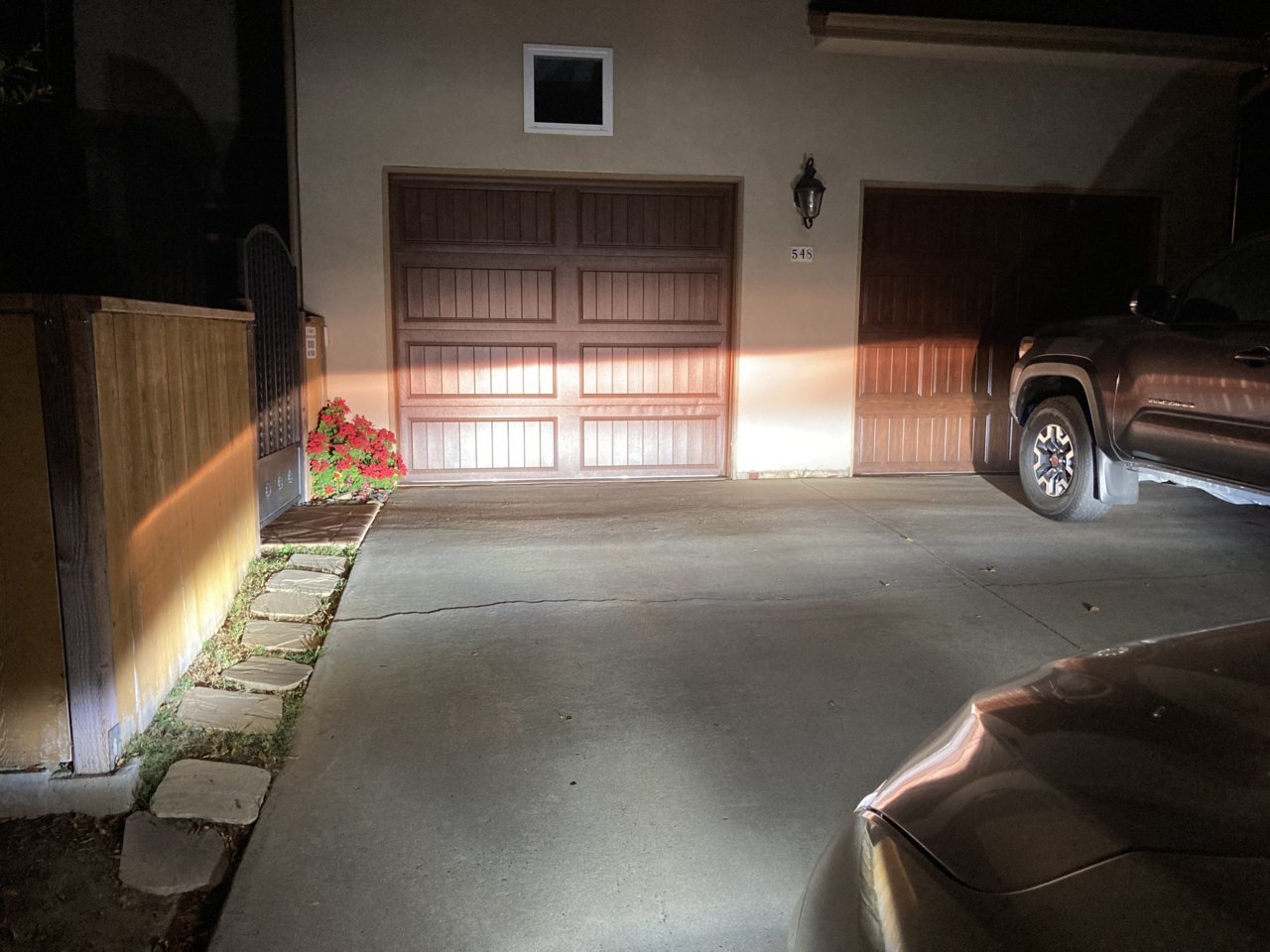

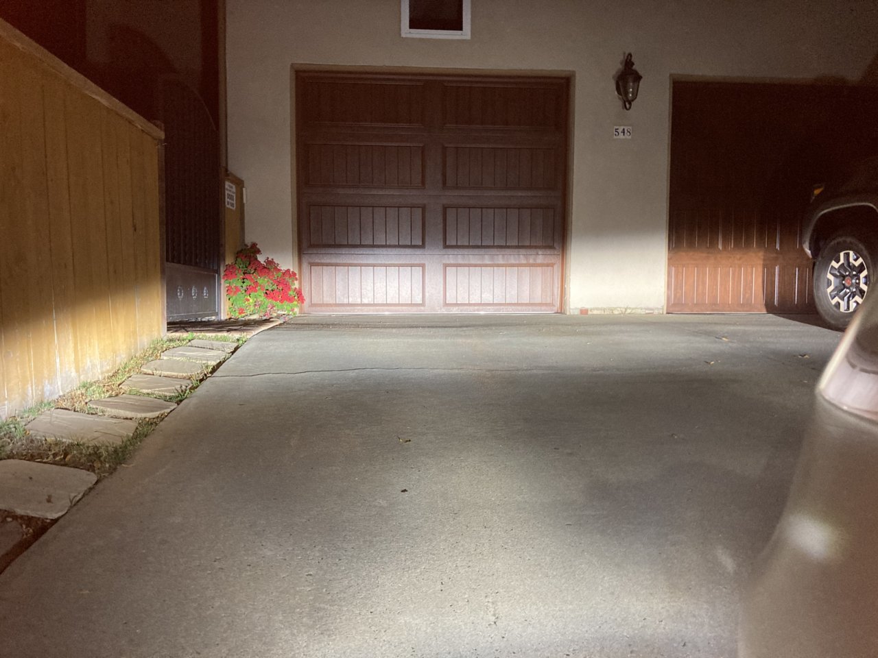

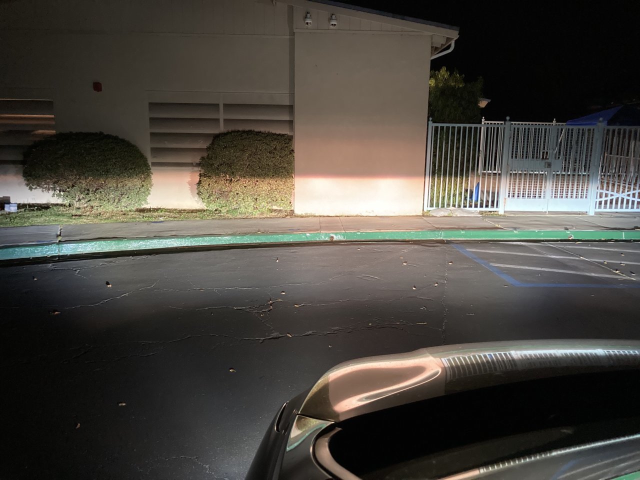

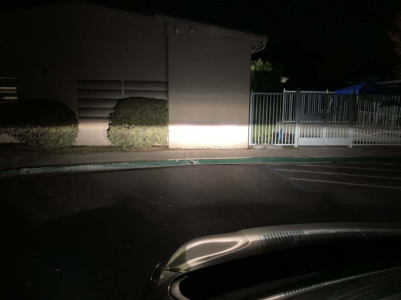

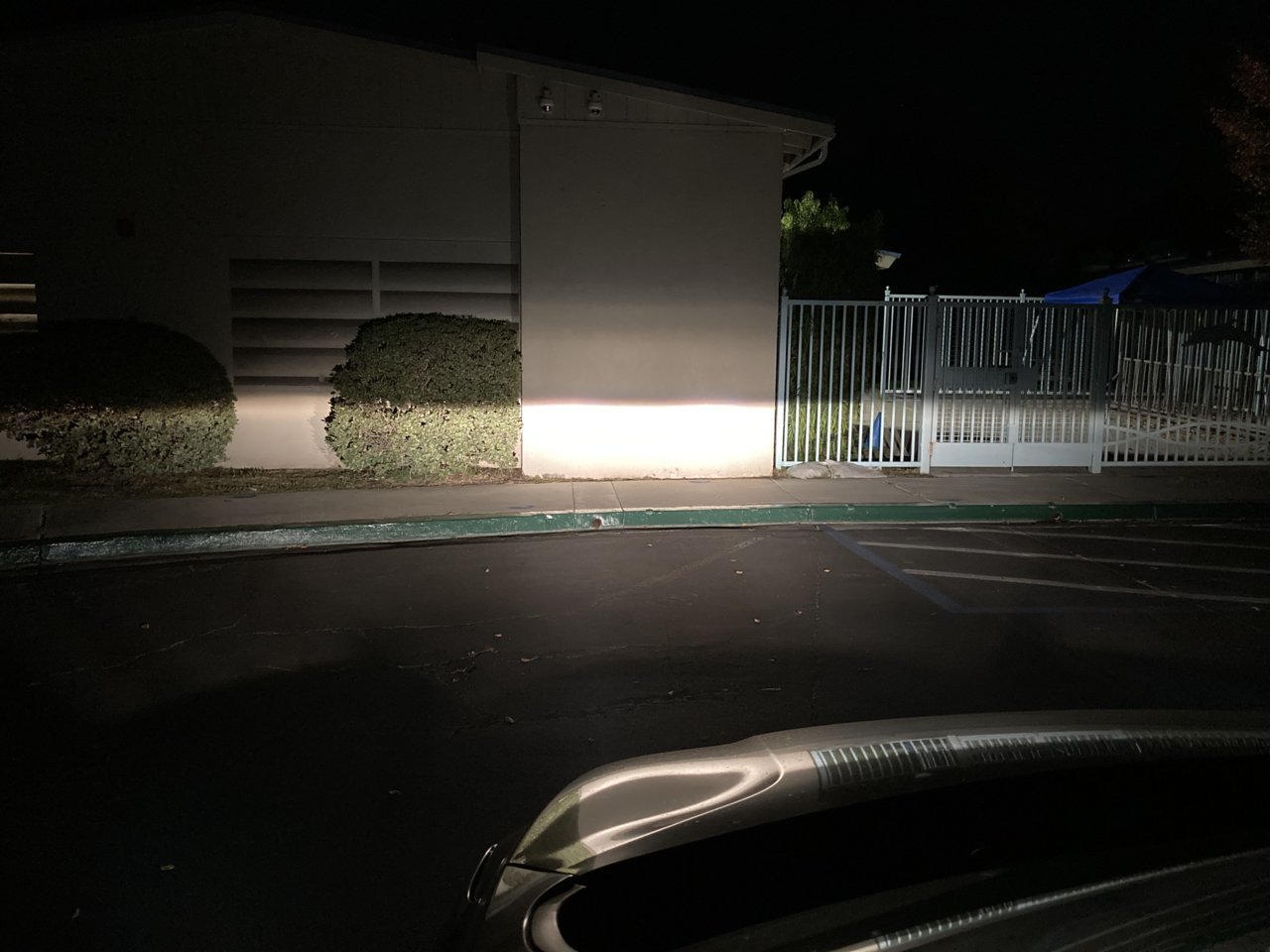

    More photos of the DD SS3 MAX in a 2018 Odyssey. I disconnected the low beams for these.
    NOTE: my driveway slopes significantly in both planes. Sorry.
    From the front:
    From headlight height:
    From standing:
    With low beams reconnected:
