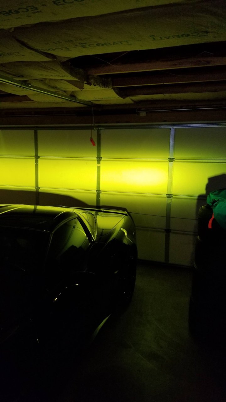

    SS3 6000k Max with the 4000k yellow Pro/Sport selective yellow fog optic. This combo is not supplied by Diode Dynamics and not recommended.
    The result of a 6000k blue light with too light of a yellow correction filter is green. Which is why the Max requires a unique optic color for selective yellow.
    CIE1931 Chromaticity plot
    Checking the output color against the selective yellow chromaticity window, it fails hard as way outside the legal chromaticity box. Obviously Diode Dynamics knew this which is why they developed a unique optic to the Max to correct it back to the legal color of yellow and get it within the chromaticity window.
