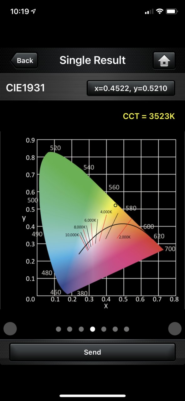

    Here's what @crashnburn80 recommended when I asked about the best Pro combo to match halogen headlight color temp...
    For white I'd highly recommend ordering the 4000k emitter based selective yellow lights and purchasing a white lens to get 4000k output. The output color is phenomenal and no loss in intensity over the 6000k 'white' version. No other LED fogs on the market are available in this color temp. 4000k will look far more natural with your halogens, whereas 6000k is not going to blend well at all and be more distracting. Only the Sport and Pro are available in 4000k.
    6000k vs 4000k vs 3000k (shown in Sport)
    So based on wanting white to run with a halogen setup, I'd go with the Pro in 4000k.
    I, therefore, picked-up a pair of Pro Yellow SAE Fog (#DD6191) and Clear SAE/DOT Fog lenses (#DD6350) on Black Friday. The Clear Fog lenses will replace the original Yellow Fog lenses with which the light assemblies shipped. (Waiting for it to warm-up a bit to install them, so no feedback yet.)

    Yes, it produces a very nice 4000k white. Yellow SS3s with clear lenses for 4000k was demonstrated and covered in the SS3 review, so you can see the color output next to the selective yellow and 6000k.
    Edit: @Norton has all the details and image in the above post!

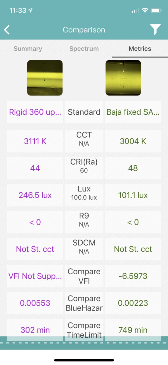

    If you are curious on the output intensity measurements of the selective yellow 360s vs the selective yellow Bajas you can see below.
