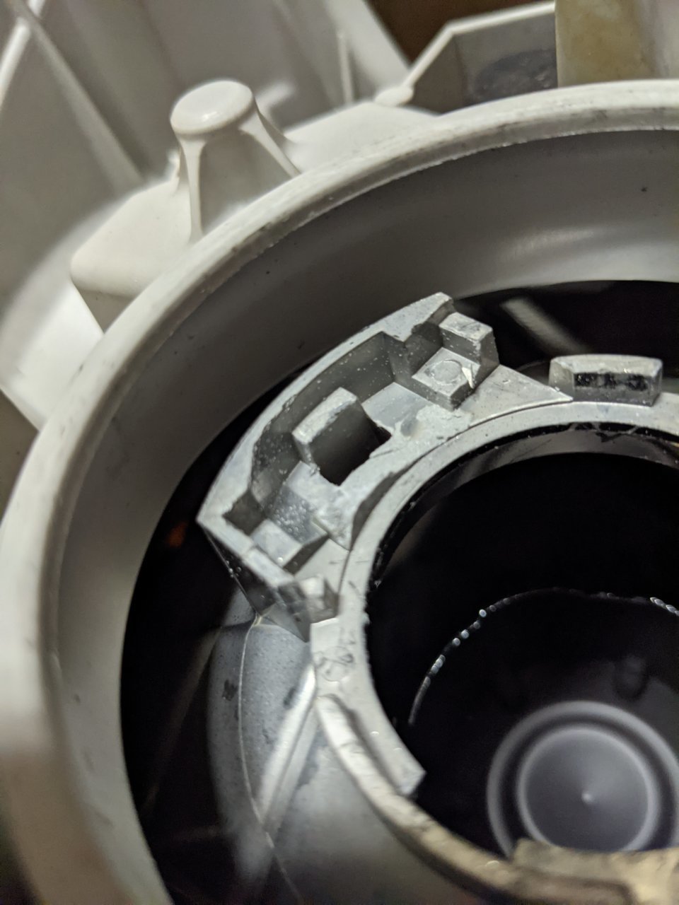

    Do you have a picture of how it broke? I have use .032” safety wire (like bailing wire but thinner and made of stainless steel) in the past on headlights to fix the bulb holder, granted that was on cars that weren’t worth installing a new headlight on. But it would get you by until you are able to get new headlights or find suitable used used OEM ones.

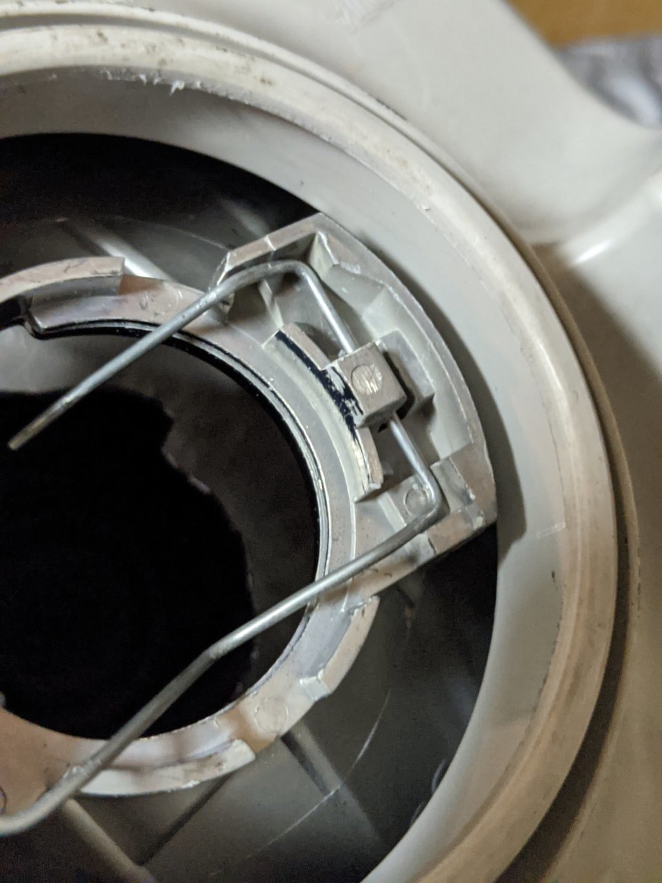

    I attached pictures of both the broken housing and the other one that isn't. I tried to rig the broken one to work without the spring clip, but it just didn't work, and resulted in the bulb not seating properly and blinding drivers at night. I bit the bullet and bought brand new housings, and I'm glad I did because they look and perform flawlessly.

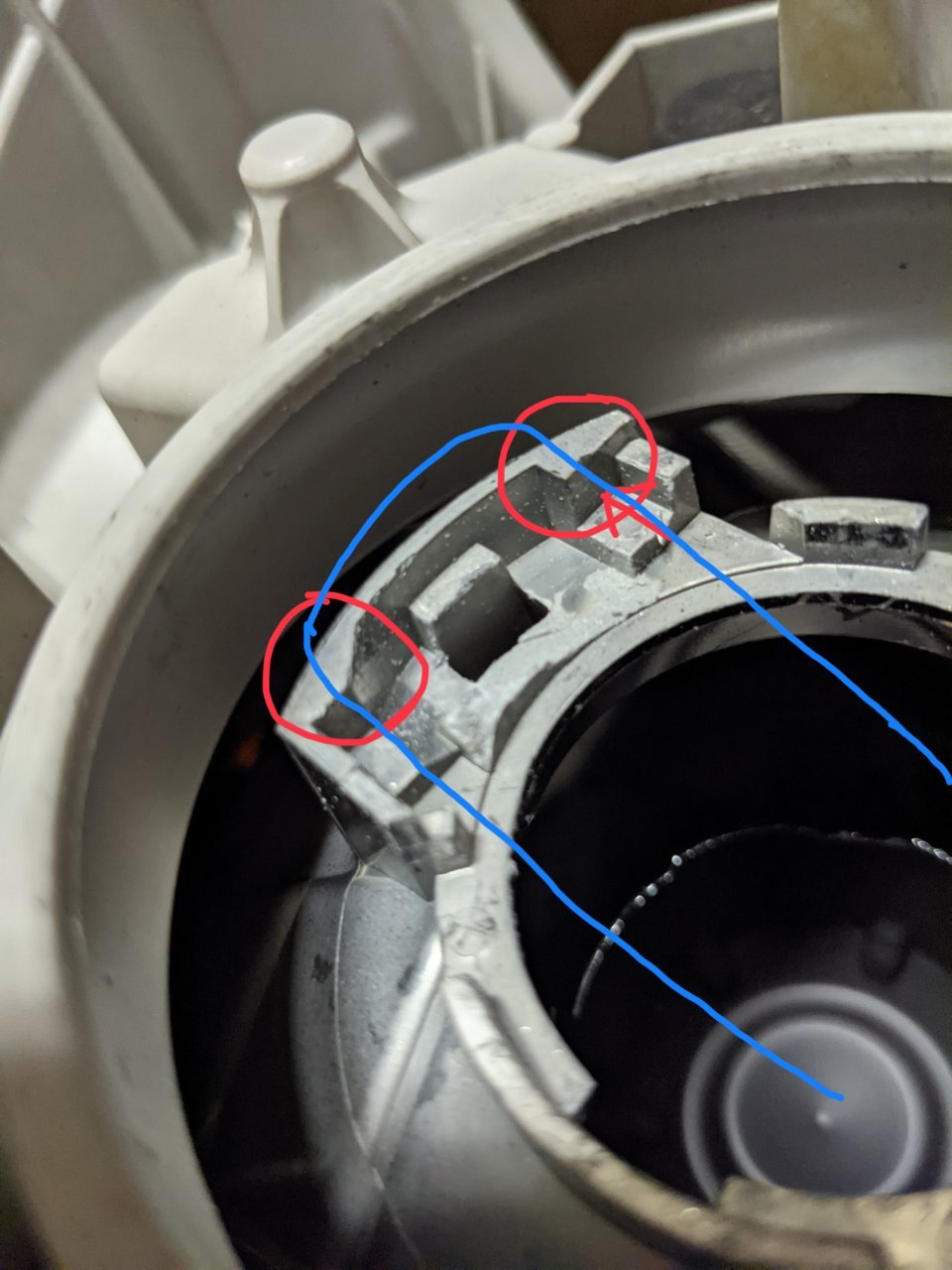

    So what you can do is drill a couple 1/16” holes where I have circled as close to the the base of the corner as you can without getting filings in the housing (I use a vacuum while drilling and place paper towels in the bulb socket and around the outer portion while drilling very slowly). Then you can use some safety wire (you can get a spool at Harbor Freight even) and run it through those holes, install the bulb and then run the safety wire down to the clip for the spring assembly and gently twist the wire into a pigtail until it is tight but not tight enough that you snap off the lower clip portion.
    This is the best I can draw on my iPad. Lol

    I appreciate the advise and good idea, but I've already bought new OEM assemblies and installed them. Maybe I'll do what you're saying and keep the old ones as backups.
