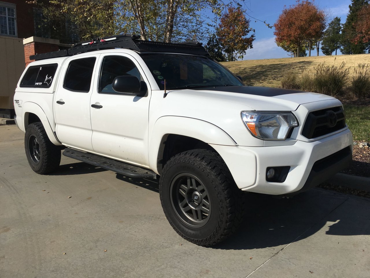

    Thanks! I've got different wheels now, need to update my picture I guess.
