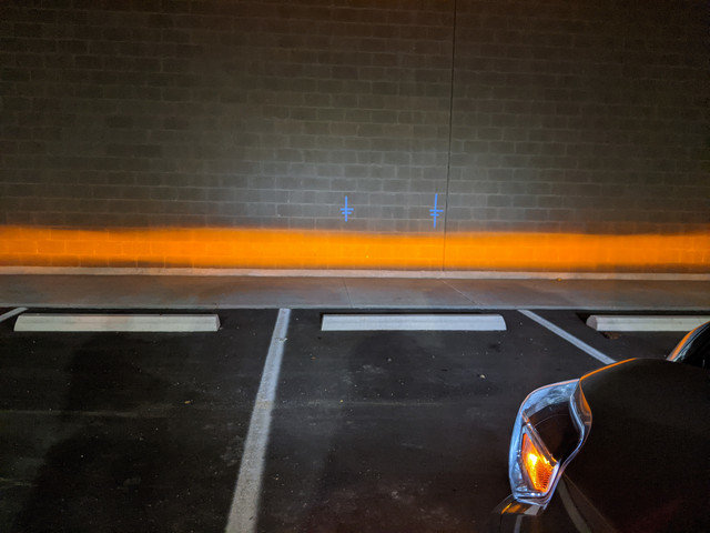

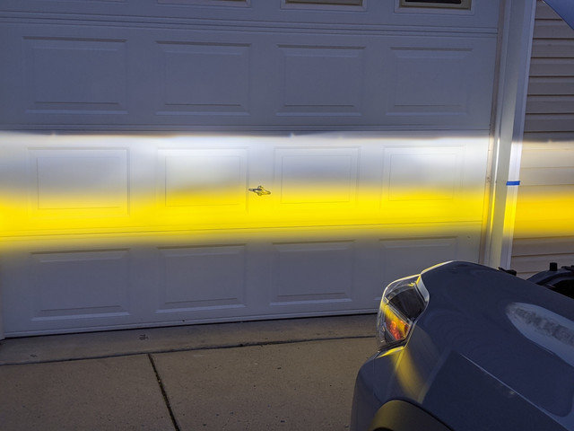

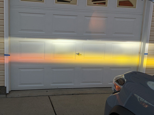

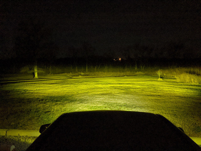

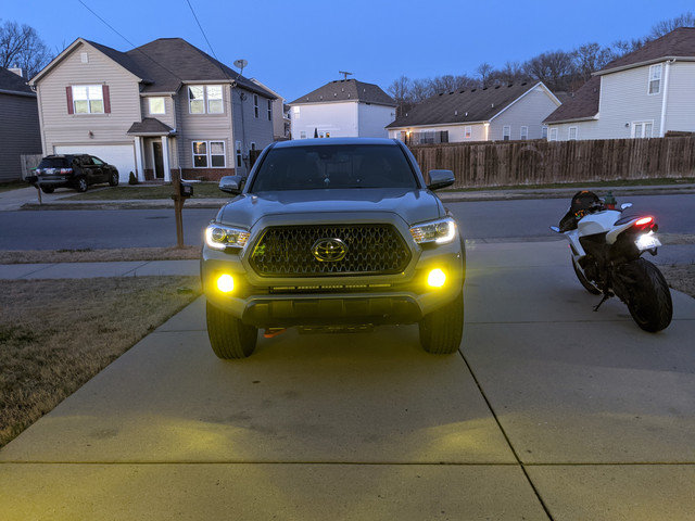

    Diode Dynamics SS3 Max Selective Yellow (Fog lens) Vs Morimoto XB Amber
    SS3 Fitment
    Just showin off
    Low Beam and fogs were properly aligned at 25yds prior to pictures. I used the XB's alignment to align the new fogs so they may not be perfect.
    Previous alignment behind Aldi about 3 weeks ago
    The following were taken at a park with fairly low light pollution, but this is not "scientific" as I just used my Pixel 3 phone camera. Tree line is about 70 yards away and the grass is sloping slightly downhill.

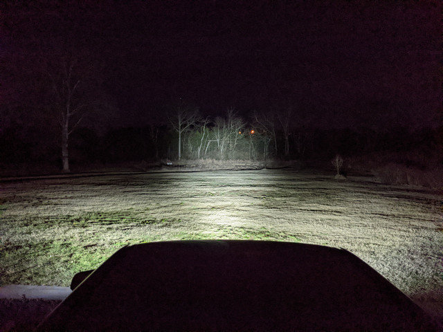

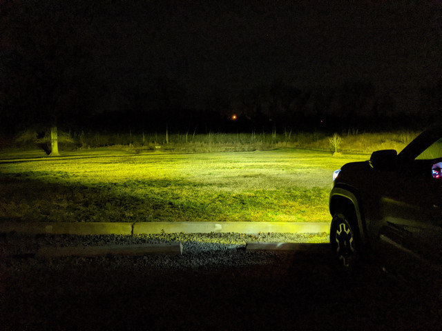

    Top Low (Hikari Ultra H11)
    Top Fog (SS3 Max Selective Yellow (Fog lens))
    Top Low & Fog
    Top Light Bar (Diode Dynamics Stage Series 30" Combo)
    Side Low
    Side Fog
    Side Low & Fog
    Side Low, Fog, and Light Bar

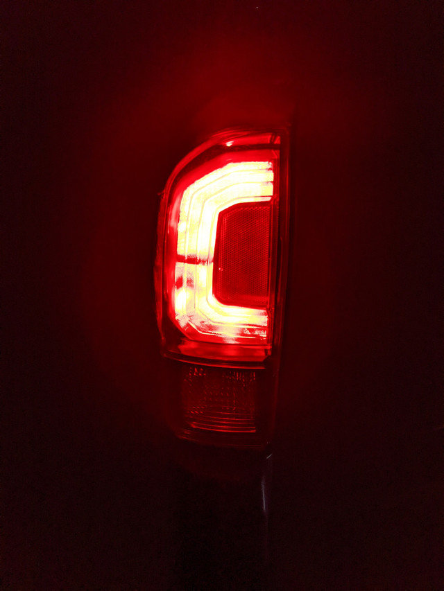

    MESO Total Tail Stage 1

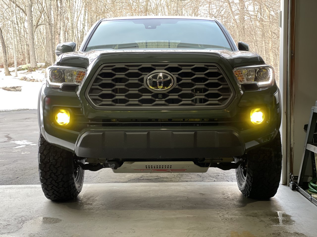

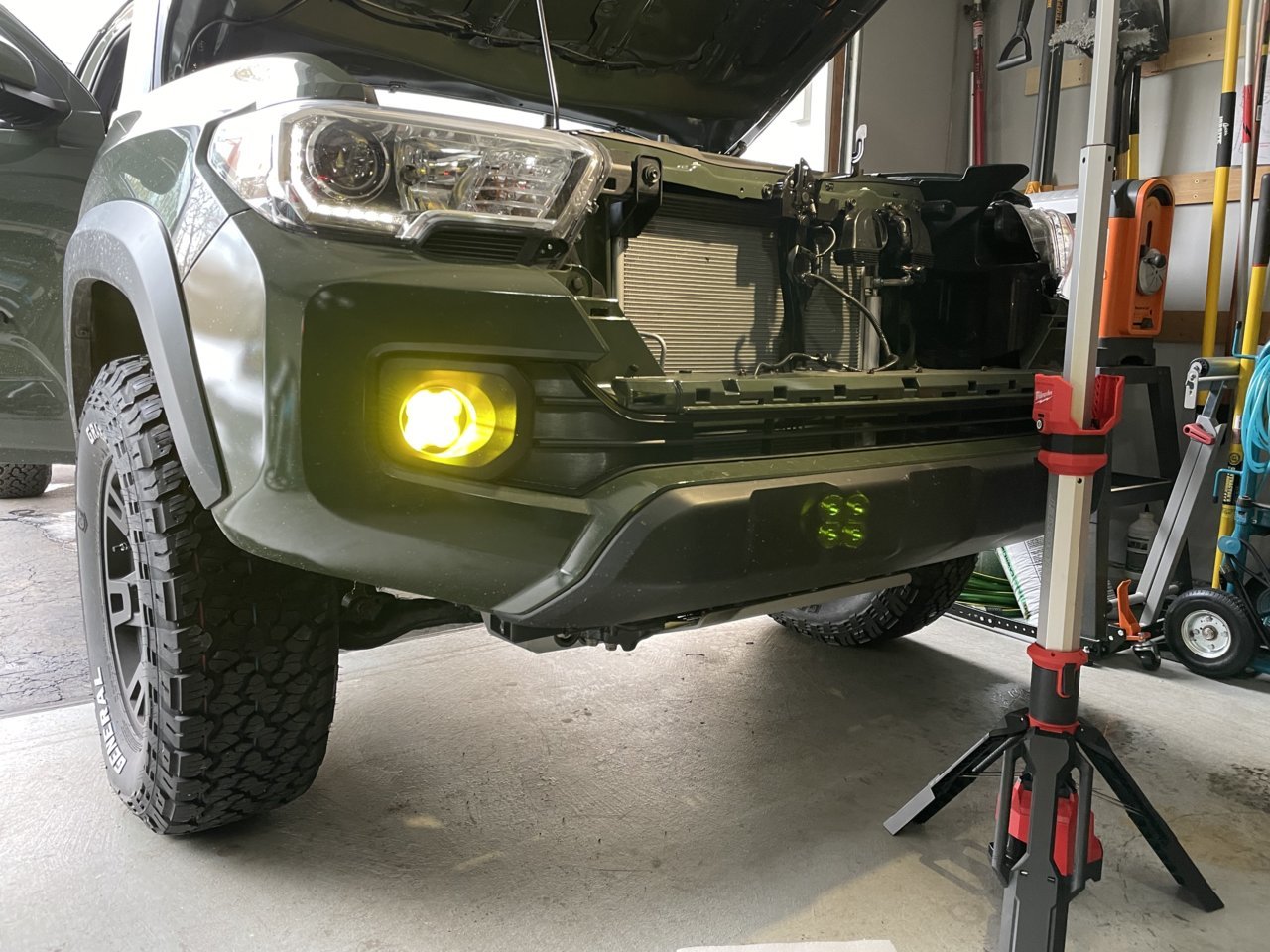

    I just got my SS3 Maxes in selective yellow installed just now. Was a little tough aiming them. I did one at a time inside the garage, as was recommended here, and it just so happened the beam stopped at particular stair step to inside the house. Could barely see the OEM fogs, so that step made things a bit easier. Also found it easier to remove the black plastic cowls on the sides to give me more room for access. The far side socket head bolt for aiming was tough to slip a hex wrench in.
    Thanks to @memario1214 for the BF deal.
