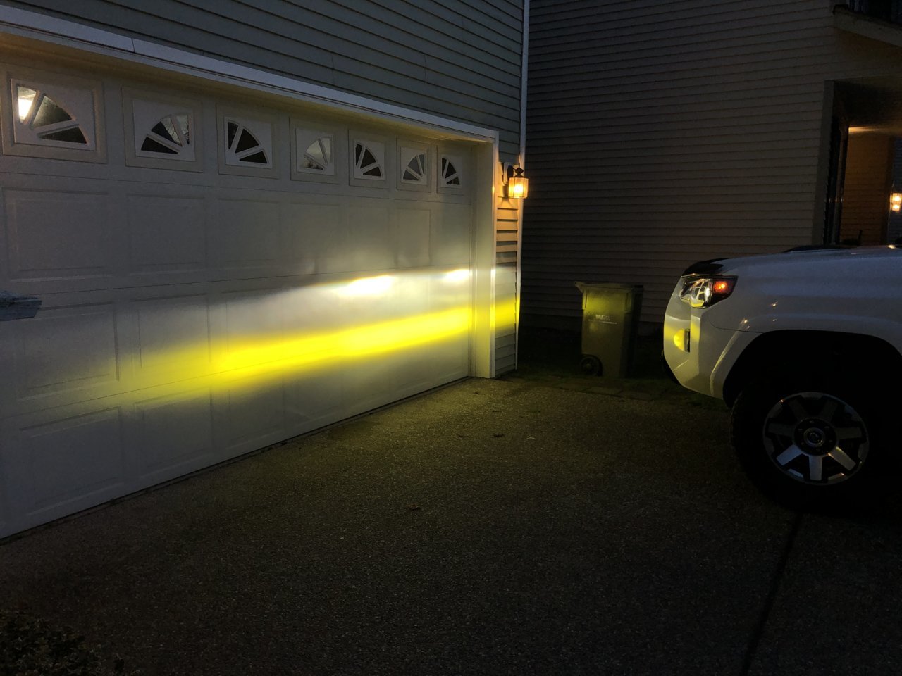

    First is at 20 feet away. 2nd about 10

    yeah, that doesn't look like it's really washed out when aimed properly. thanks spike

    Any tips on aiming the SS3 pros since the cutoff isn't as crisp?

    Aim them as low as they can go. The top of the housing contacts the bezel on the bumper.

    But that angle is different depending on how far forward or back they are in the mount.
    They are angled down based on looking at them on heavy fog from the side, I just want to make sure it's enough.

    There's a guide on how to adjust here: http://www.ttguide.net/adjustment-1981.html
    Since my fogs were misaligned from the factory and didn't serve as a good basis to start, I used this guide and started with the "3 meter" alignment, since the Pro cutoff is much sharper at that distance. I then ballparked the 25' distance. By turning foglights on, and then rotating the headlight switch between low & off, you're able to kinda gauge where they are in relation to each other.

    Initially I pre set them on the mounting brackets to the max and found interference to the bumper.
    Not sure how much room you have on the Tacoma's but I just tinkered with them until they went in.
    I've found they can still be shifted after install which helps for final adjustments.
