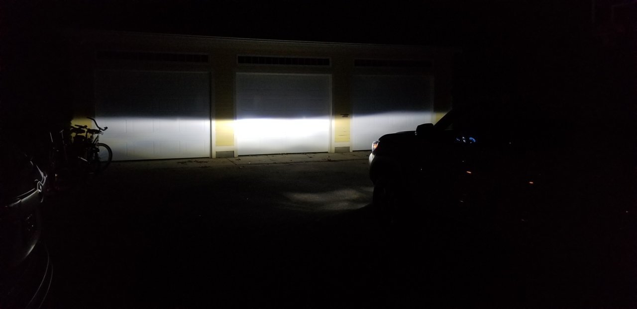

    Loving my H11 Hikari LEDs. Stunning cut off and output. I use them on Lo and High.

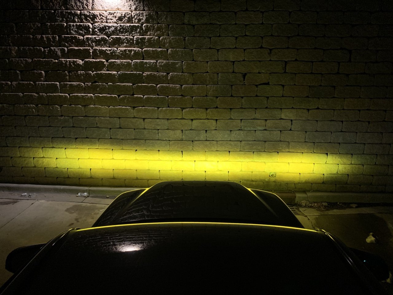

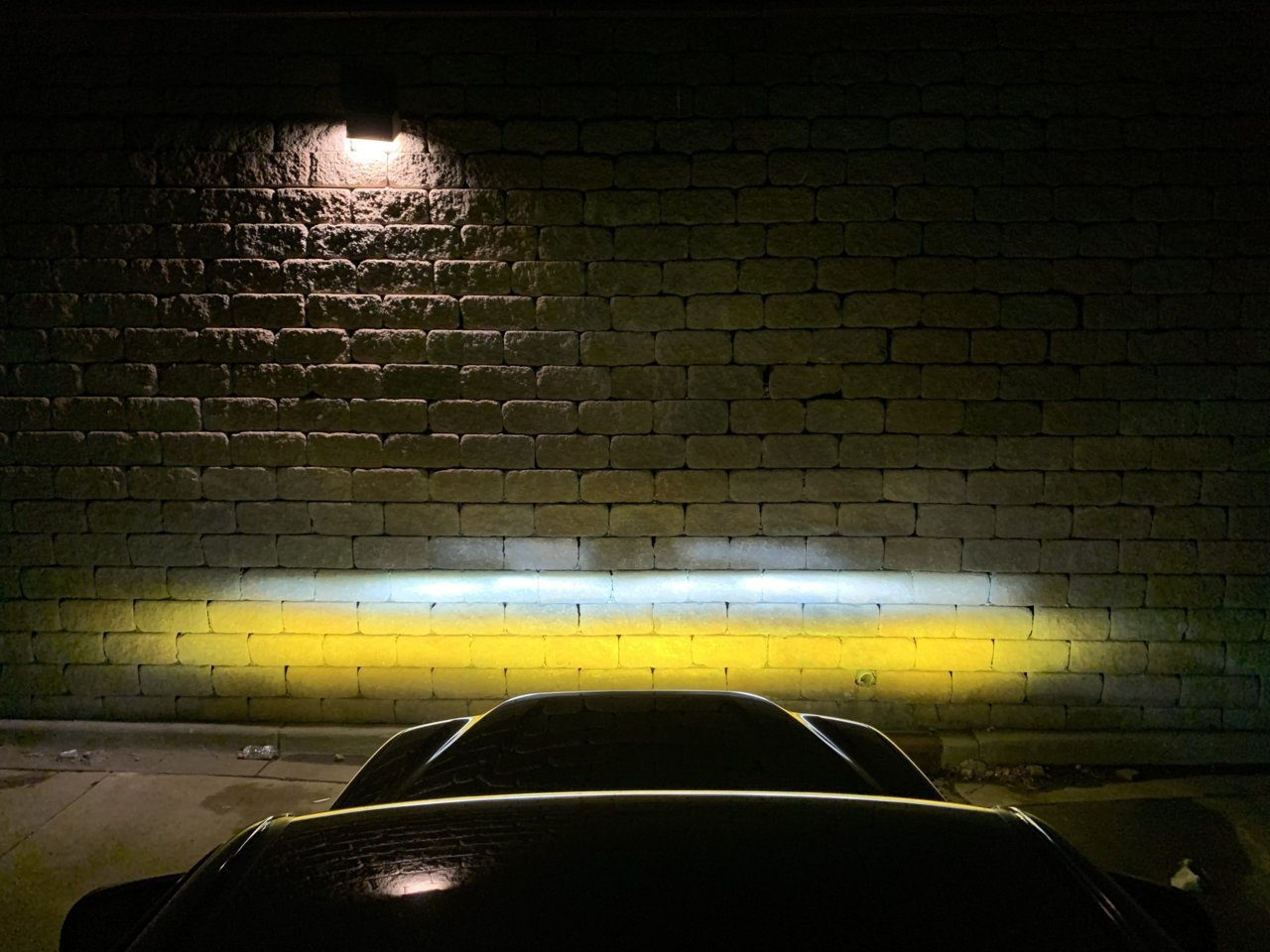

    Just installed the DD SS3 Pro, fog pattern, amber. Is there anything on the light body that shows sport or pro (besides the less defined cutoff)? I’m not blown away by the brightness compared to my OEM LED headlights and the way the packaging is makes me wonder if I got the pros (the package just says SS3, and the pro is on the sticker on the side of the box, seems like it would be easy to mis label).

    The underside of the housing should have a small white sticker indicating the power level. Did you make sure to aim them correctly? The difference between them and the OEM LED ones should be pretty noticeable.

    Thanks for the fast response, I will look at the undersides of the lights. I installed one, aimed it to match my stock Fogs, than tightened it in place. And then installed the second one today and need to aim it to match the first one once the sun finally goes down.

    I checked the stickers on the plug and they do in fact say pro so thanks for that.

    Looks impressive!!
