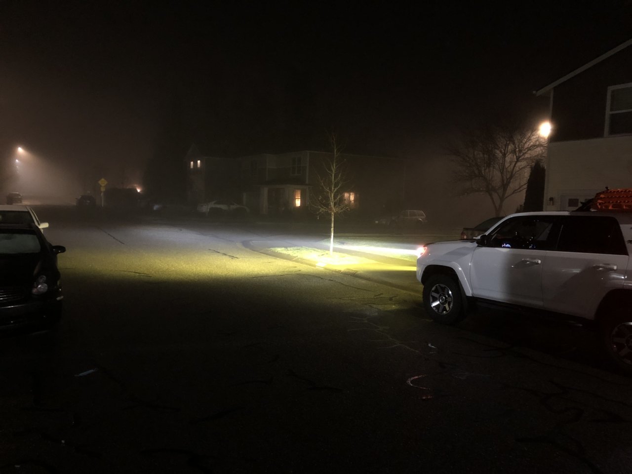

    4Runner
    SS30 bar and S2 ditch lights up top. Taking a picture of them at night is tough though!

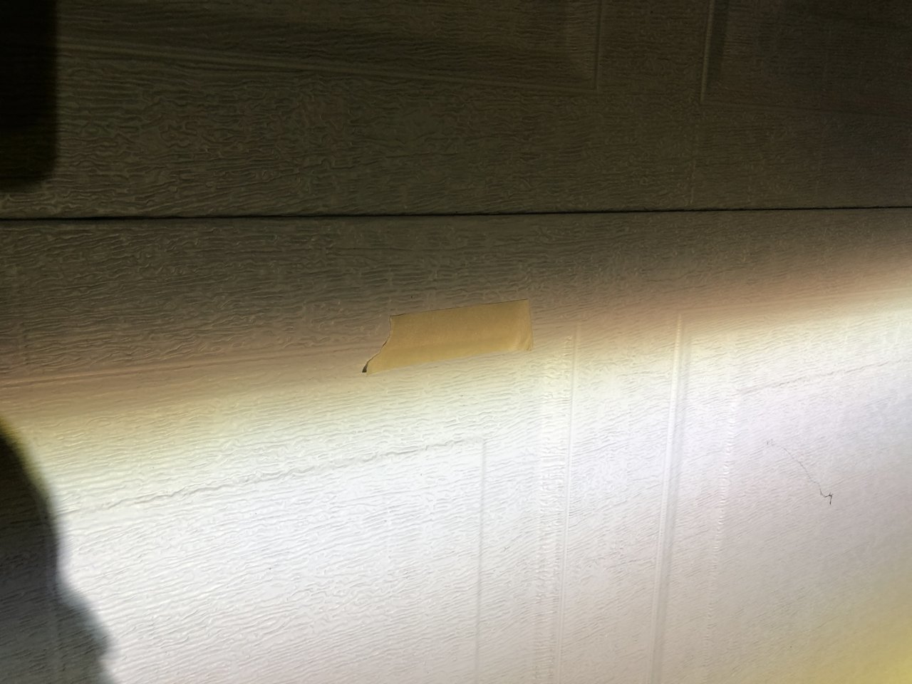

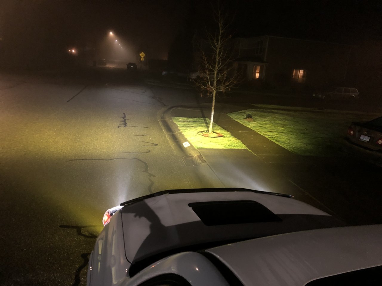

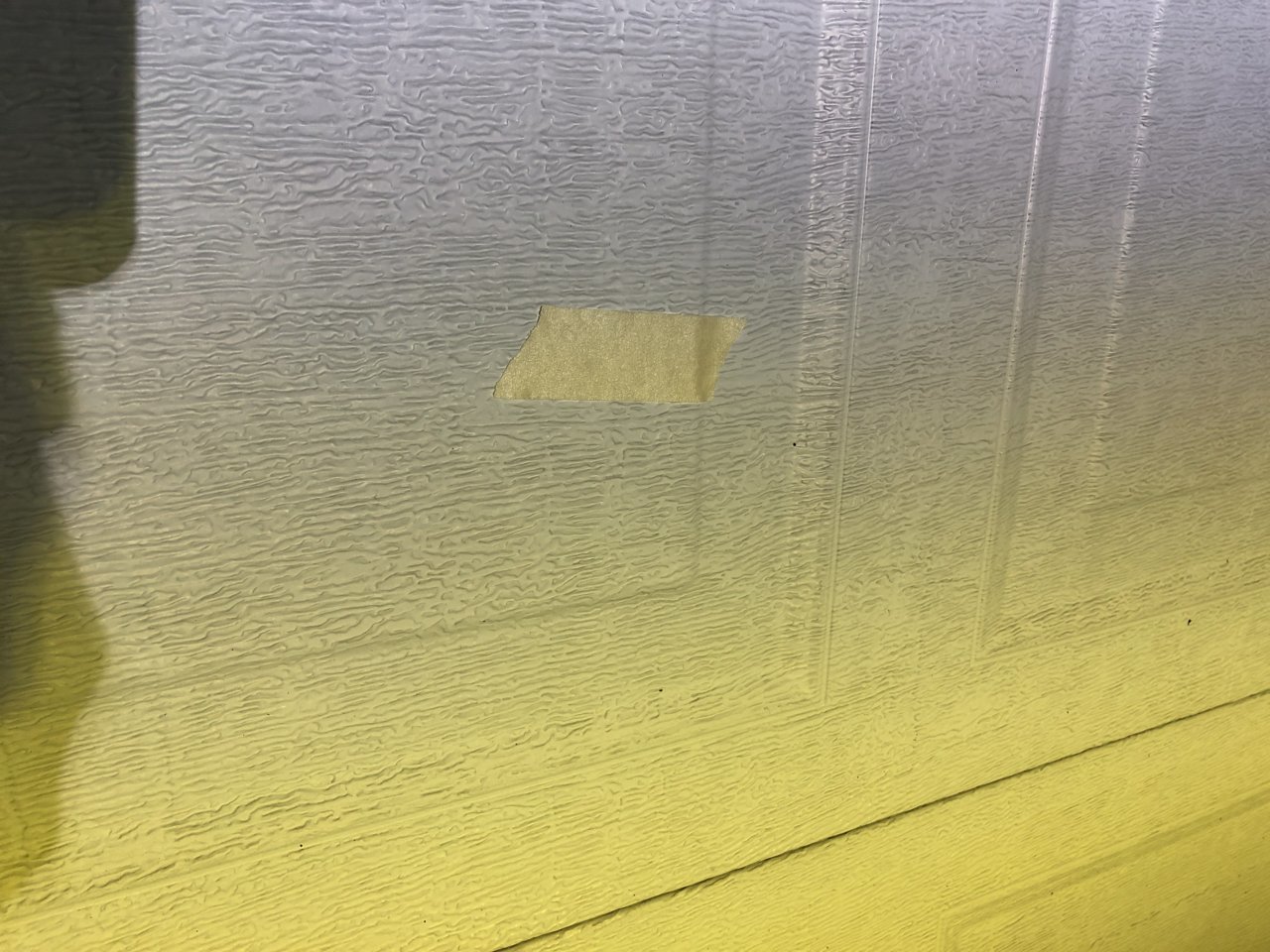

  5. Jan 10, 2021 at 12:14 AM
    #4325
    Spike Spiegel
    Spike Spiegel Well-Known Member
    Oct 27, 2019
    #309219
    180
    2019 Super White Toyota 4Runner TRD Off-road Premium
    Eibach Pro Truck Lift, JBA High Caster UCA’s, Falken Wildpeak 275/70/17, Spidertrax Spacers

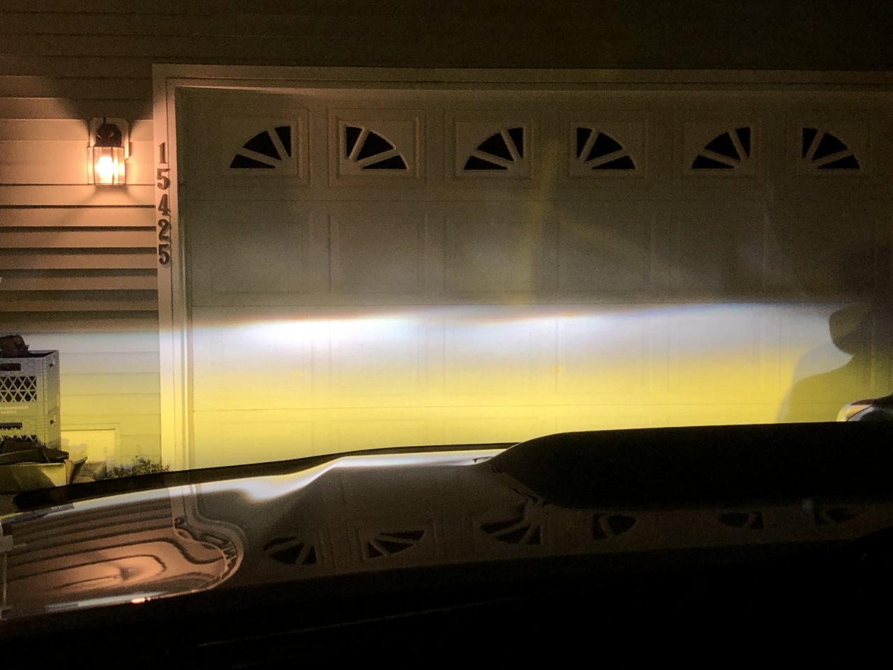

    Followed the Dan Stern lighting guide as close as possible and the first thing I learned was my driveway isn’t as flat as I thought.
    Alignment was set at 15 feet.
    Do you guys adjust to right when any amount of light reaches the points or the hotter spots?
    As you can see in the images I did the hot spot for the low beams while fogs were done at the tip of the pattern
    Found using the camera on the phone makes it much easier to distinguish the outlines
    ianGP likes this.
  6. Jan 10, 2021 at 8:18 AM
    #4326
    se7enine
    se7enine MCMLXXIX
    Apr 18, 2013
    #102322
    23,446
    Reno, NV
    Looks like the driver bulb is angled a tiny bit low and the passenger is very high. Not the actual housing but the way the bulb sits in the housing.

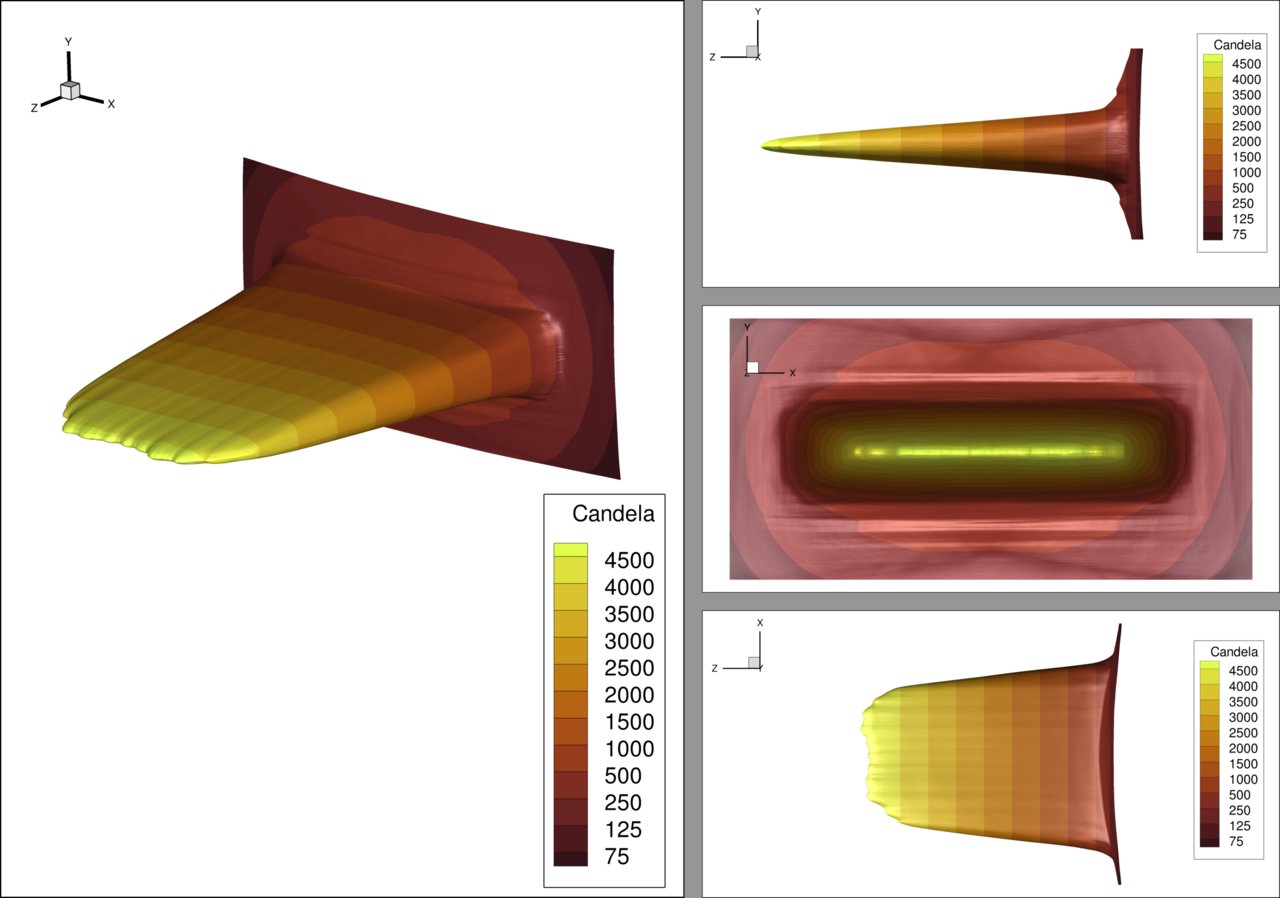

  13. Jan 13, 2021 at 1:57 PM
    #4333
    crashnburn80
    crashnburn80 [OP] Vehicle Design Engineer
    Jun 6, 2015
    #156893
    14,765
    Kirkland, WA
    2003 DCSB TRD OR

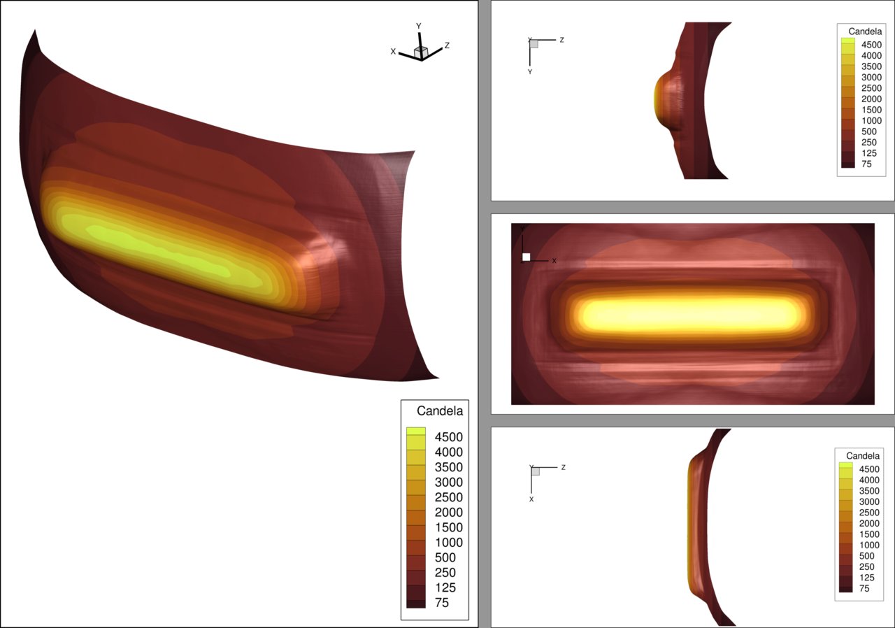

    Here is my 5 minute attempt to plot light output in 3 dimensions using candela as the depth variable. This is Baja's original SAE light. To be fair, the test results only cover 40 degrees left and right of center (80 degrees total), so spill beyond 40 degrees to the sides is not captured in these results.
  14. Jan 13, 2021 at 2:04 PM
    #4334
    Diode Dynamics
    Diode Dynamics Automotive Lighting Experts Vendor
    May 26, 2016
    #187969
    883
    St. Louis, Missouri
    Wow, I've never seen anything like that! I am not sure what the z axis represents, but intensity is inversely proportional to the square of the distance... and if you can figure out how to plot that, you should license it. Though at this point, I think you may just be re-inventing CGI or something. :goingcrazy:
  15. Jan 13, 2021 at 2:07 PM
    #4335
    crashnburn80
    Jun 6, 2015
    #156893
    14,765
    Kirkland, WA
    2003 DCSB TRD OR
    Yeah, I was thinking that about distance as soon as I posted it. It is easy enough to create a new variable via an equation operated on an existing variable (candela) to correctly calculate the distance projection for a more accurate representation of depth.
    Toy_Runner and daveeasa like this.
  16. Jan 13, 2021 at 2:44 PM
    #4336
    crashnburn80
    Jun 6, 2015
    #156893
    14,765
    Kirkland, WA
    2003 DCSB TRD OR
    Candela = 1/d^2
    So then Distance = Sqrt(1/Candela)
    Calculating distance based off candela and updating the Z-axis to use calculated distance. Might help to use a slight magnification factor on distance for better visual.
    Edit: this still doesn't quite seem quite right for distance.

    amazing. crash, you are a wizard. would love to see a visual representation like this in your headlight thread, but i assume the effort would be monumental given the different beam patterns
  19. Jan 13, 2021 at 4:02 PM
    #4339
    crashnburn80
    Jun 6, 2015
    #156893
    14,765
    Kirkland, WA
    2003 DCSB TRD OR
    Once I create the first plot, subsequent plots can be mostly automated making it quite easy. The most time consuming part is just making some minor edits in the data format to get it into the application. To make the plots though requires raw measured test data from a testing facility, which I don't have for the headlights.
