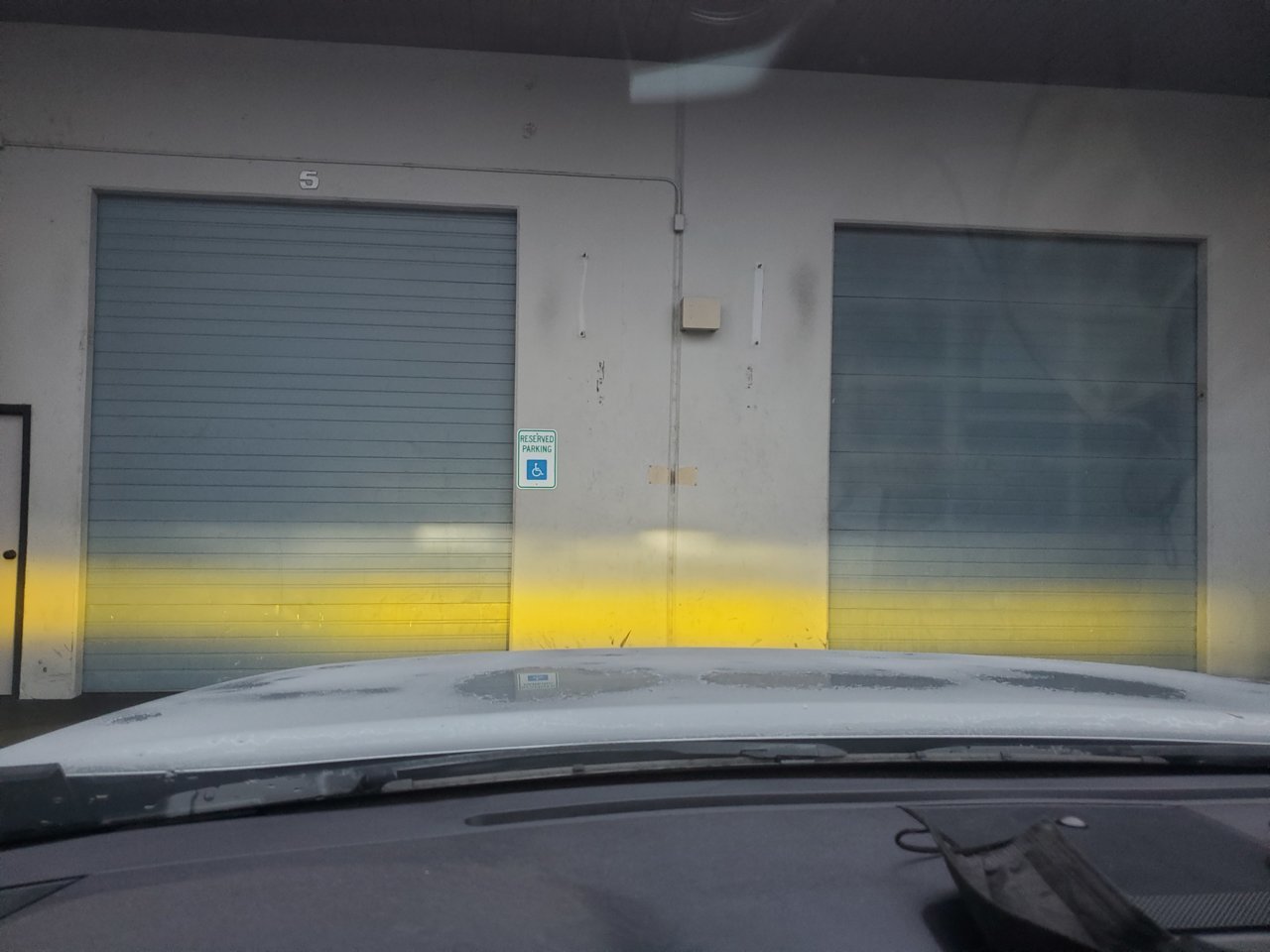

    My contribution
    DD right BD left (yes they are on, you can kinda see the yellow around the tire print) You can see the sharpie marks on the wall around the BD beam
    DD is aimed a little lower, and has much tighter pattern.

    Max's at about 15-18'
