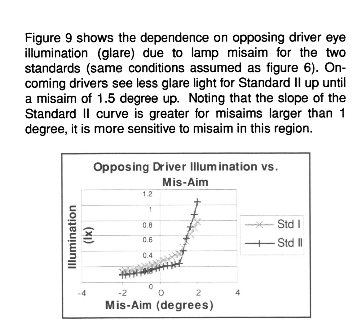

    You are saying that mine might not be properly aimed but I actually got talked to by a passing cop for putting small chalk marks on the wall of the school. I tried pretty hard to do the job right but I think DD could have made the job way easier by having a better/sharper cutoff. I only got flashed one time, and I was swinging out of my driveway with my H9 headlights, maybe the oncoming driver thought they were high beams.
    I paid a lot of attention to aiming them because glare gets pretty bad as you go beyond 1.5 degrees of mis-aim for a halogen light. This figure is from Society of Automotive Engineers, Inc. 2000-01-0434 Front Fog Lamp Performance W. R. Folks and D. Kreysar:
    I have yellow emitters but clear lenses on my Pros, per your earlier recommendation. Maybe that is a factor.
