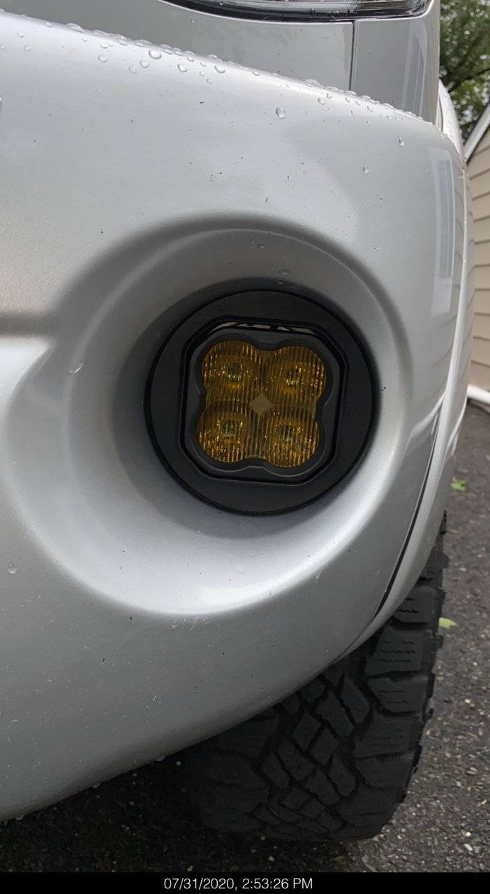

    baja squadron pros
    A07A058A-0ACC-493E-BDD6-6F533B141AB2.jpg I have the sports and there great in lighting up the sides. But im not quite happy with the front output.im just asking but im willing to trade my sports for someones pros plus cash. If someone is local im willing to trade with you. It would be a easy swap just the lights have to come out. There less than a year old and barely used maybe 10hours on them
