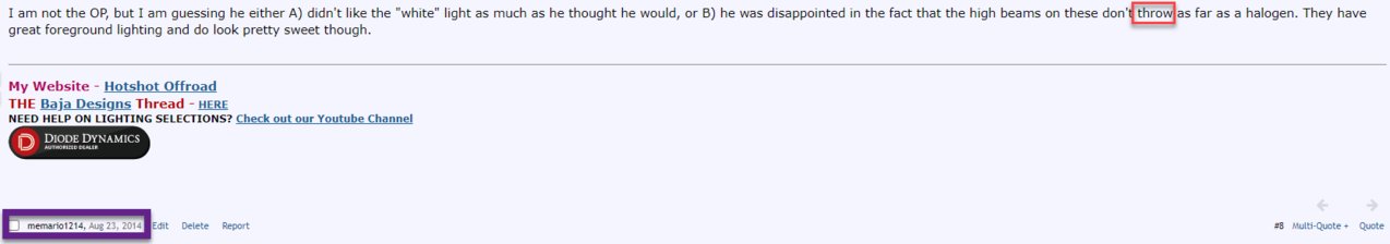

    Lol no, no. I had been improperly using that term for YEARS before you even made an account here, and I even found some references from 2010... :rofl: If it's any consolation I still stand by what I said back then!
    Ex.
