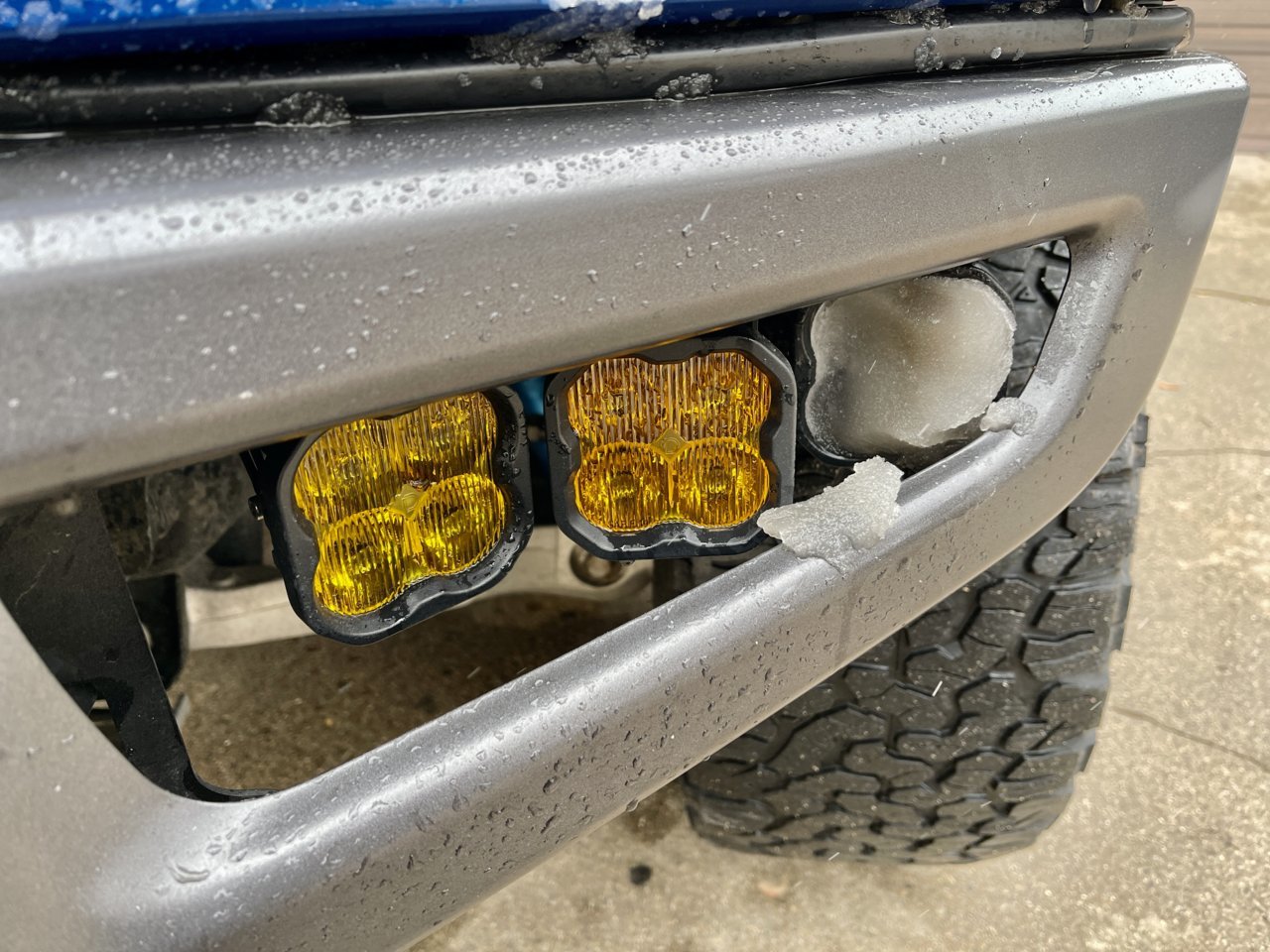

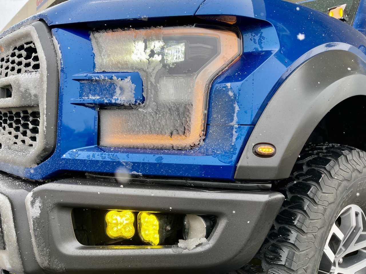

    Right now I have 3 pairs Diode Dynamics lights in my front bumper, all in the front bumper fog pockets. One pair of white sport driving, one pair of max yellow fog, and one pair of sport yellow fog. The max fogs are aimed directly forward, and the sport fogs are aimed 35° to the right and left to provide extra cornering light in my dark neighborhood. I actually just got the max’s from one of your vendors, memario1214 at HotShot Offroad, who’s been awesome to deal with.
    I live in Utah and commute 40 miles from Utah Valley up through Salt Lake City to the International airport. I go to work at 5am and then I drive home around 8pm, so most of my winter driving is also in the dark. From my observations so far I can tell you the Sports will probably NOT be helpful in anything other than fog and rain. If there's any light snow or slush the sports will ice over and get blocked because they simply don’t run hot enough. I drove through a light snow storm before I got the pair of max’s, and the sports were completely blocked within 5 minutes.
    I just got the max's a couple weeks ago and we're having an extremely bad snow year, so I haven’t had a chance to run them in a good snow storm yet. However, I did take some temperature readings with my IR thermometer the past few mornings and here’s what I found.
    First Morning:
    • I idled my truck with the fog lights on to warm them up for 8 minutes. After 8 minutes the air temp was 44°F, the sport yellow lenses were 68°F, and the max yellow lenses were 96°F. This was just sitting at idle with no airflow.
    • After my 40 minute commute, mostly at 74 mph, I immediately got out and took another reading. The air temp was 38°F, the sport yellow lenses were 44°F, and the max yellow lenses were 80°F. This was with no snow or rain, just the airflow from driving.
    Second Morning:
    • Truck idled with the fog lights on for 15 minutes, after 15 minutes the air temp was 36°F, the sport yellow lenses were 72°F, and the max yellow lenses were 115°F. This was just sitting at idle with no airflow.
    • After my 40 minute commute, mostly at 78 mph, I got these numbers. Air temp was 28°F, the sport yellow lenses were 36°F, and the max yellow lenses were 70°F. This was again with no snow or rain, just the airflow from driving.
    I’m going to try to take some good photographs this weekend, and I’ll update you guys when I take the max yellow fog lights into a storm. Also, keep in mind my bumper pockets are big and wide open, so my lights get a good amount of airflow around them.

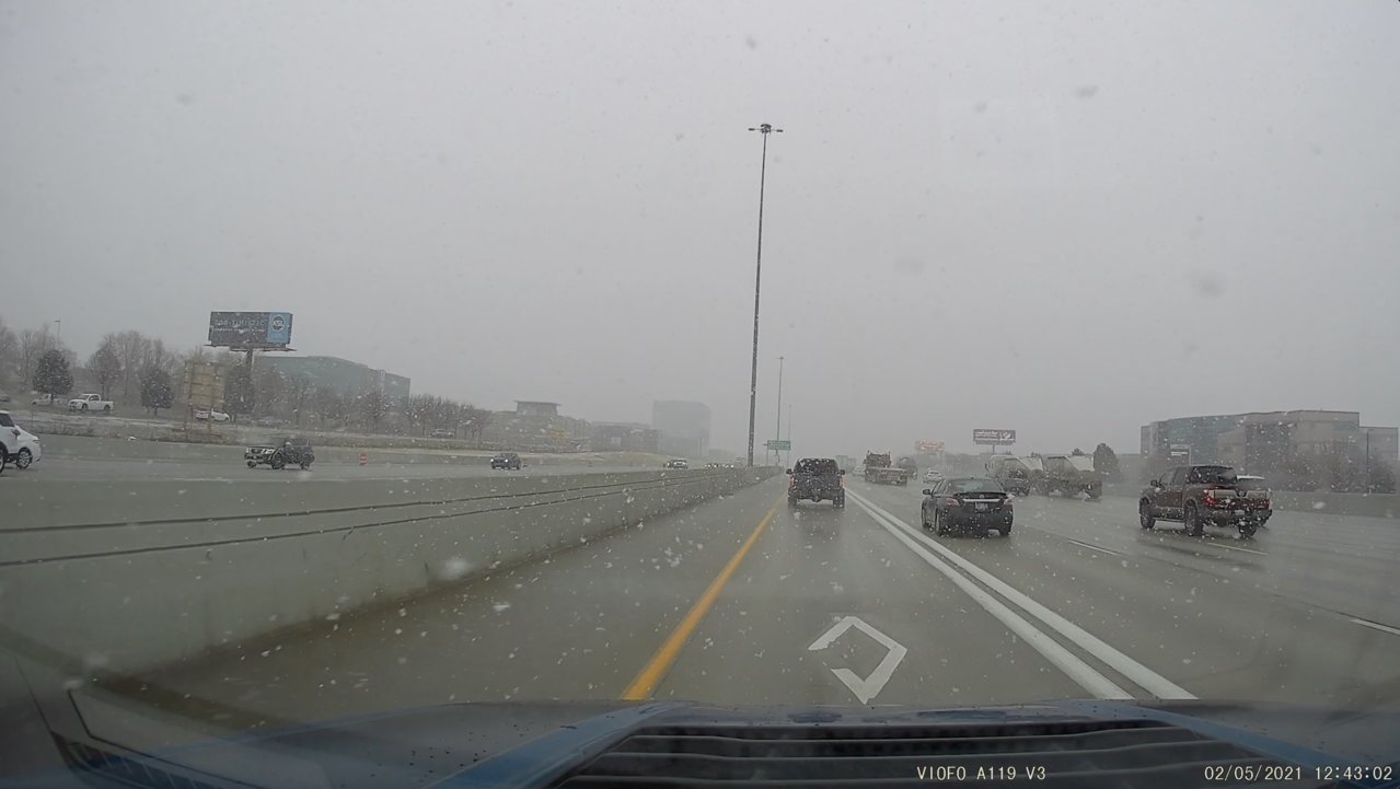

    Also, we finally got a little bit of snow in the valleys while I'm home. I got back from a reserve flight around 1pm today and it was coming down on my way home. It wasn't sticking to the ground anywhere, and still isn't at 3:30pm now, but it did pack on the front of my truck a bit.
    Here's a grab from my dashcam of the driving conditions:

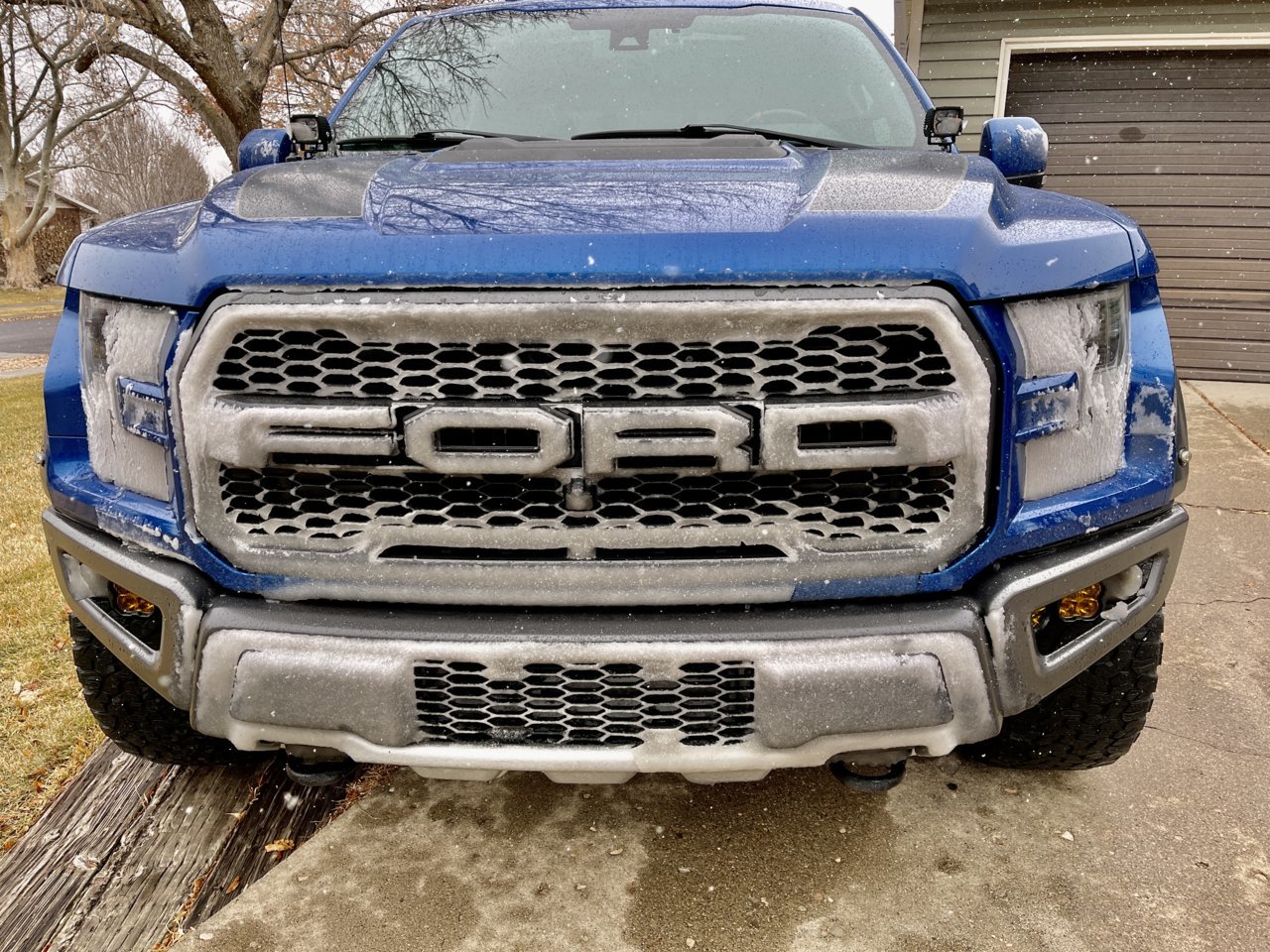

    After my drive home here's what my front end looked like. If this was a night drive the low beams wouldn't be doing anything for me. The low beams were on the entire drive but there's just no heat from these, which is why I hate LED headlights in the winter:
    Here's how the fog lights did, this time the sports managed to stay clean. It probably helps that I recessed them a little more and angled them to the side. They don't get a direct hit by the snow. The white driving lights were left off and you can see how much packed onto them.
    So there you go, if I was driving this truck at night in this storm, the fog lights would be the only thing left still throwing light down the road.

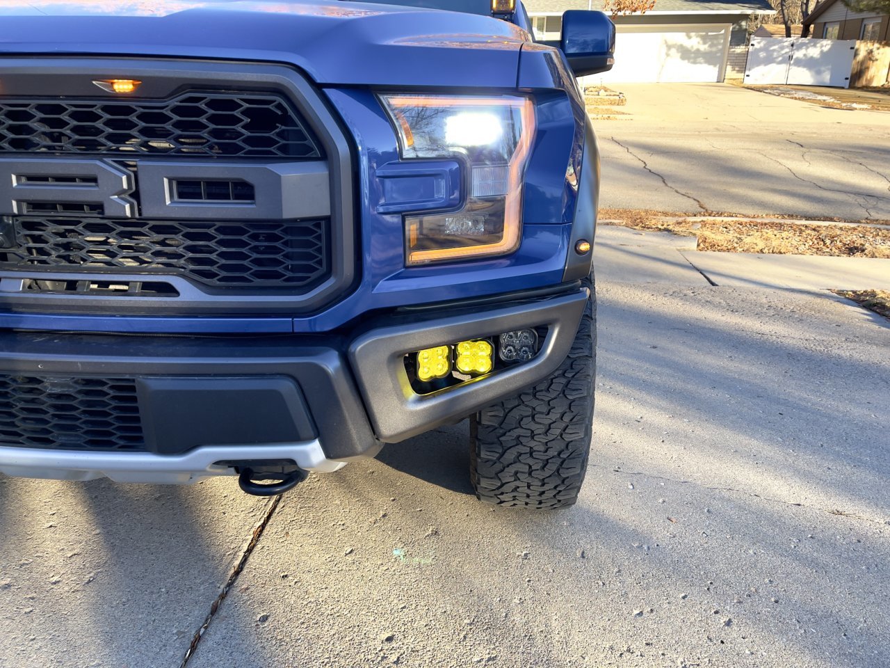

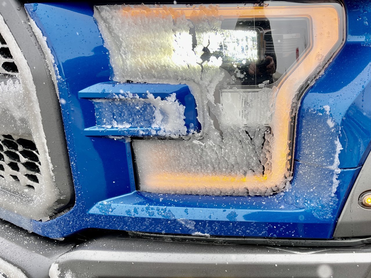

    Great post showing cold weather de-icing performance! Cold weather performance and the ability to de-ice is very important to me as someone who often drives across snowy mountain passes at night. A good light is worthless if it ices over in the conditions it needs to perform in, that is one of the great features of the SS3 Pro/Max for use in poor cold weather conditions. For headlights, this is specifically why I installed heated JW Speaker J3s on my Gladiator instead of the OEM LED headlights in combination with the SS3s. A truck should be able to handle any conditions thrown at it, and to have your lighting be defeated by snow at night is just unacceptable.
    OEM vs Heated JW J3 + SS3 Pro
    OEM vs heated JW J3s
