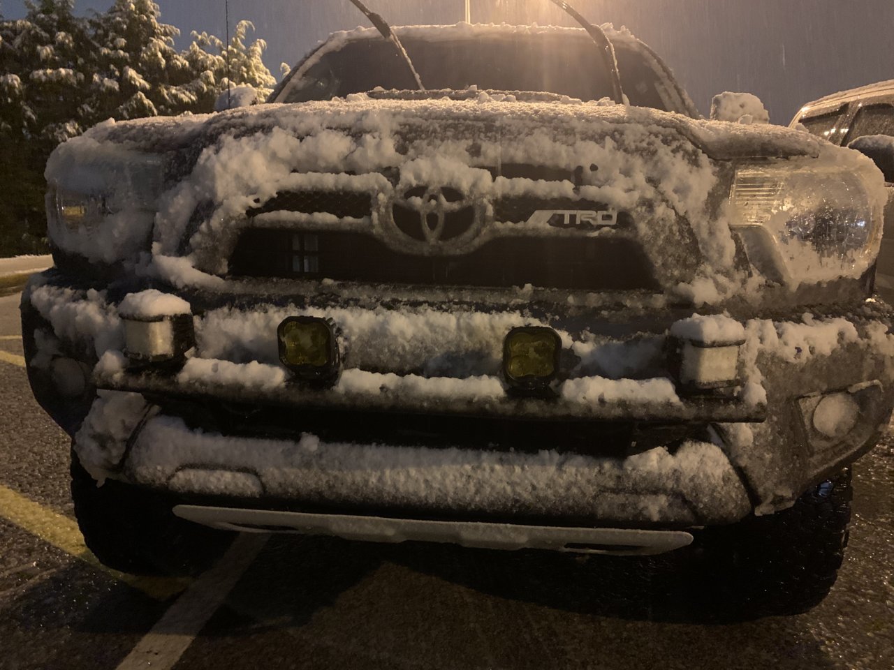

    Halogen headlights vs DD SS3 Pro’s vs KC G4’s

    Drove over the pass this afternoon on a windy 2 lane highway with moderate to heavy fog, with freezing rain and sticking snow. At times everything was just such a white fog it was challenging to identify oncoming vehicles even with their headlights on and with complete ground cover in compact snow and ice there were no lane identifiers. Here lighting performance was about being seen rather than aiding in seeing. All flat surfaces on the JT were caked in heavy snow/ice. Had I kept the OEM LED headlights and LED fogs I would have been all but invisible to oncoming traffic. But with the heated JW Speaker headlights and hot yellow SS3 Pro fogs, I was able to maintain light output to be sure other oncoming drivers could see the truck. It is reasons like this that a lighting solution that is unable to clear snow/ice is an unacceptable solution to me. I had never considered it being an issue in the daytime, but today it was and the installed lighting solutions were up to the task.

    With a -47 W/C, there ain’t anythin’ heatin’ or meltin’ here. Be lucky if it works at all. I couldn’t agree more. See or be seen is what it’s all about.

    My halogens clear themselves at -40 just fine. Must be a Canadian thing.
