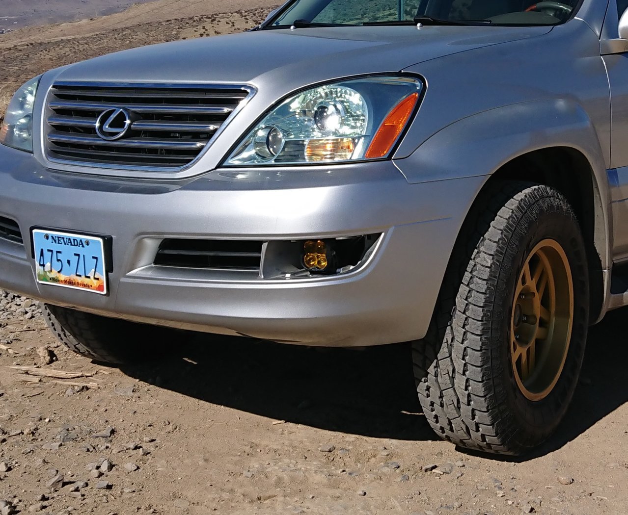

    I'm running the DD SAE sports with the stock wiring.
