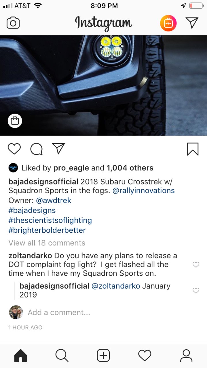

    Baja Designs Instagram page suggest Jan. 2019 for release of DOT compliant fogs. 8D347730-2354-44F6-8CE4-8E8037ACA6D8.jpg
    Edit: I was just about to pull the trigger on Squadron Sports. Depending on the output and look of these new lights, I may just have to wait. I’d hate to spend $250 on some lights and only be able to use them in extreme conditions or when nobody else is around.

    Wise call. Lights are a tool, it is a waste to not be able to not use your tools when needed because you chose the wrong one.
    You know who will be one of the first ones to have them, test them, and share it with everyone else. :)

    Glad I didn’t wait and just ordered the KCs. Don’t like the look of those one bit

    Those are the squadron sports, not the new lights.

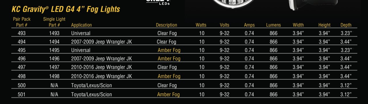

    You are right that information is incorrect, the table should say 'raw lumens'. One of the things I find frustrating with LEDs is few advertise actual lumens which makes comparisons very difficult. Halogen products are all specified in actual lumens, as are residential LED products.

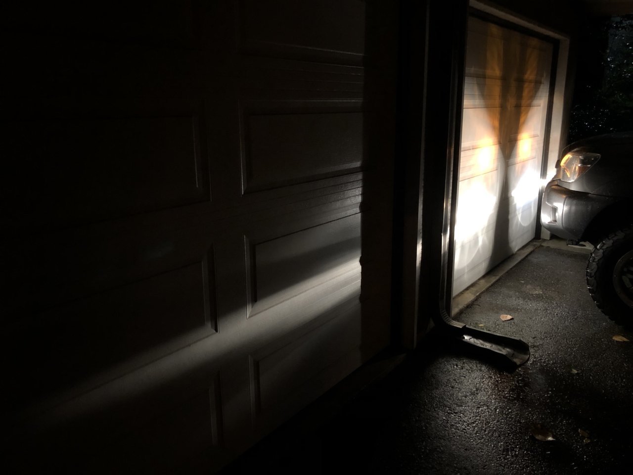

    If looking for a replacement housing, KC G4s will be the best by far for beam spread. But they will not come close to the spread of the specialized wide angle TRD fogs. If you like the spread, you may try changing the bulbs to the Fog Breakers and if not satisfied change to the G4s, just because comparatively the Fog Breakers are not expensive. Easiest place to find them is ebay since they are an international product.
    Funny you should ask about the aux lighting as this is something I have been evaluating on my own truck. And like you I am not a fan of light bars, especially after seeing their performance in person. The most important thing in aux lighting for street use is to keep the light source in front of the hood. Ditch lights and roof bars all do far more harm than good by causing massive glare off the hood which harms your night vision by causing your eyes to constrict causing distance vision loss. And then when you turn the aux lights off your vision is far worse off than before you turned them on, and it can take 15 minutes for your night vision to recover. By placing lights in-front of the hood, you receive no glare from the output. Of course without an aftermarket bumper mounting lighting ahead of the hood is a challenge. Assuming we are not talking about light bars and don't have an aftermarket plate bumper, one option is a bull bar, personally not a fan. The other option is going with some sort of mesh grill and mounting lights behind the grill. You then need to consider pattern, personally I'd like a driving beam pattern. Pencil beams are too focused, and some wide-angle beam is too defused for what I am looking at. I want max distance projection with a bit of a wider spread than stock. The KC lights seem to perform exceptionally well, leading me to evaluating their Pro-Sport 6 LED lights vs their Daylighter Halogen lights. All the specs place the halogen Daylighter lights as superior performers at roughly half the cost, and I even confirmed it with KC. The Daylighters were devised from aircraft landing lights. Lux at 10m for a driving pattern, Daylighter spread (which is a little wider than driving, but most similar) is 1962 lux, Pro-sport LED 1310 lux. The lights that are half the cost produce almost 50% greater intensity while also covering a greater illuminated area. The halogen Daylighters will be bulkier and consume more power but produce vastly superior output numbers. Chose what characteristics are most inline with your needs.
    In my opinion, brighter seems very likely, outperforming the wide-throw TRD not so much. LEDs are directional, trying to get the directional light to go nearly 90 degrees to the side without completely sacrificing forward facing performance would be a significant challenge. Pure speculation, but I see this as a retooling setup of modifying an existing housing rather than building a completely new one. Based on the existing housing design, it is unlikely the could remotely match the TRD fog side projection.

    Good catch you guys, thank you. I'll see if I can have an updated data sheet made to ensure that specifically state raw lumens.
