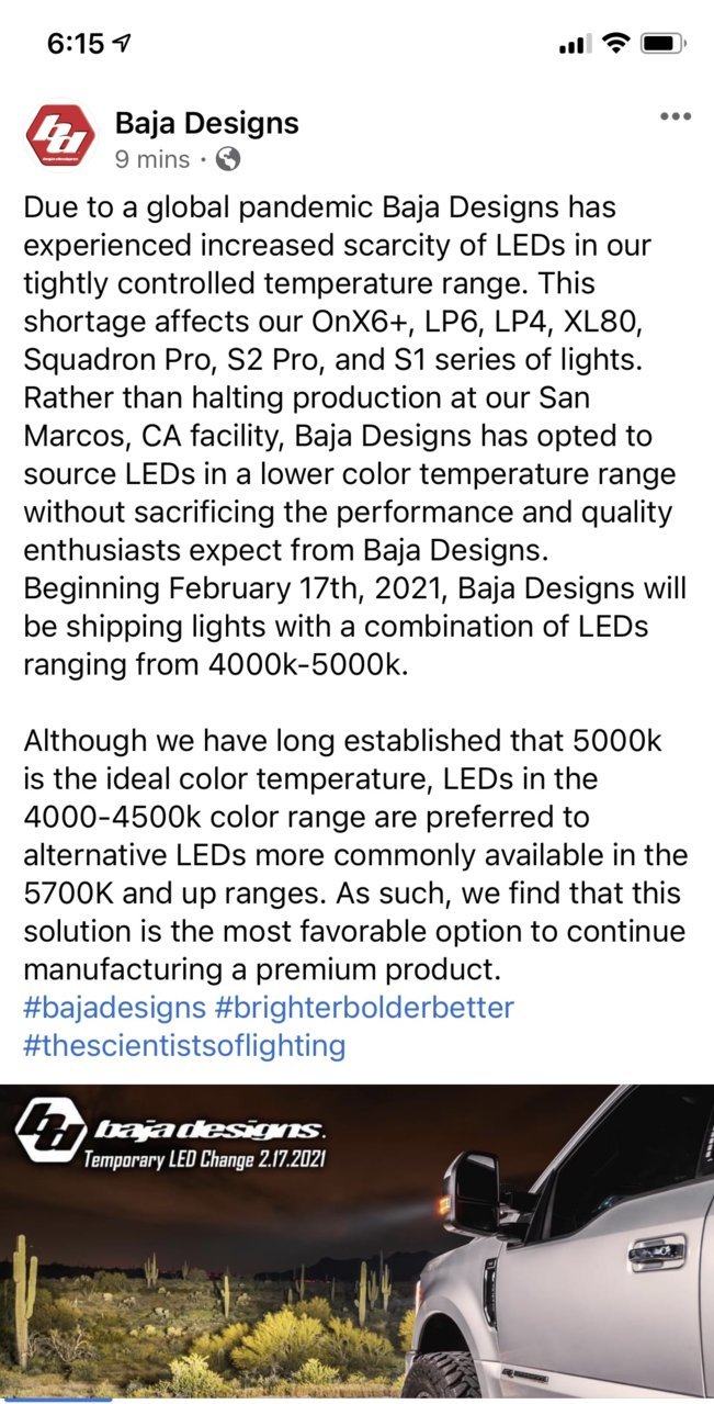

    So if purchasing multiple lights manufactured at different times, the color temperatures may not match. :confused:

    Yes, this is a possibility. For the majority of drivers the difference will not be too noticeable, especially in products that will get LEDs closer to 5000k. As some of you have stated, there are some advantages of the lower temps, and some of our desert racers and insiders actually prefer them for specific conditions. However, we do understand that many people are more sensitive to these variations. Anyone that needs their lights to match can stay tuned for our announcement sometime in the next 1-2 months. If for some reason, you absolutely need your lights to match and you need lights in the next month, shoot me a DM and I will see what I can do. Please only reach out if you have a professional or safety related need for the 5000K lights. I want to help, but also cannot justify an all departments on deck situation for anything less than a real world need.
    This solution is the best that we could think of that would allow us to continue building and shipping quality lights, rather than completely stopping production on half of our line. We apologize for any inconvenience, but hope you understand the reasoning behind the decision, as well as our announcement.
