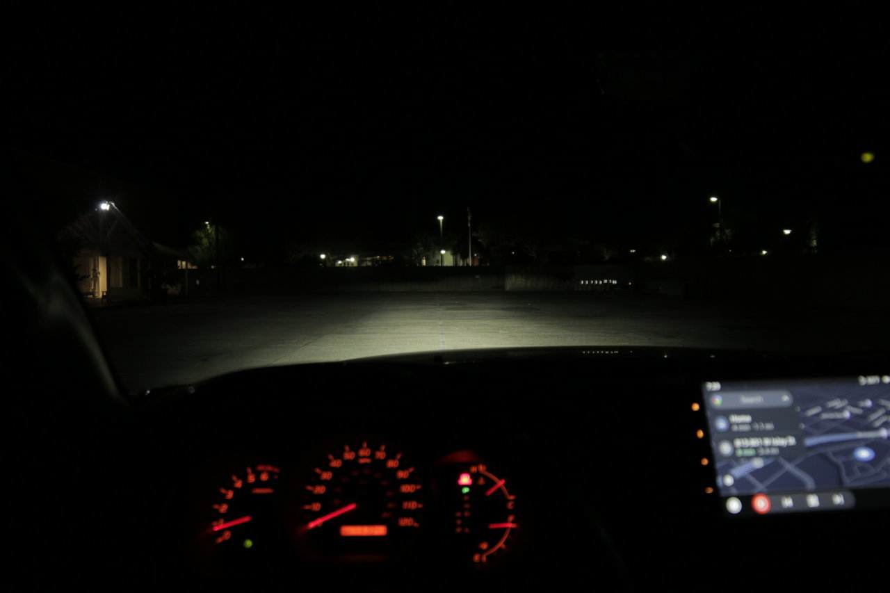

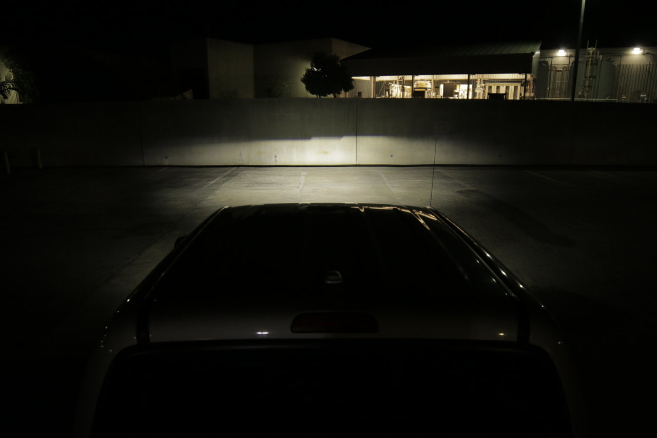

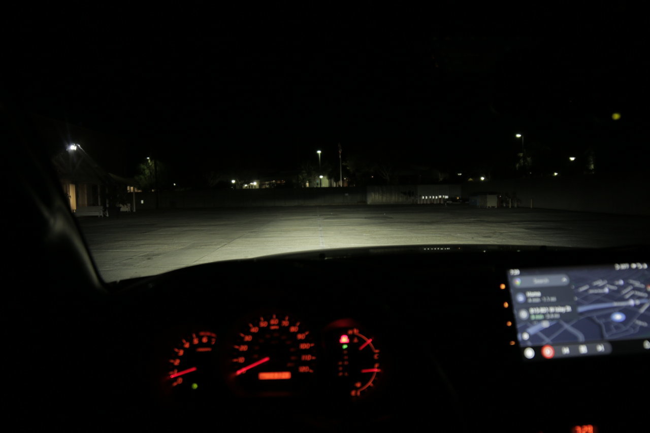

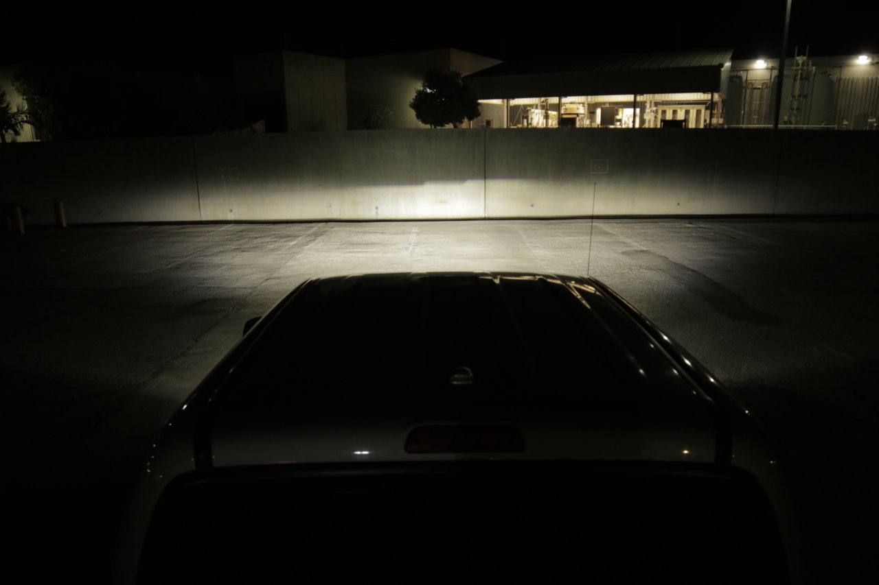

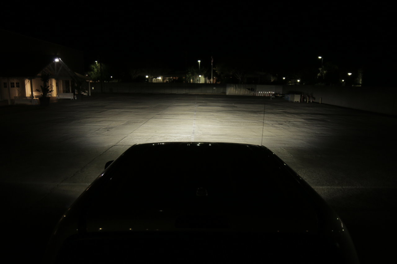

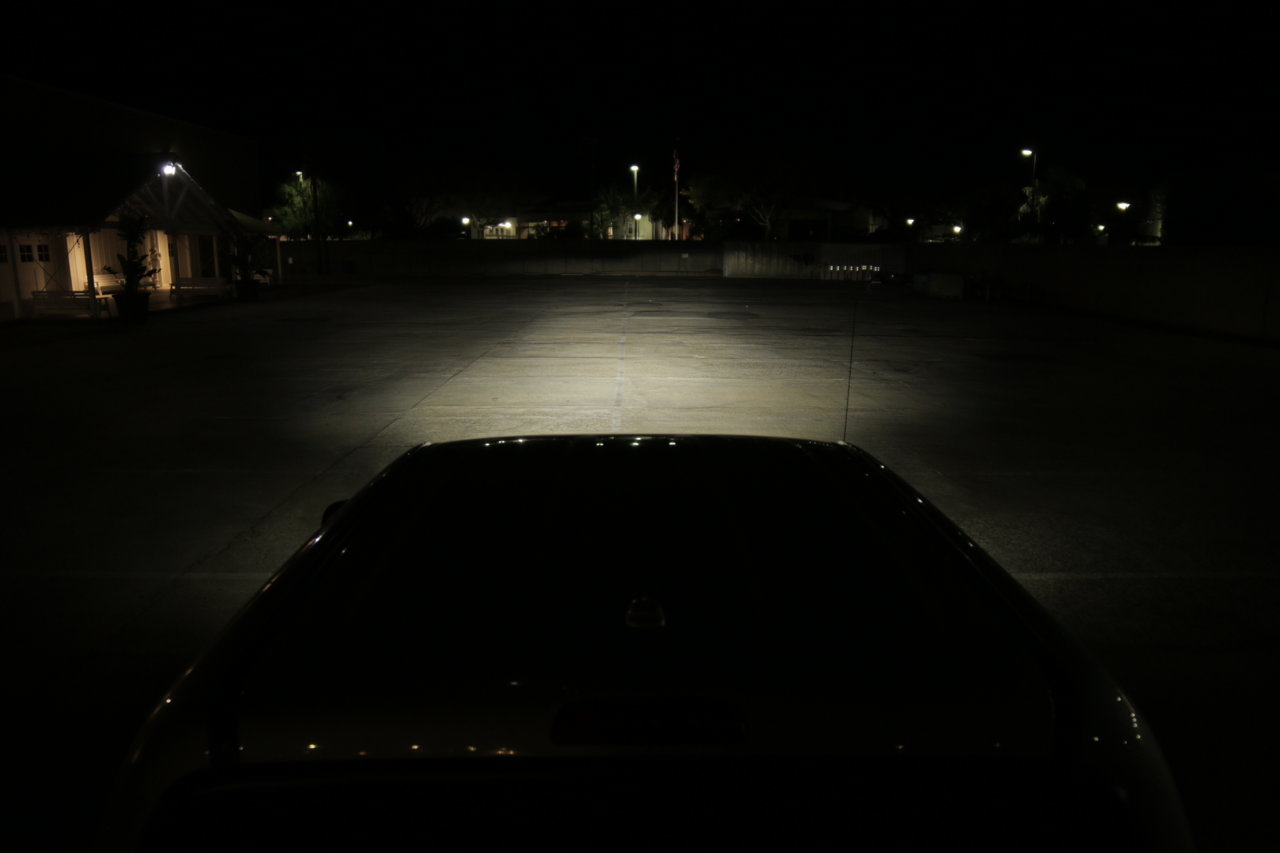

    Installed Diode Dynamics SS3 Pro fogs this weekend. I have adjusted the angle of the fogs the best I could (following the 25ft and 4"down method) . Camera exposure is the same for all these photos. Purchased from user @memario1214 and his website https://hotshotoffroad.com/ !!!!!!!!!!

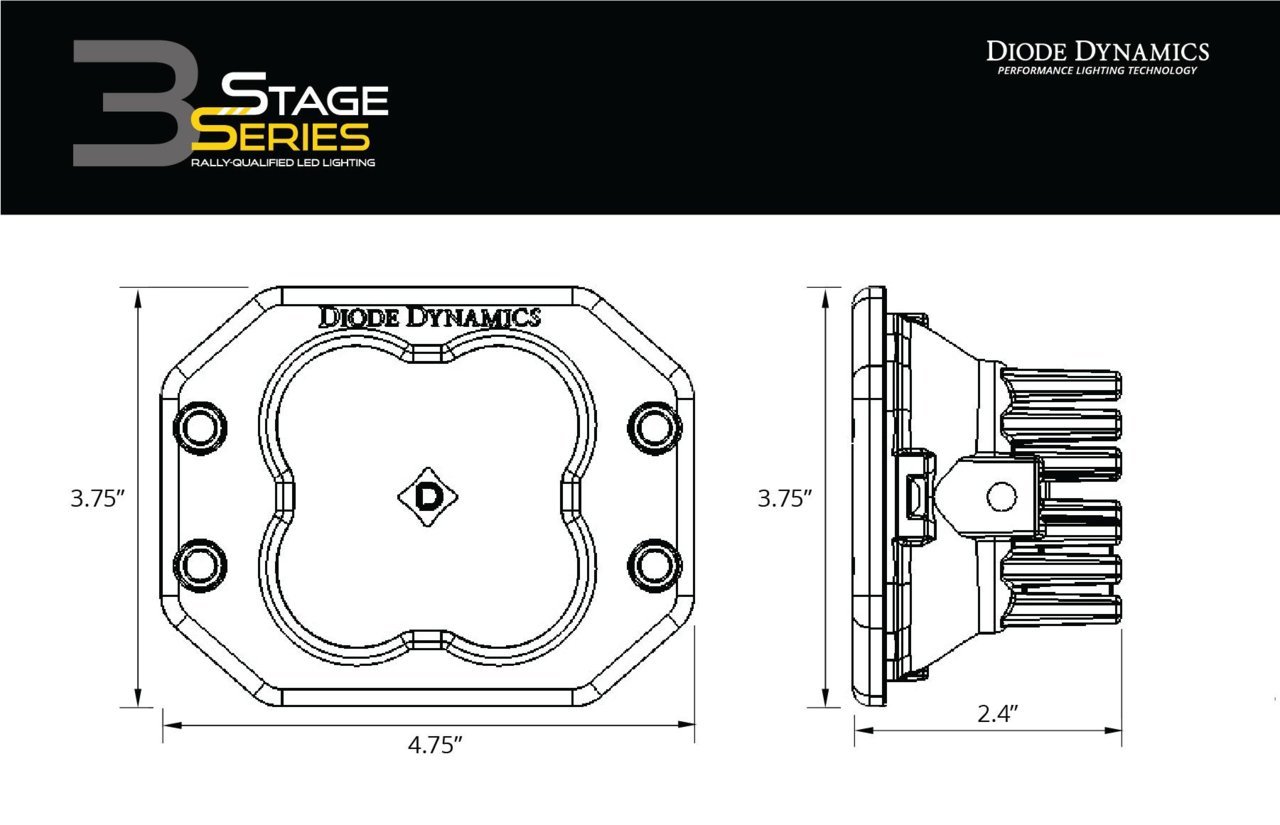

    Well just measured the square hole in my bumper, the SS3s won't fit. I have at most 3 5/8" and the SS3s are 3.8". So that leaves me at $300 Rigid ambers or back to my original idea of Offroad Towns.

    Or you just have the bezel of the SS3 sit directly behind/against the opening of the bumper. :notsure:
    The openings might not point them in the right direction given whichever bumper you have, but just a thought?

    The lights themselves will fit, it's when you add the mounting bracket. :rofl:
    It's a metal bumper....kinda hard to cut when a square tube has been welded in.

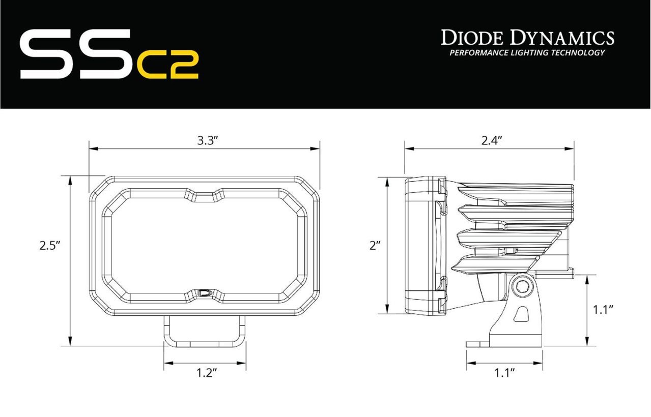

    How would the SSc2 compare when ordering the SAE Fog option in yellow?

    Compared to what... The SS3? The output pattern will effectively be the same, but from an aesthetic perspective I'm hesitant to put a rectangle in a square hole, but to each their own?

    Yes compared to the SS3s. Aesthetically, I really don't care. :rofl:
    If I can get similar performance as the SS3s at half the cost of Rigids, I'm ok with putting a rectangle in a square hole. I was looking at the SS3 Sports in SAE fog.

    Well I think that you're going to run into the same issue as the SSC2 is the same size width-wise as the SS3.
    Any thought to going with a flush-mount?

    The square tubes are angled so flush mount won't work. I'm fine width wise, the square tube has an ID of 3 5/8". It's the height of the SS3 with the bracket that won't fit.
