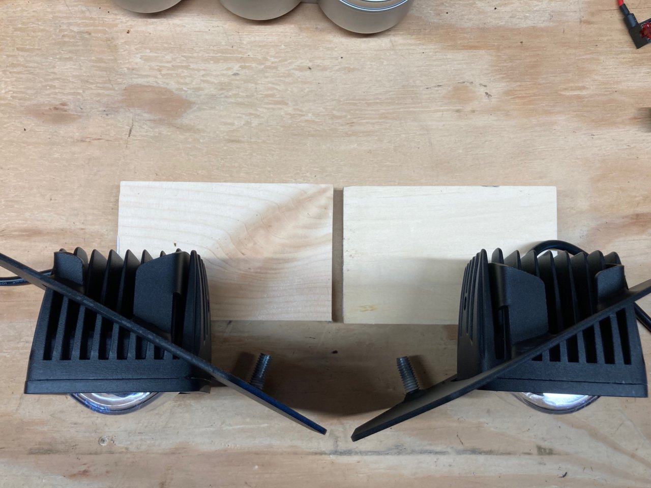

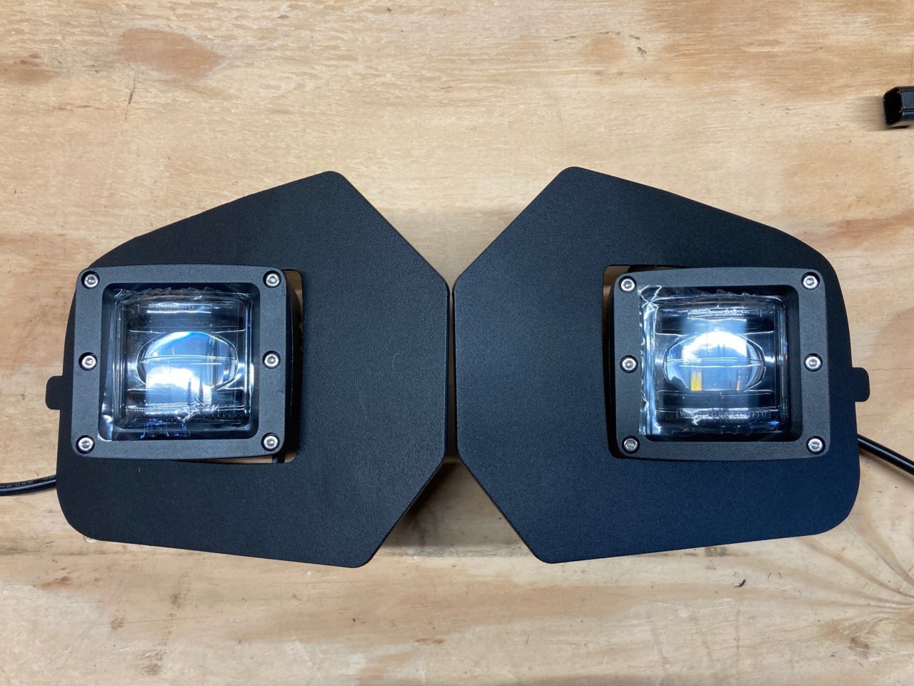

    Has anyone gotten the OffRoadTown fog pods to fit in the Cali Raised brackets? I can't seem to get them to fit.

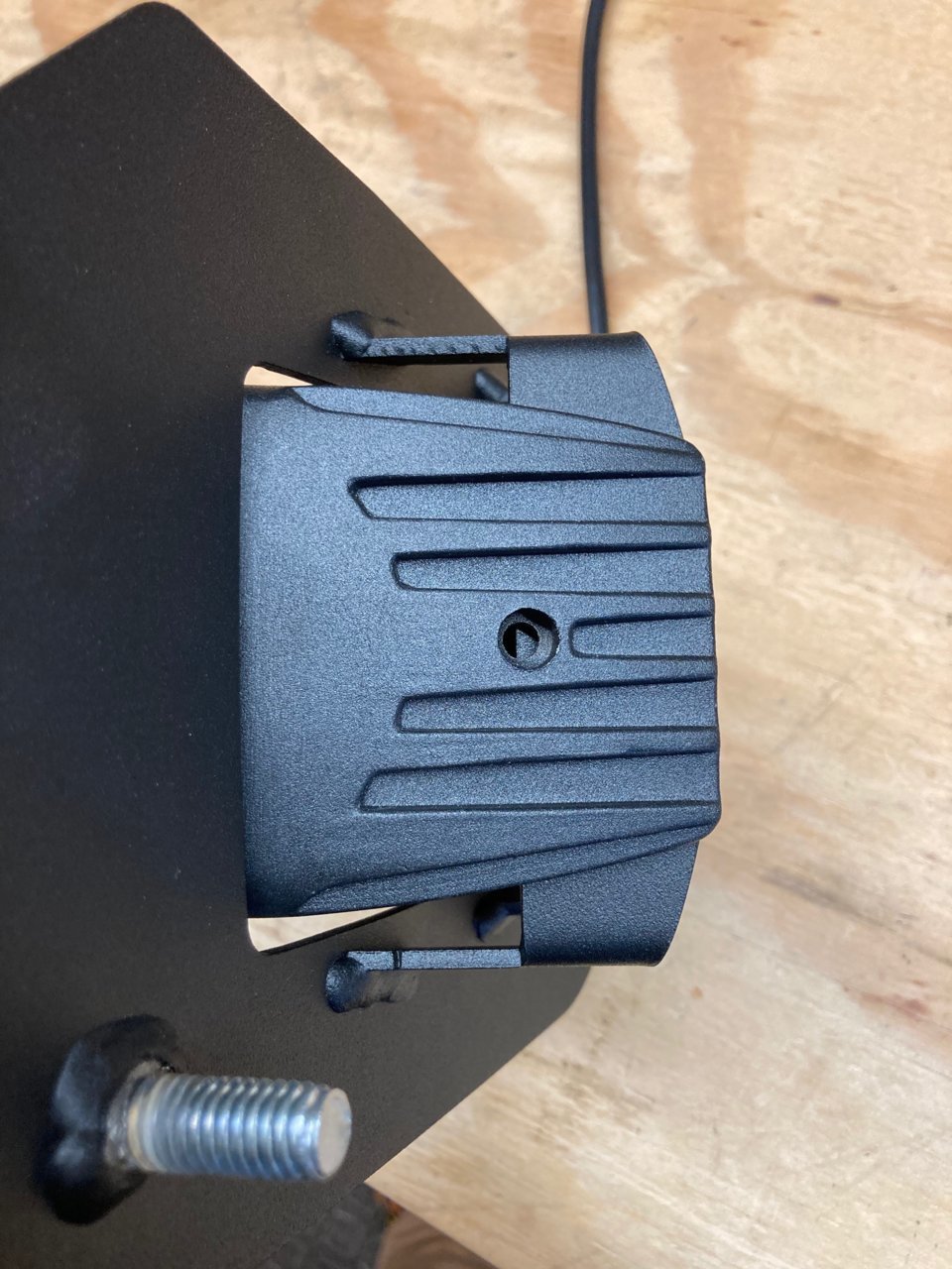

    Sorry, its been a busy week. I was just able to play around with this a little more and realized that the pod/bracket on the right side of the images fits just fine. The one on the left won't push into the bracket far enough to align the mounting holes (seen in third pic). I tried putting the pod from the right into the bracket on the left and that still didn't work, which leads me to believing that that particular bracket is the issue. Any tips or tricks to get it to work in there? Thanks

    Looks like a defective bracket. Is the pod body contacting the opening on the bracket not allowing it to go further in? If so you might try bending it away from that side with some pliers to see if that helps, and then paint any tool marks afterward. But given the bracket design and weld lines I'd give that a low chance of success. I'd look to get a replacement from Cali.

    Agreed. Yeah, the pod fins are contacting the bracket when pushed in. It seems like the bracket was just manufactured too narrow. Hopefully Cali Rasied can make it right. Thanks for the validation!
