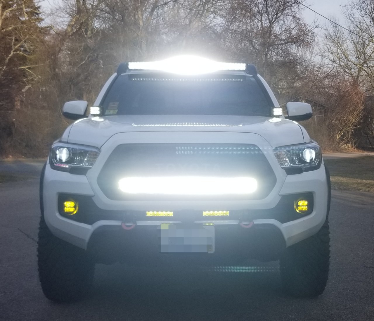

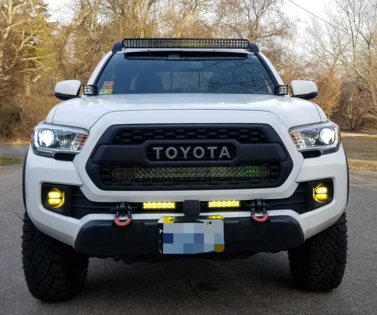

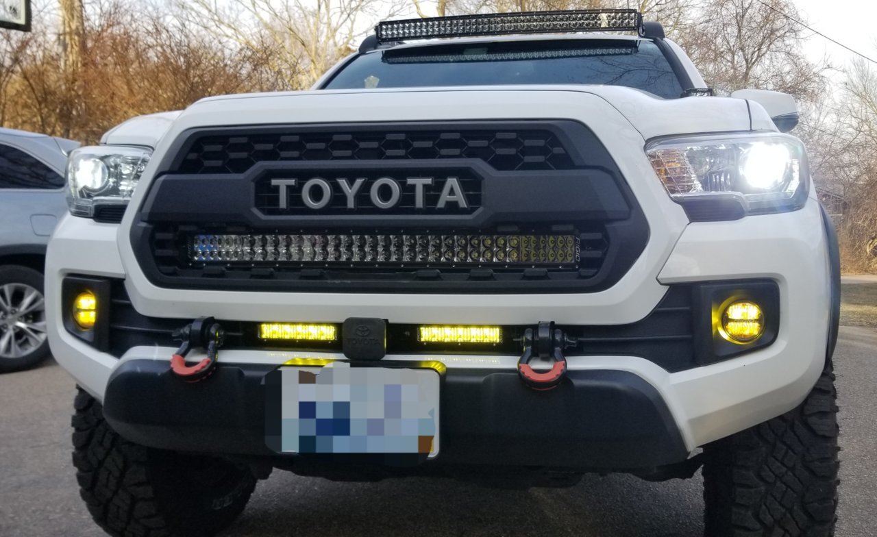

    20210313_145619.jpg 20210313_145704.jpg 20210313_145805.jpg Very happy with my Rigid 360 SAE fog kit + Rigid SAE 6" fog bars on a separate switch for those New England blizzards. Fit was perfectly and WOW those 6" SAE bars are BRIGHT!

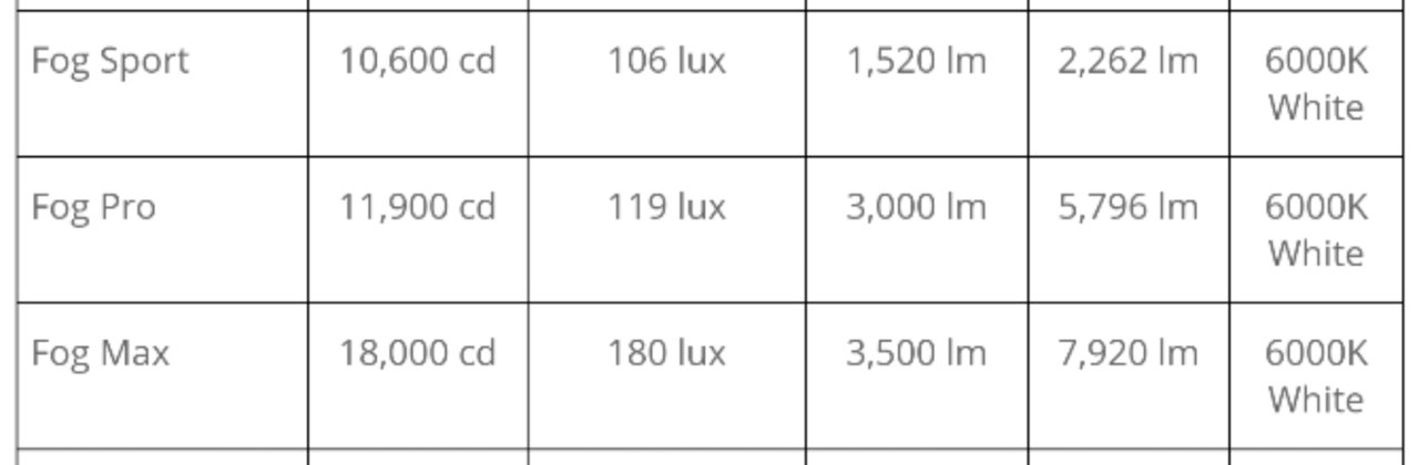

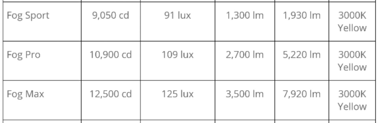

    I hadn't checked in a while, but the comparative specs for the SS3 fogs in yellow (including max) are here. Based on the numbers I'm not sure I'm interested in taking the leap from pro to max. I suppose there is an advantage in the sharper cutoff and being able to aim them further, but the intensity is not that much higher due to the color filtration.

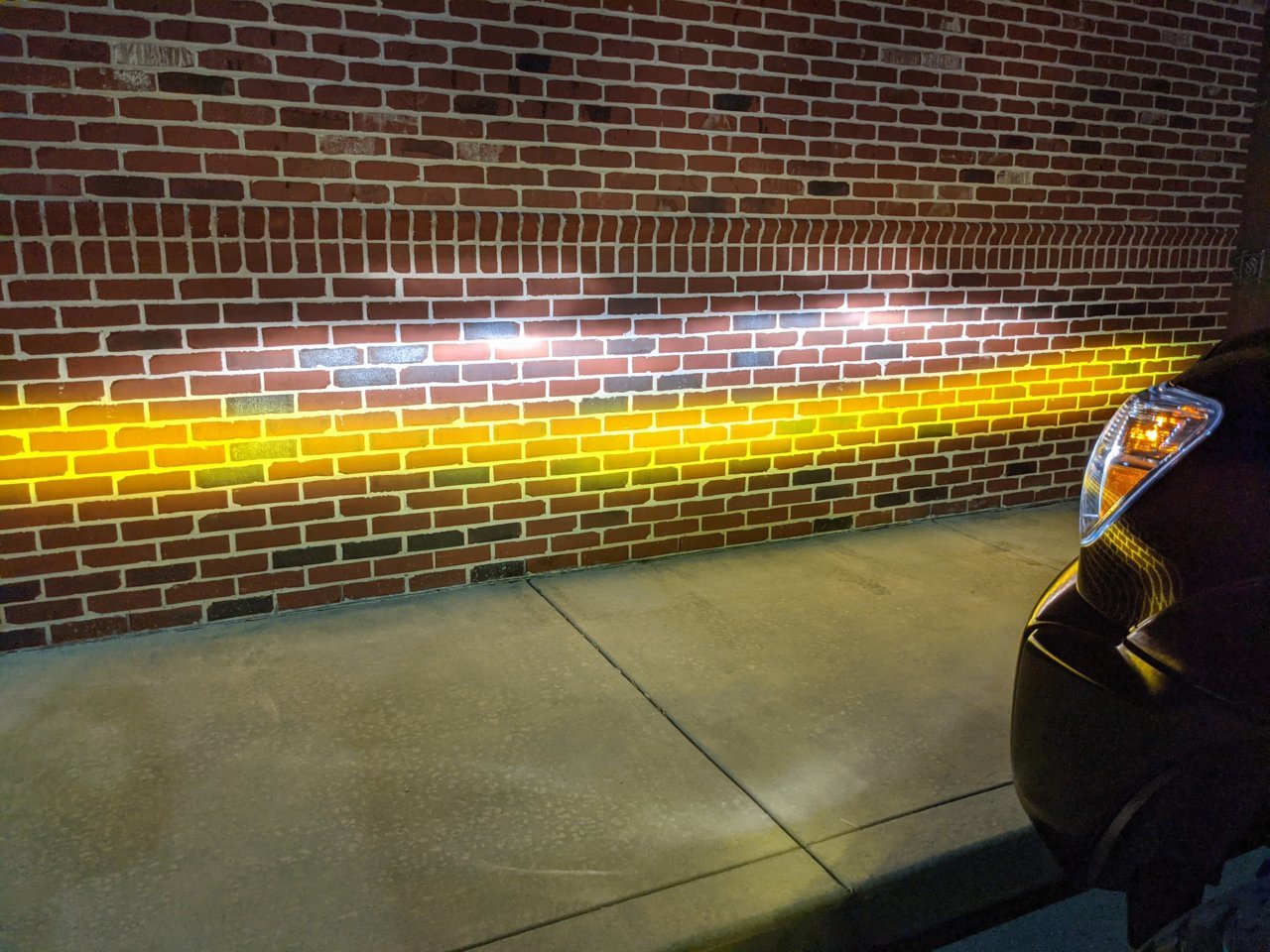

    Is there a way to flatten the curve of light from the SS3's, or is this just how the design of the housing is? I was wondering if adjusting them side to side a little would affect the "line" at all. Also, do you think mine are still aimed too high according to this picture? I haven't been flashed yet, but I'm trying to find the right balance of forward light combined with road illumination.

    I aimed mine 2-3 inches low from the height of the center of the pod, at 25 feet.

    you have a bit of wiggle room on the brackets to fine tune that outer upward curve. if this doesn't work then you can check the holes on the bracket that attaches to the bumper holes and see if you can fine tune that.
    also aim the fogs 25ft from the wall. the beam should be aimed 4 inches below the height of the fog in your bumper.

    Perfect, thanks! I will try the side adjustment next free day I have off and see if that helps with the curve. I will also properly aim them using the 25' rule of thumb instead of guessing at what I'm doing. :thumbsup:

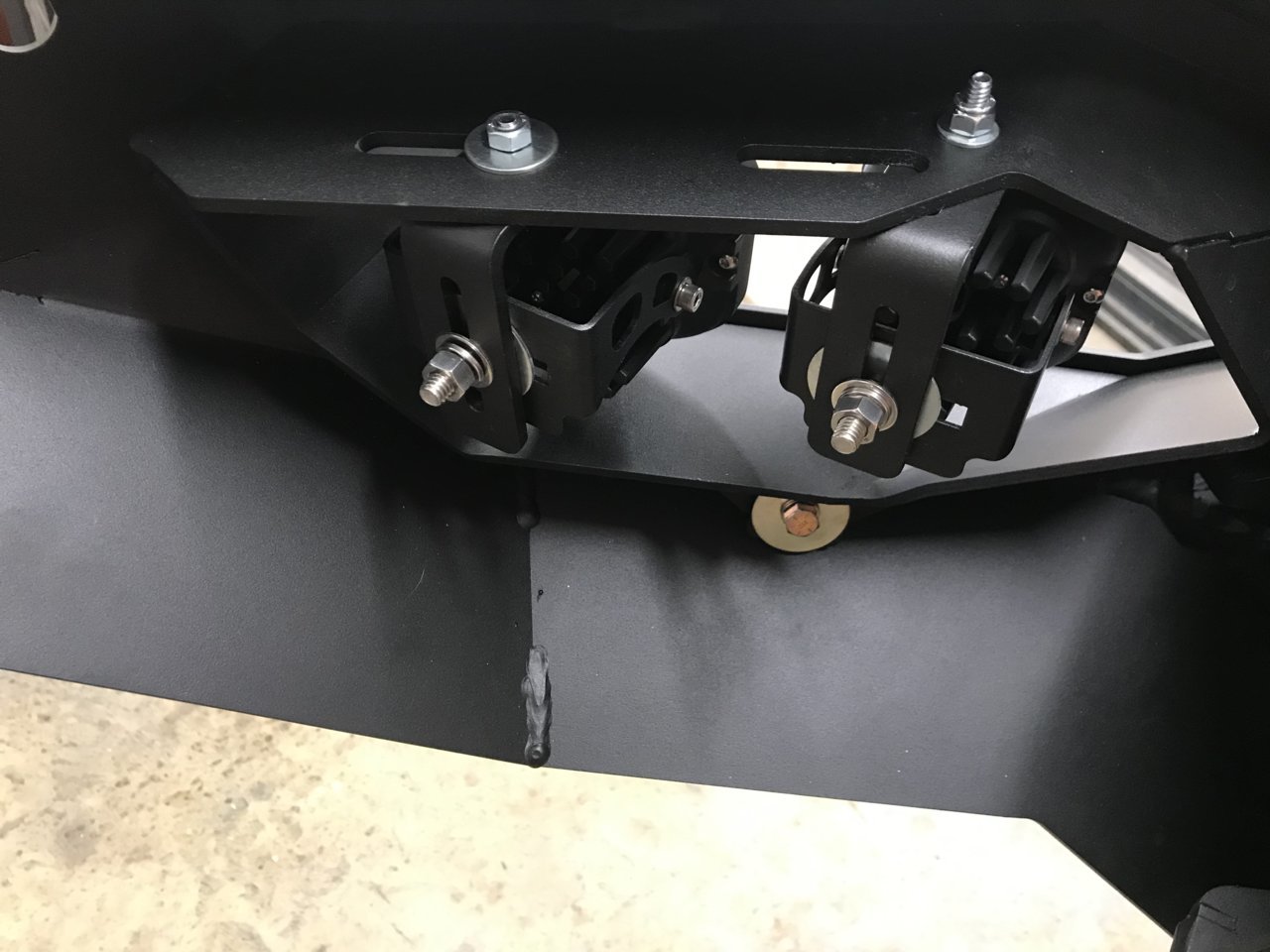

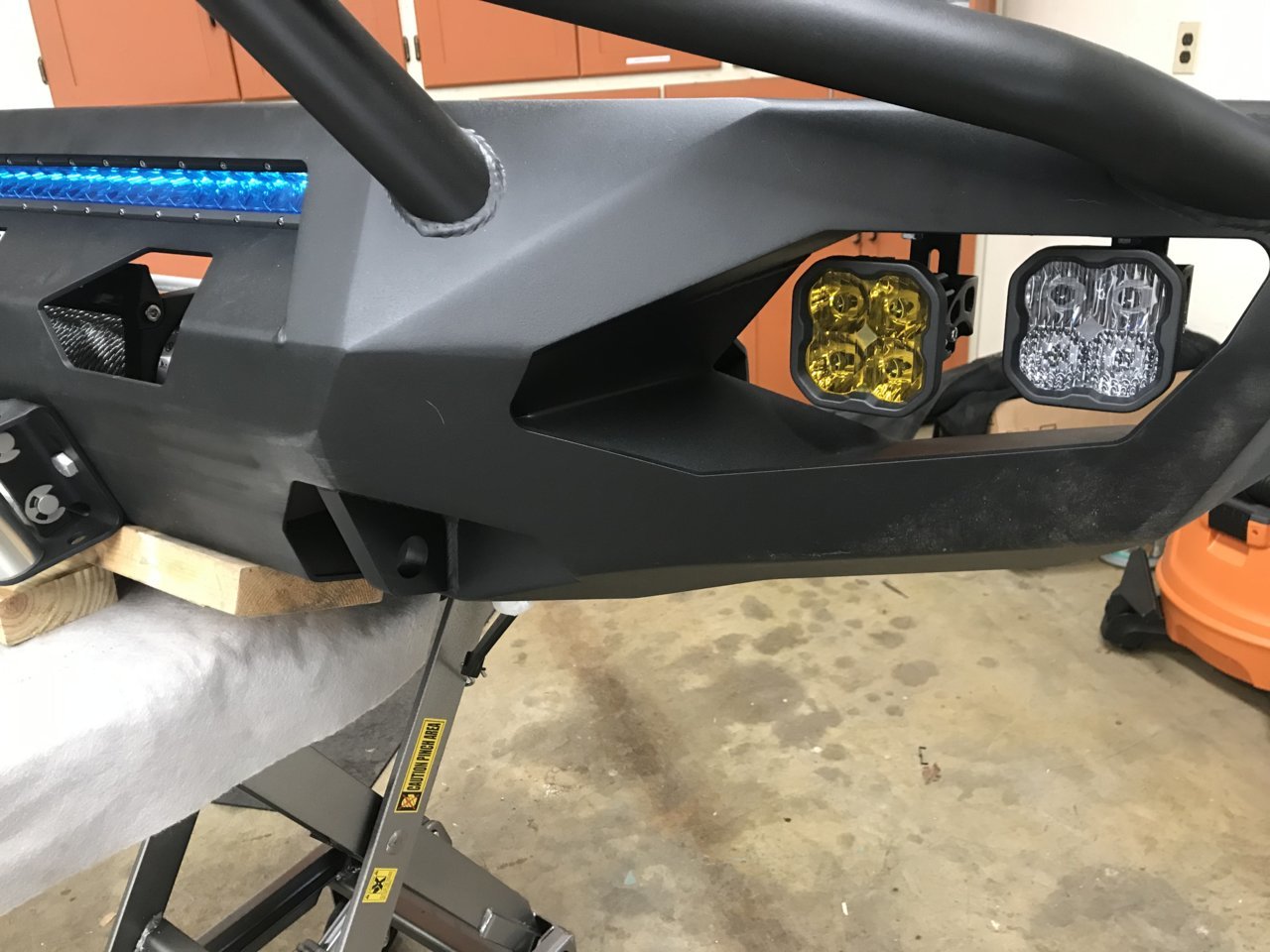

    Used this idea on my FabFours Matrix bumper with a Diode Dynamics’ SS3 Pro and Max pairing, @se7enine - thanks so much for the idea! Attached a couple mock up pix - I think the Max is upside down, but you get the idea.

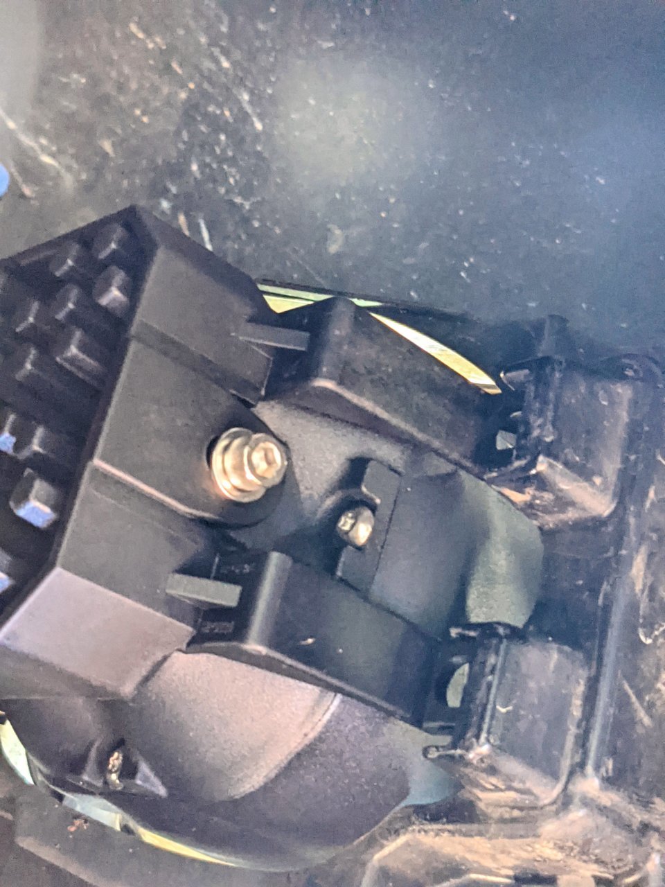

    Ok so I just went out and took a closer look at the mounts on the SS3's. Everyone has said that it's the top screw that you need to use for the 2nd Gen's, however when I moved the screw to the bottom location, the whole light adjusted to level and now the light line is flat. Maybe this is a redesign or possibly something is different on my truck, but using the BOTTOM screw only fixed the level problem. I tried to aim the height best I could for now at a shorter distance, but I'll double check it later tonight when it gets dark at 25 feet.

    Possible that the mounts are flipped?

    The way I have it mounted is the two even length tabs on the fog mount go into the retention holes of the bumper, and the other side is where the screws mount. The longer one is on the bottom I believe. I really don't see how they could mount the other way because the tabs go into the retention holes just like the factory fogs do. It's all leveled up and fitting snugly now, so I don't know.

    This is the driver's side. The even tabs as shown butt up to the side of those holes giving it an even mount. If I were to flip it, then I wouldn't be able to do that.

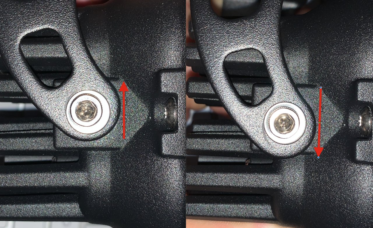

    Here is a copy/paste from my review post mounting the SS3s on a 2015 2nd Gen. If you can verify your mount is level, that is all that matters. Using the bottom mount for me cause significant tilt.
    Since the screw mounts don’t both align, you need to use a single screw to mount, like 3rd Gen. Even though the stock 2nd Gen used 2 screws, 1 should hold fine.
    The lower screw is not the right one, this results in the light not being level left to right.
    The upper screw is the correct one.
    So for 12-15 Tacoma’s installing the SS3, be sure you only use the upper screw mount on the bracket for the SS3s. Using the lower screw location or attempting to use both will result in a non-level light pattern.
