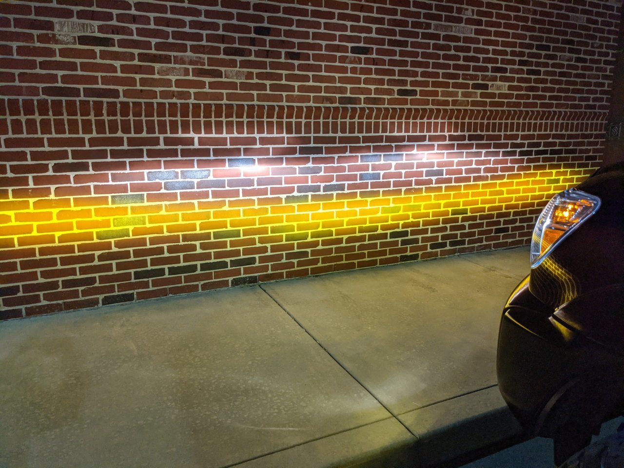

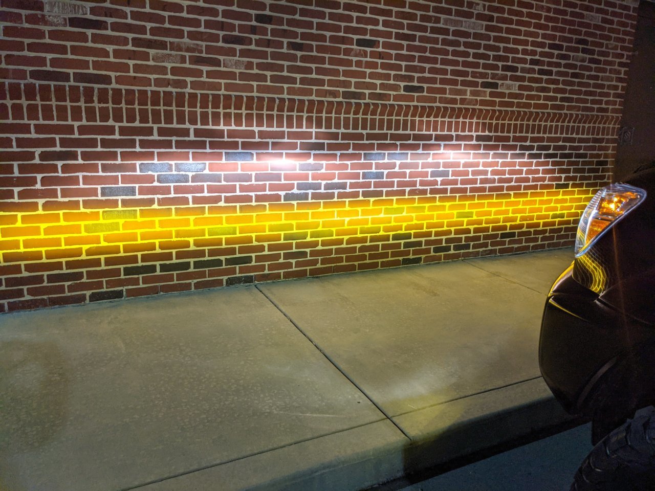

    I didn't put a level on it but confirmed it being flat by shining the lights on my garage door. I used only one screw as well, however I used the lower mount, not the upper one. I did the top one first based on recommendation however that is what was throwing it off level. The whole assembly fits much better behind the factory plastic bezel. This is what worked for me so I'm going with it. I'll take a picture or two tonight for comparison.

    No sir. Assuming you have the SAE fog pattern follow this photo and you'll be GTG.

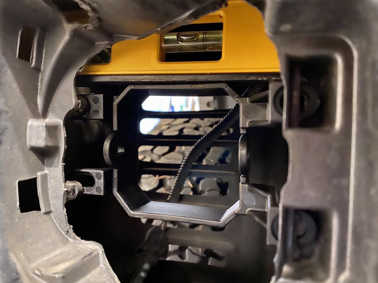

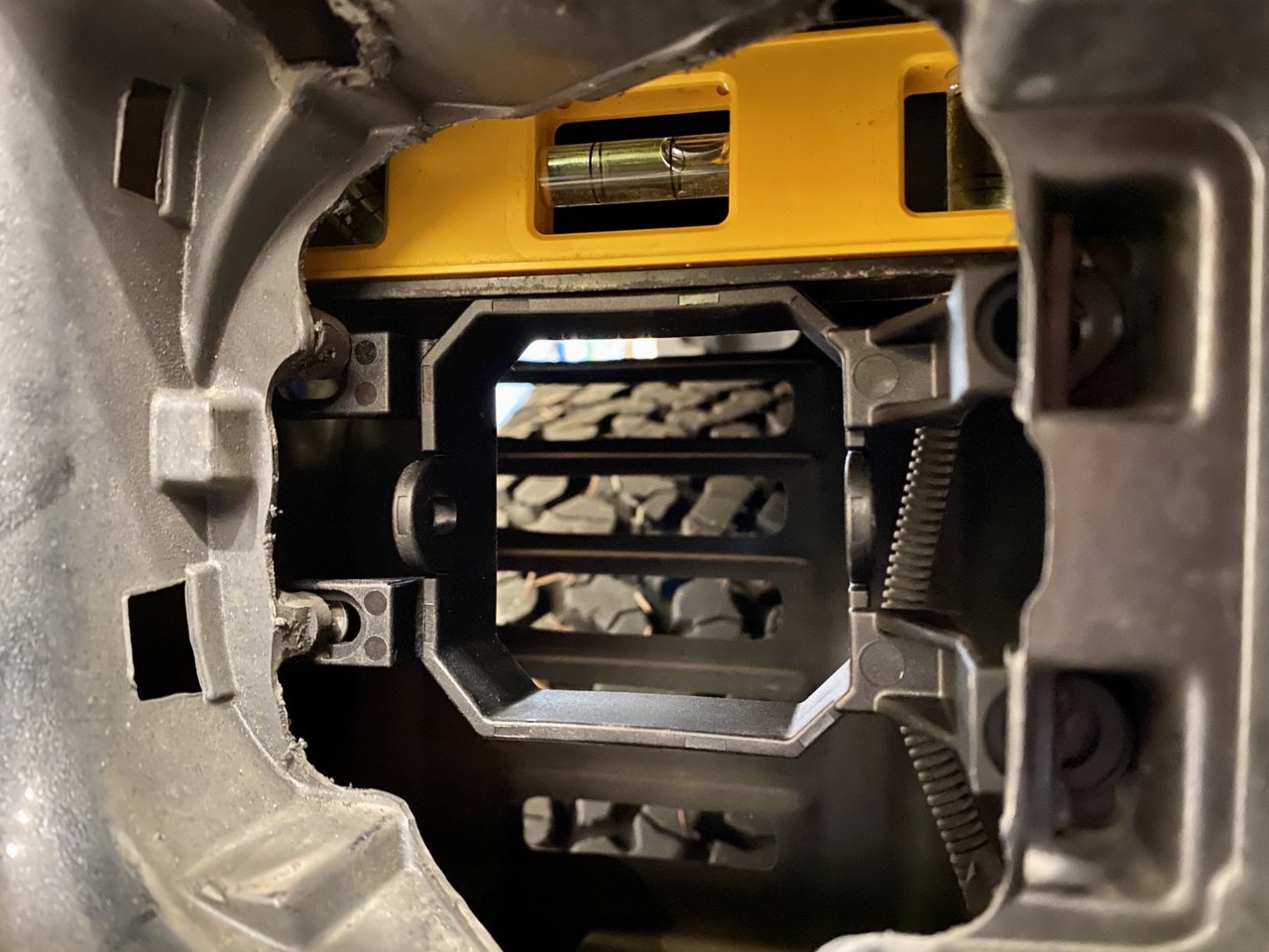

    The top picture was taken tonight. The only side to side adjustment I made was remounting the fog with the single screw on the bottom tab mount opposed to the top tab mount like in the bottom picture. No adjustment was made to the side screws, however it probably would even flatten it more. I doubled checked the aim height too and it's pretty close to where it needs to be.

    The brackets are side specific, maybe you have them flipped.

    Perhaps, but it's working now. Can you tell by the picture in post #4729 if it appears to be flipped? This light was on the driver side. I just don't see how they could work any other way than how I mounted them.

    My truck had taco lean. Now I am questioning whether using the upper mount just countered the taco lean to level the lights despite the tilted truck, whereas if your truck is level (without taco lean) maybe the lower mount is the correct one to level the lights with a level truck. Hmm.
    Edit: No. This can't be right, since the lower mount caused my level to go up to the driver side. If it was Taco lean it would have gone up to the passenger side. Disregard.

    I may very well have installed them wrong, but they still turned out right. If I flipped the mounts and switched them to the opposite sides using the top screw mount, it probably would equate to the same thing. Just a thought.
