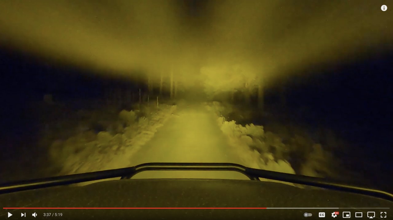

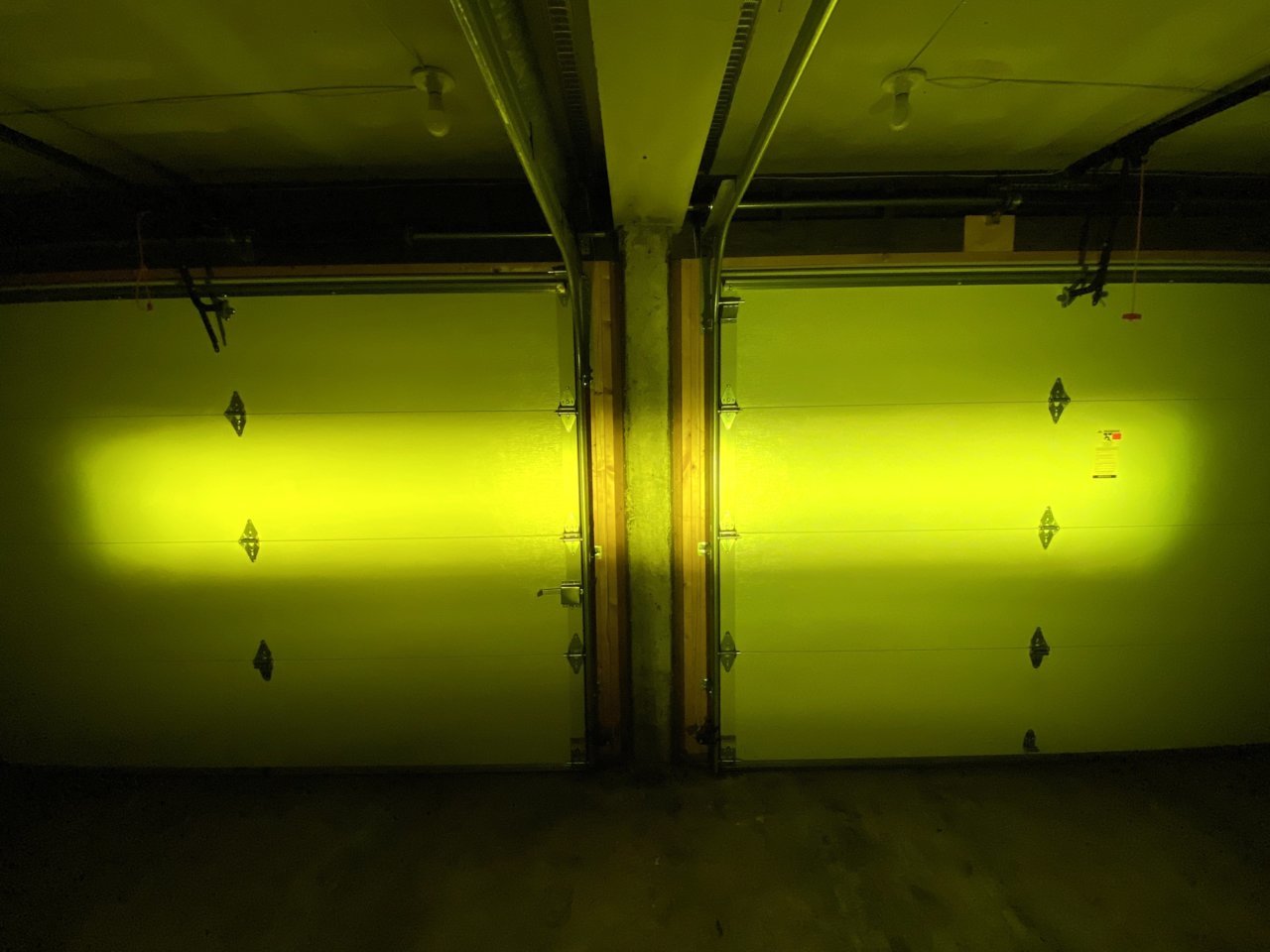

    I've seen a few videos of individual lights, but trying to compare different lights operating under real world conditions driving in an uncontrolled environment in poor weather is going to be extremely difficult to have a useful comparison.
    Here are some screen shots from a KC video comparing KC Pro6 light bar in 5000k vs their amber lens in fog. Not fog lights and not selective yellow, and being in an uncontrolled environment it isn't a perfect comparison, but will give you some idea.
    5000k
    Amber
    Video link:
    https://www.youtube.com/watch?v=XQheqka2veE&t=224s

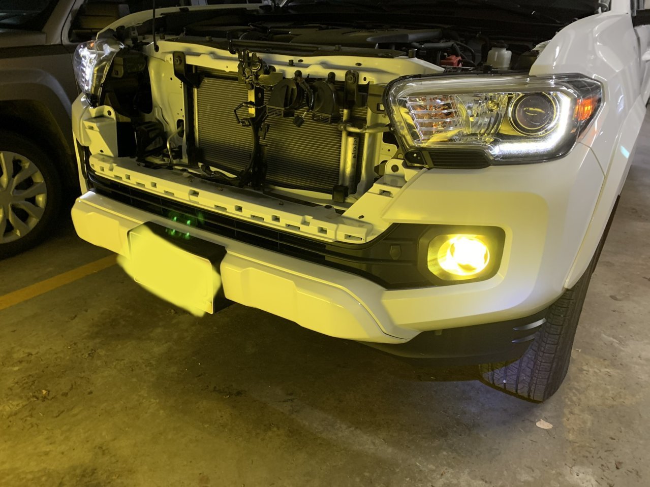

    So, I installed the DD SS3 Sport Fogs today on my stock 2020 TRD Sport.
    I watched 2 methods on how to install these on YT for the 3rd Gen Taco. You can install either via the wheel well or remove the grille. I decided on the grille removal method. Was amazed at how easy it was to remove the grille to access the OEM fog's. Had only basic tools, my 7 y/o son and a dimly lit underground parking lot to work in.

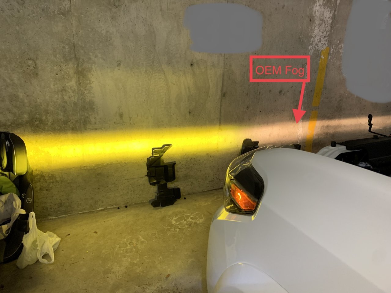

    Followed @crashnburn80 aiming advise by tightening the fog brackets to about 90% and then installing one DD Sport at a time. Then simply matching the OEM fog alignment. Once aiming was complete I simply went back with the Allen key and tightened them up so they would not move anymore. Then re-installed the grille.
    The fitment of the SS3 sports was fantastic on my truck and I'm very happy with the looks and more importantly the functionality as I live in a very rainy, dark and dreary area of Canada (Vancouver).

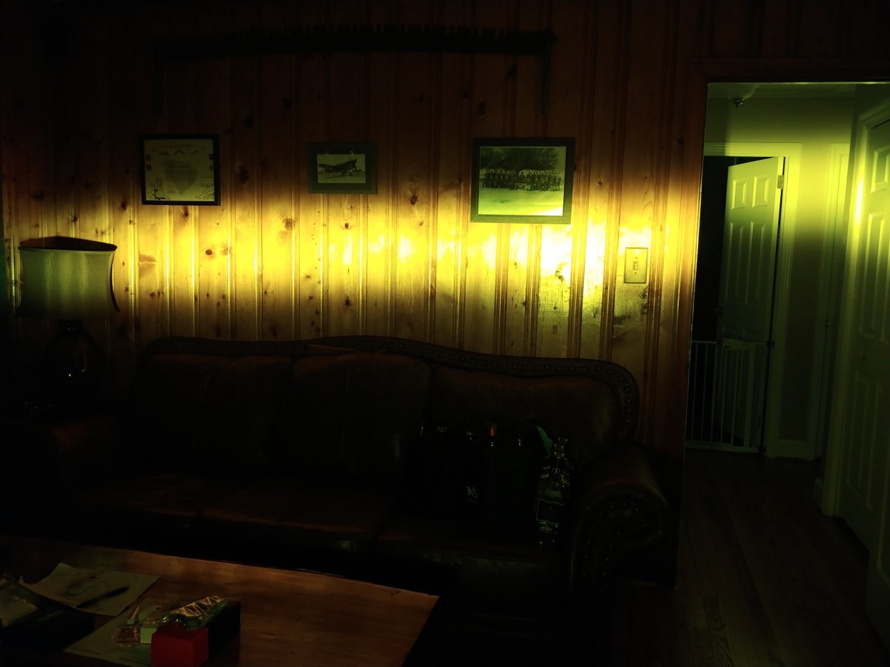

    Got my SS3 Sports in today. Hope to install them this weekend. Damn they're bright! And this is just hooked to a little 12v tool battery.
    Thanks again @memario1214

    Wait till you get them installed and properly aimed! Of course getting them out of your living room will help too.

    :yes: I'm not the only one that runs vehicle lights in my house!
