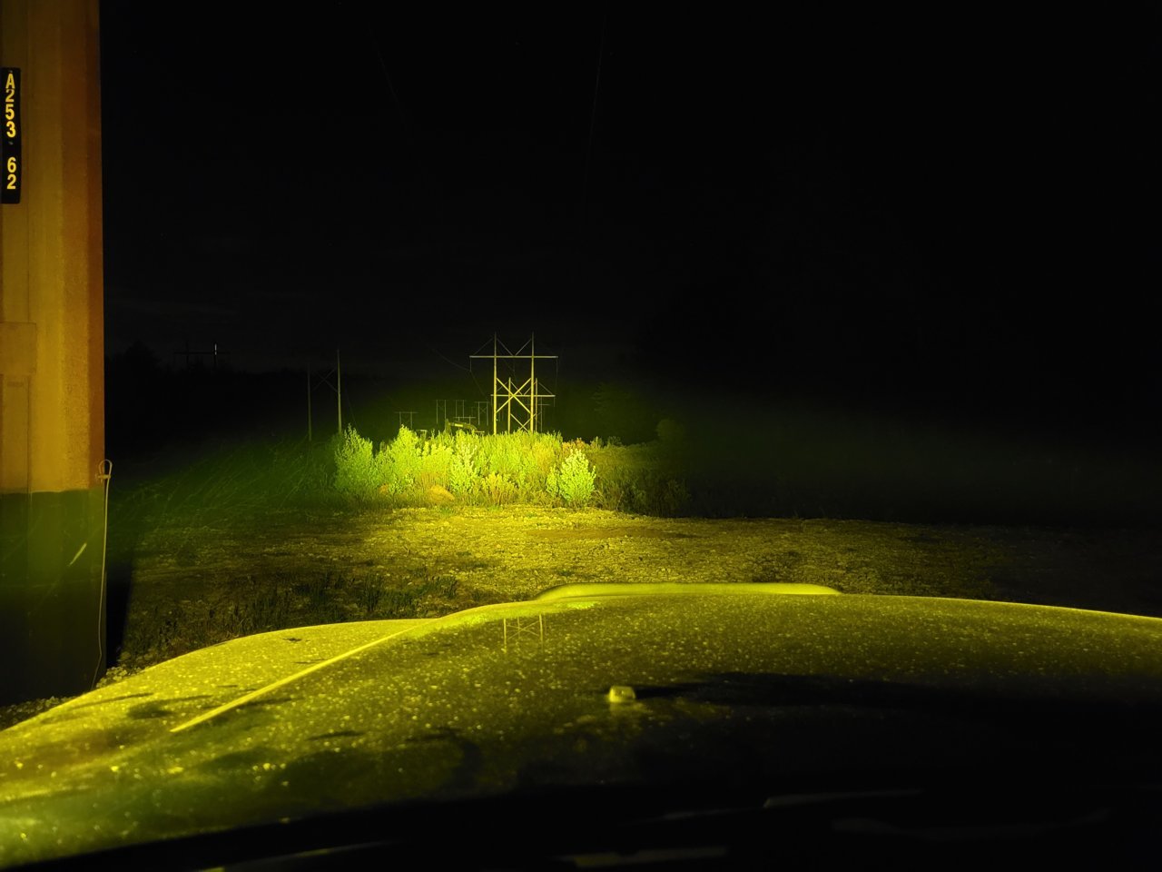

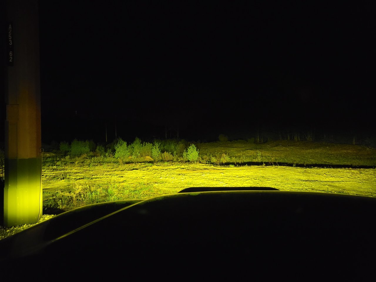

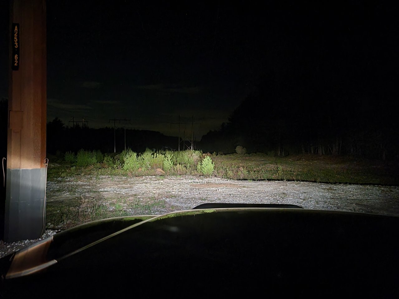

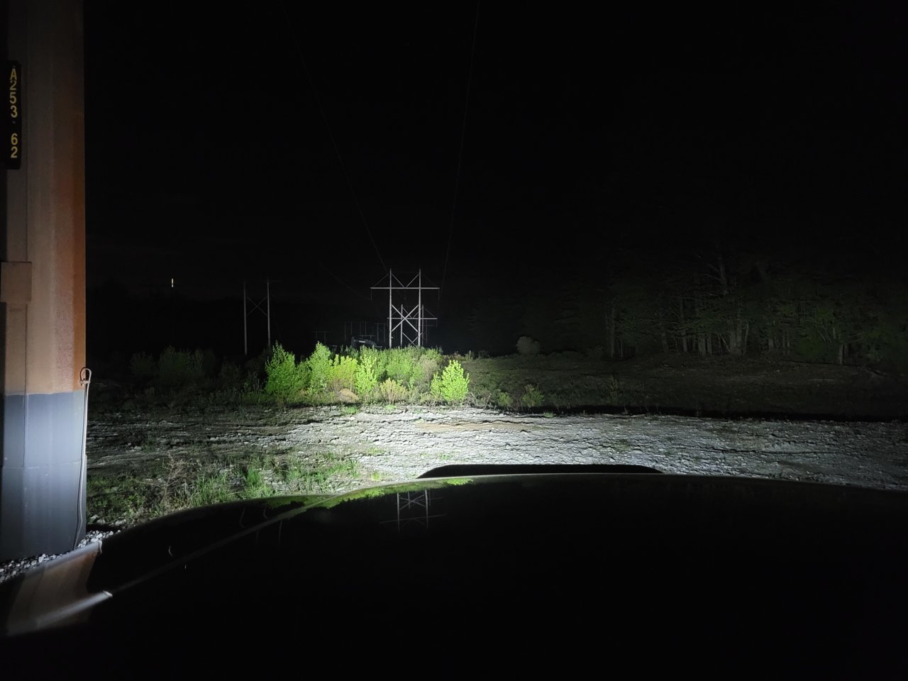

    LED impromptu testing - cell phone photos sorry nothing fancy on my end...
    Photo 1 - Headlights (halogen visionx)
    Photo 2 - Diode Dynamics SS3 Pro bumper mounted Fog Wide lens pattern
    Photo 3 - Diode Dynamics SS3 Pro windshield mounted Driving lens
    Photo 4 - Diode Dynamics Series Stage 18" bumper mounted Driving center / Wide outer combo
