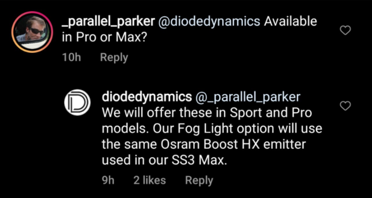

    According to DD, the SSC1 fog optic is also the only one that is using the Max (Osram HX boost) chip.
    The rest are using the standard sport/pro chips.

    Very close! The SSC1 Sport uses a 10W chip used in SS3 Pro. The SSC1 Pro uses a new 20W chip. The SSC1 fog uses the Max chip which is a highly-focused 20W chip. It's not higher power than the Pro option, so we're not calling it Max. It just provides more focus, to create the SAE fog pattern. It's also more expensive than the less-focused 20W chip, which is why the SAE option is more expensive.
