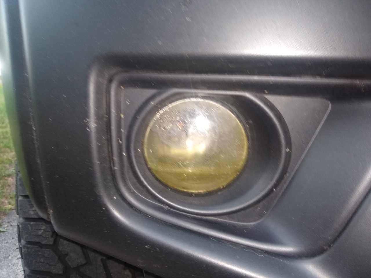

    I decided on the sport fogs but no sure what pattern. I really need a boost when driving off road in snow.

    If you’re replacing your stock fogs I’d probably recommend the SAE fog pattern in the yellow color.

    I should have read this before purchasing these last fall. My sr didnt come with a harness and my relay is shot thanks for the post

    In snow you’ll want at least the Pro to prevent them from icing over. Pattern is going to depend on where you are looking to see better off road. Best pattern for snow use would be an SAE fog, and selective yellow would be the ideal color. But if you are looking to improve your distance lighting, that won’t help much. But distance lighting is inherently problematic in the snow.
