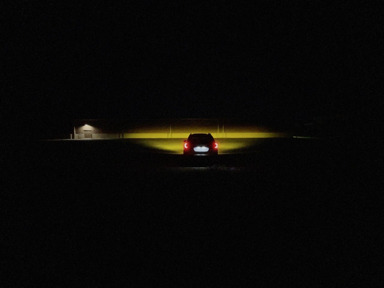

    Not the greatest comparison but here are the SS3 Pro vs SS3 Max. I don't have any driving shots of the Pro's, but I think you can tell the difference.
    SS3 Pro SAE Fog Selective Yellow. Wall is 100ft away, headlights off, the aim was a little high when I took the photo and they are aimed lower now.

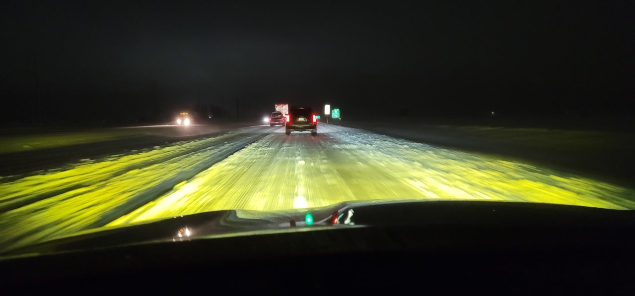

    SS3 Max SAE Fog Selective Yellow. This is obviously while driving during a pretty good snow storm. The Max, even in yellow almost completely drown out the headlights (OEM Subaru LED). They are absolutely amazing fog lights!

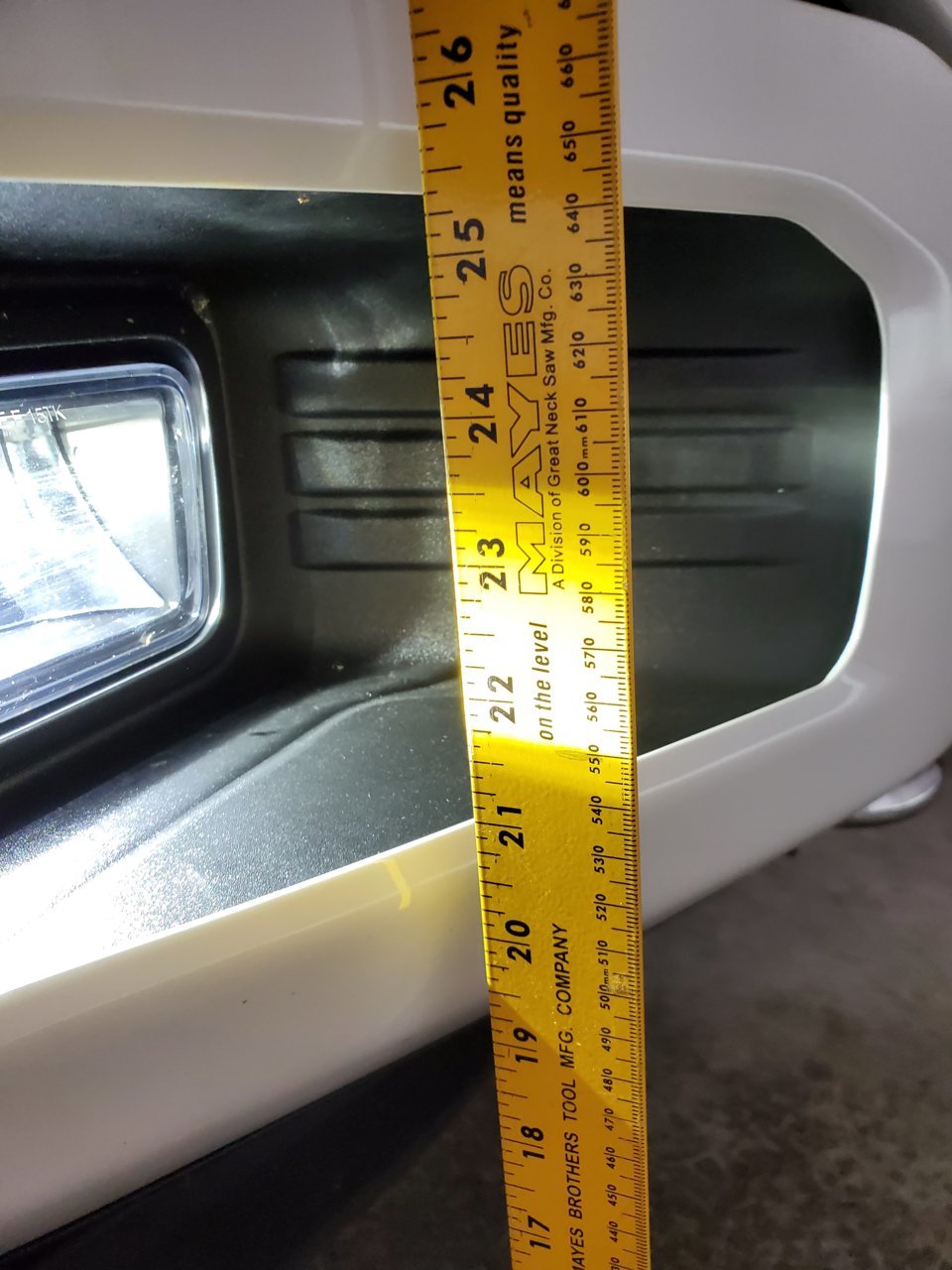

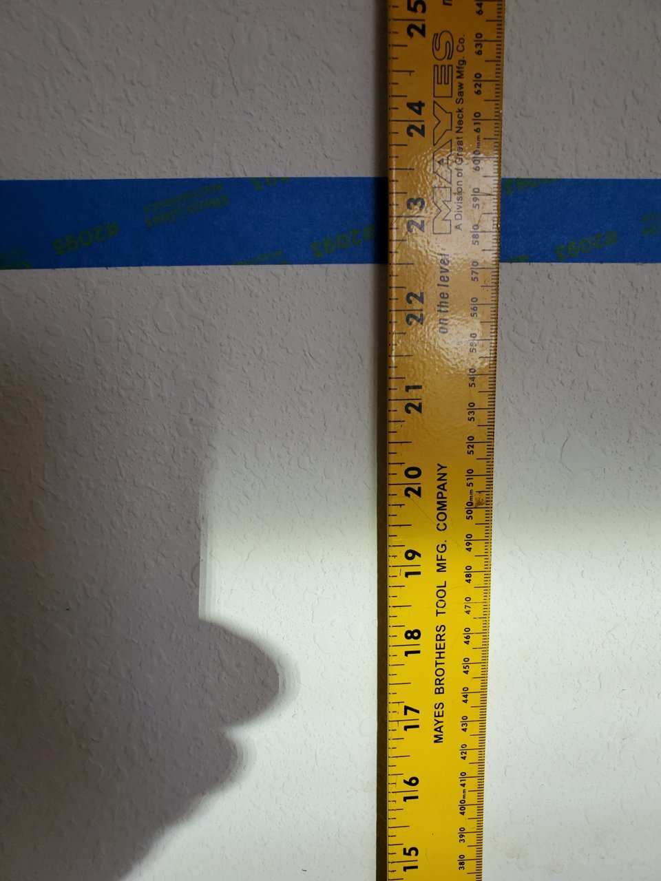

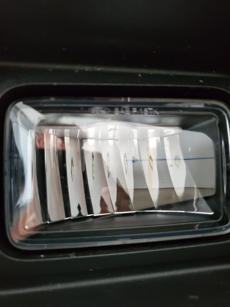

    Before (or actually if) I make any comparison shots with the new SS3 max selective yellow fogs I need to take a minute and adjust the factory fogs. Pictures should show the LED is in the top of the housing and reflecting out. Top of lense is 24", hot spot coming out is at 23.5" and cut off on the wall is at 19.5" . Now I think that would be right if the wall was 25' away but it's only 6' away. So, is the drop linear, 4 inch at 25 feet equal an inch at 6 feet???

    Yes the drop is linear. Precision is less at short range, 12’ 6” with a 2” drop would be better. Otherwise 6’3” is the distance you’d want for a 1” drop.

    I know that I'm over thinking this. Do I take the drop from top of lense, the hot spot line at 23" or the cut off at 23.5"?
