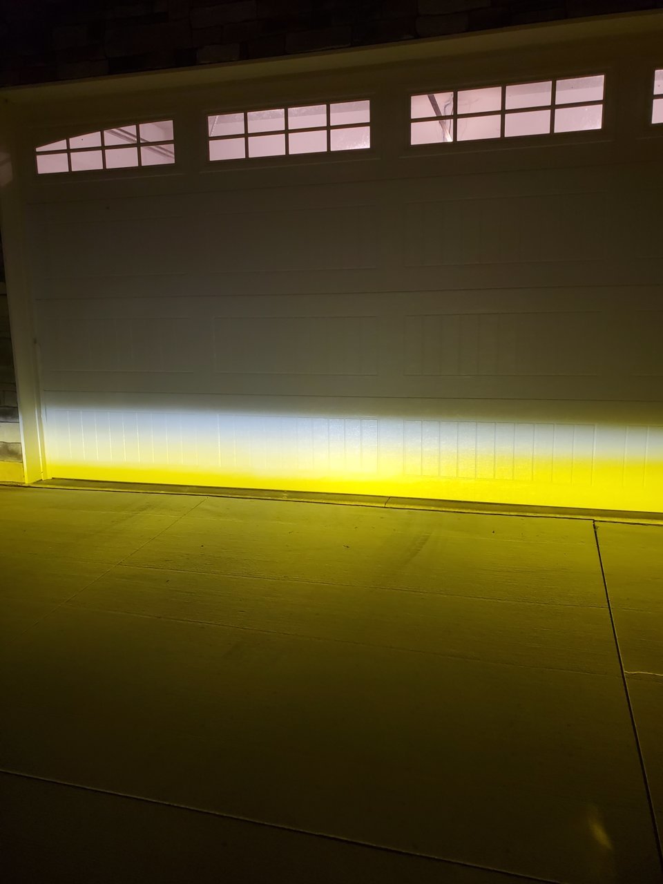

    Yes the drop is linear. Precision is less at short range, 12’ 6” with a 2” drop would be better. Otherwise 6’3” is the distance you’d want for a 1” drop.

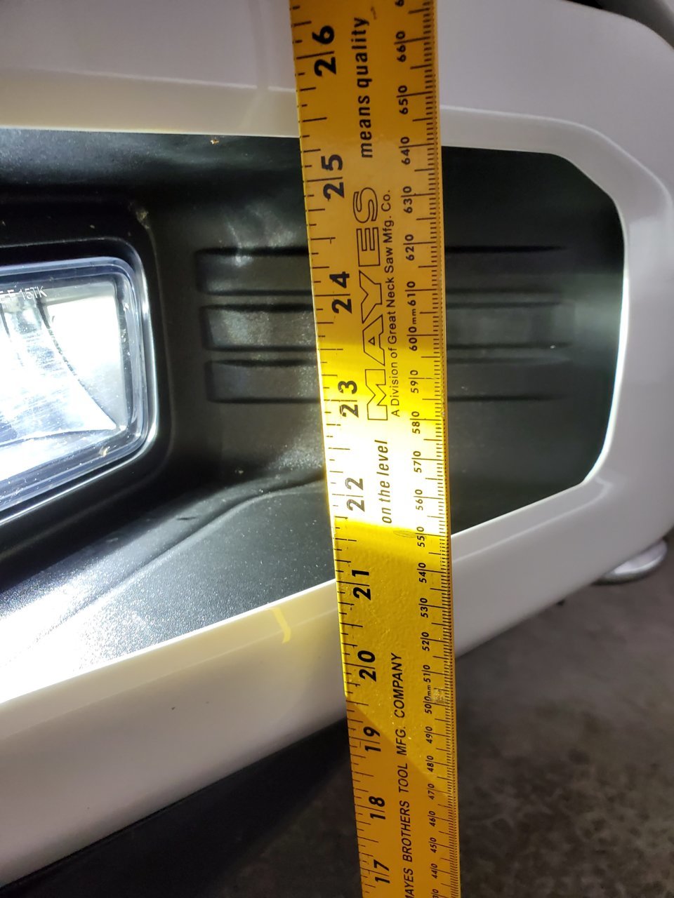

    I know that I'm over thinking this. Do I take the drop from top of lense, the hot spot line at 23" or the cut off at 23.5"?

    Top of lens to the cut off line on the wall is typically how it is done. But if you wanted to use the cut off at the lamp to the cut off on the wall that would be even more accurate. Hot spots are not used for aiming fogs.

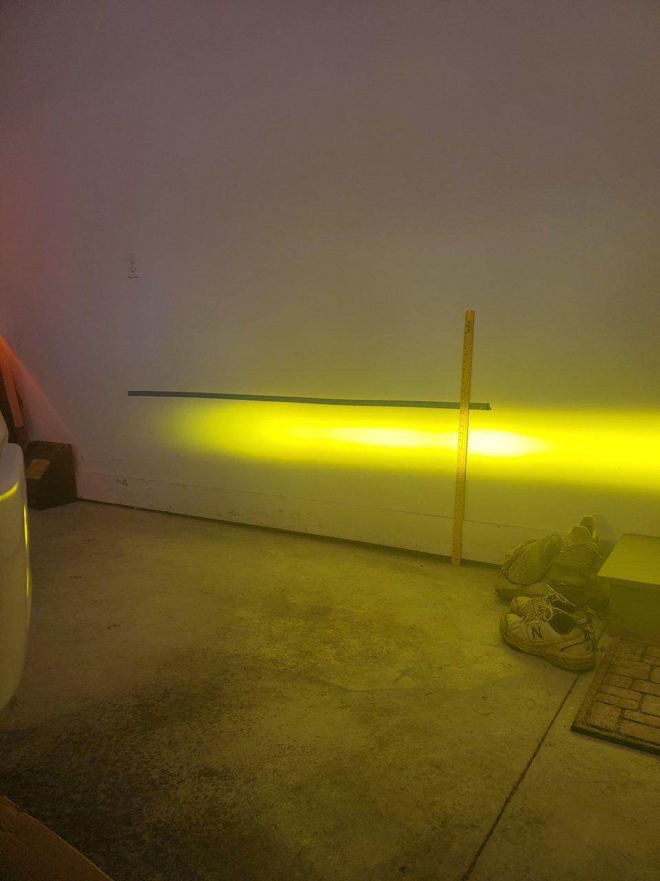

    Hotspot was probably the wrong term. Picture shows 2 definite lines on the ruler. Which would you use?

    The upper line.

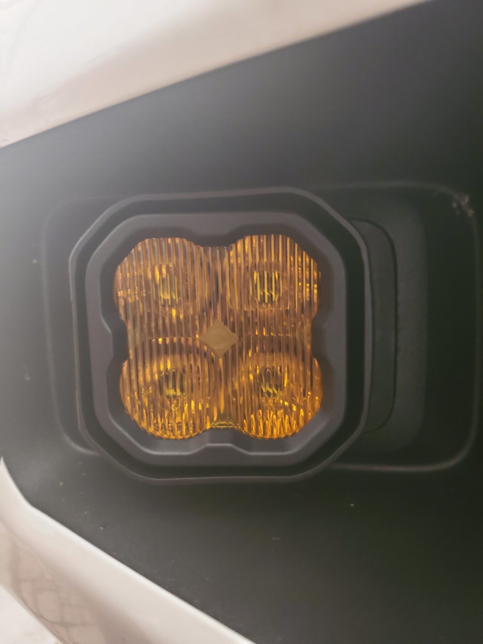

    2020 Ford F-150 platinum
    Looks much better on yours than mine IMO. I'd better learn to like it because I can't get it out without removing stuff.

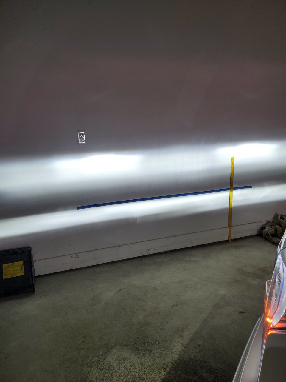

    Would love to know the candela of the factory LED fogs since it appears that the stock fog is overwhelming the SS3 max but not sure. Both aimed the same. One thing is for sure, there's no snow or ice that won't be melted by the max, wow it gets hot.

    Looks like your Max is aimed low vs the OEM LED. It is exceptionally doubtful the stock LEDs overwhelm the Max, but if you wanted to lend me one of your Ford OEM LED fogs I can provide all the comparison specs. PM me if interested.

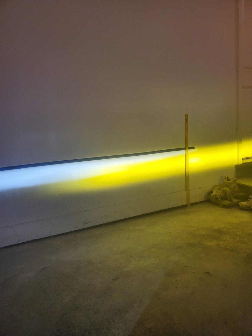

    I'll send you the one I just took out as I'd love to know. This thread is 252 pages long but I'm betting you remember. What fogs did someone post pictures of that weren't flat across the top but "V" in the middle? I may have to readjust because the gap is not even left to right.

    Are you referring to the original DD Tacoma fog release? Using both mount screws on 2nd gen had it not sitting level horizontally, but using a single mount screw like 3rd Gen fixed the issue.

    Yep, that is it. Do you think that could possibly be contributing here? I thought it was a DD thing.

    Your gap difference looks small. I’m unfamiliar with the F150 mounts. On the Tacoma’s there was an OEM fog design change from 2nd Gen to 3rd Gen, but the fogs were compatible if installed correctly. On 2nd Gen, if the DD fogs were installed like 3rd Gen (which they were designed for) with only the one screw they worked, but if you used the same install points as 2nd Gen with 2 screws then they were tilted. Somewhat confusing, but if installed properly they were level.

    Are your pics of just one light on?
  18. Aug 10, 2021 at 8:33 AM
    #5018
    toledoupsguy
    toledoupsguy Well-Known Member
    Jul 19, 2021
    #371680
    293
    Haskins OH
    Yes, thought it made a direct comparison easier. Not your fault, not bitching at you but you'd think a $520 msrp item would come with an allen wrench. Had to go scrounging for a loose one and couldn't find one. Ended up using a long one with a ball end, think the angle I had to come in might have contributed to me not having the light in square. If that is causing the drop in the middle.
