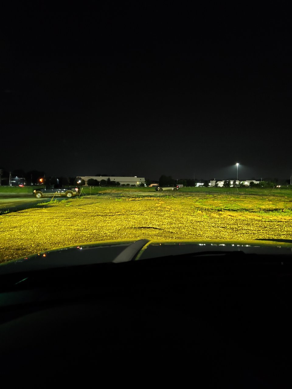

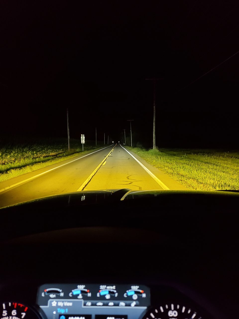

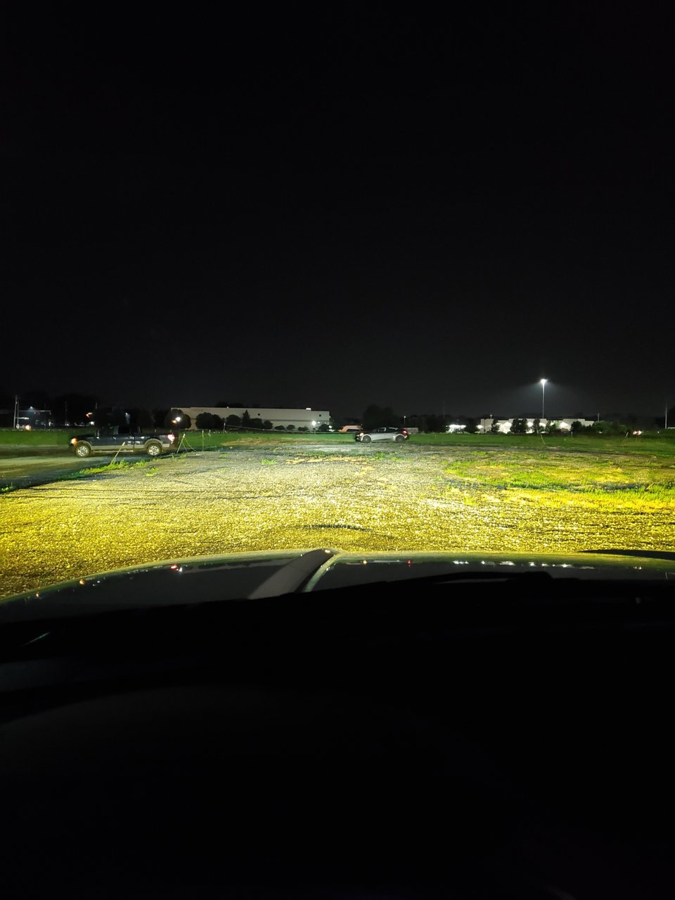

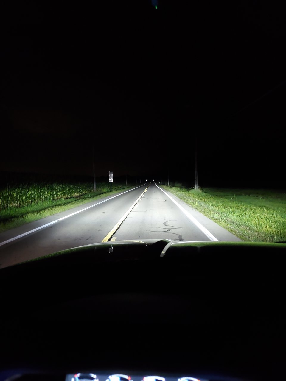

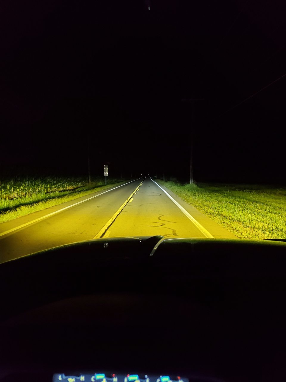

    The pictures look pretty darn impressive to me as they over power your headlights. The Max is currently the highest output intensity fog on the market, there is literally nothing brighter. Using a white lens instead of yellow will eliminate the color filtration losses for even higher output vs the yellow as mentioned before, and it sounds like that would be the best fit for you if you really don't like the yellow output or the cosmetics of the dark yellow optic. Fogs are a poor weather lamp though, and yellow is the best color for poor weather performance, but if you don't like it you don't like it. Fortunately it is just an optic swap on the Max, and not an entirely different lamp like the Sport and Pro. You might post some pics of the front of the truck to compare white vs yellow optics as well, even though it is just personal preference.

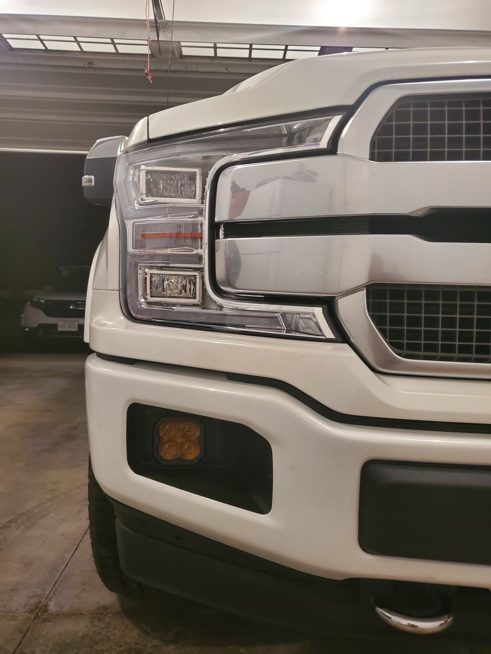

    Go to sleep for 6 hours and look what happens. That is a great offer, didn't remember that from our conversation. If you haven't already sent them please hold off. It will be a real hassle to do the comparisons. Unlike DD's own installation video on the F150 kit you can get the factory fogs out without taking anything apart. BUT, you can't get these out without the bumper and then the factory fog buckets coming off. So to swap lenses to do comparison and then again to put both yellow or clear on is going to be a PITA. Maybe not something done at 5am when I get home and my family oblivious to what crazy stuff dad's doing to the truck now.
    Do appreciate it greatly. Oh, too many pictures from the FNG:)

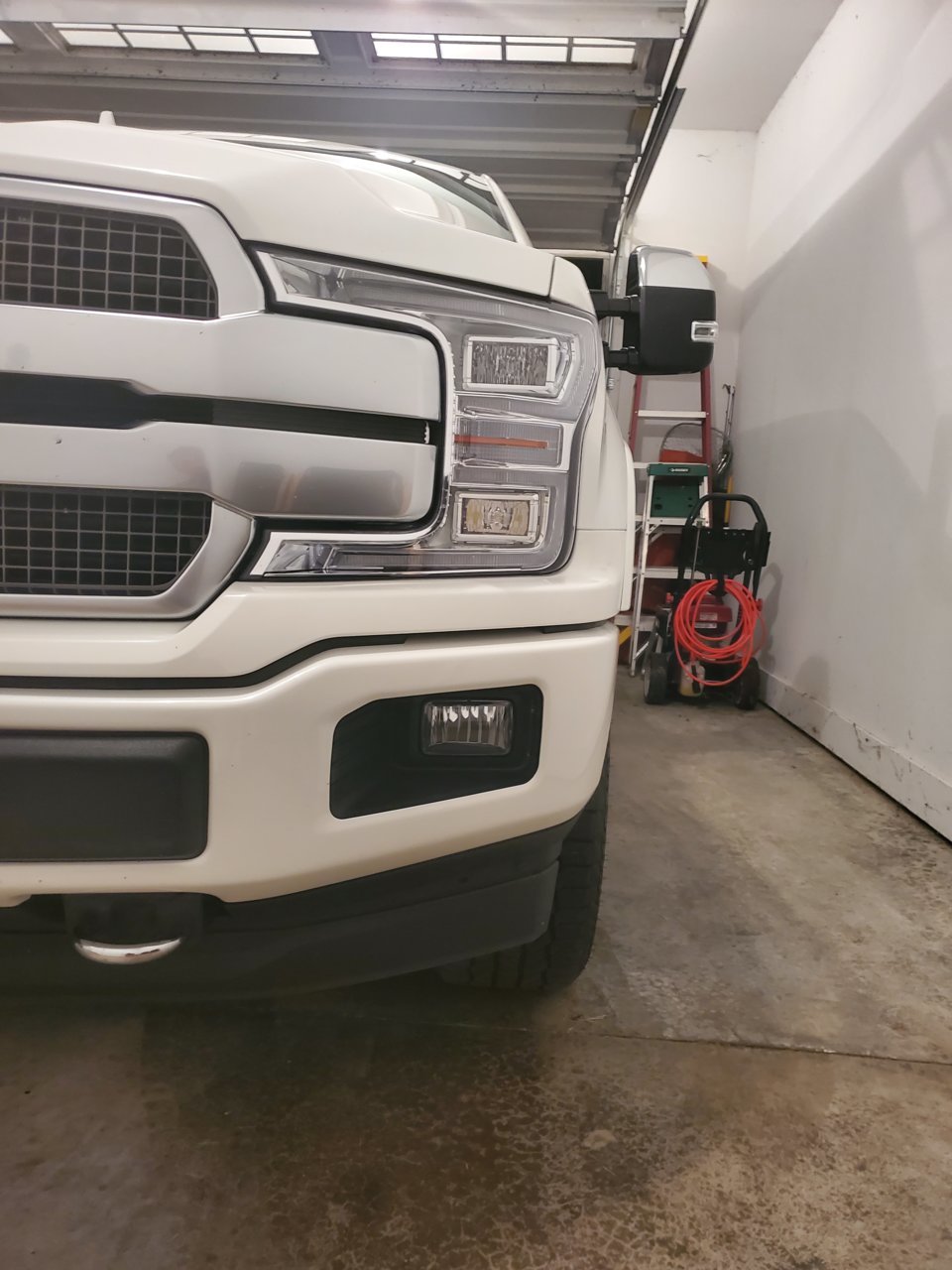

    At this point it is coming down to just the look of the amber (yellow) pod in the bumper. Screams aftermarket like putting on one piece of carbon fiber trim. I was (possibly still am) considering the KDF dual pod mount that replaces the stock single fog bucket. It would definitely scream (no, make that SCREAM) aftermarket too but in an acceptable way. Yep, I'm F'ing crazy.
    I knew smidge was a technical term, I have it listed right next to SWAG:) The function is growing on me.
    Definitely AWESOME service, much better than I deserve.
    the pictures are looking impressive. I think my problem, and it is my problem being too anal, is the look when not in use.
    clear lense would solve that issue but it will be a PITA to change.

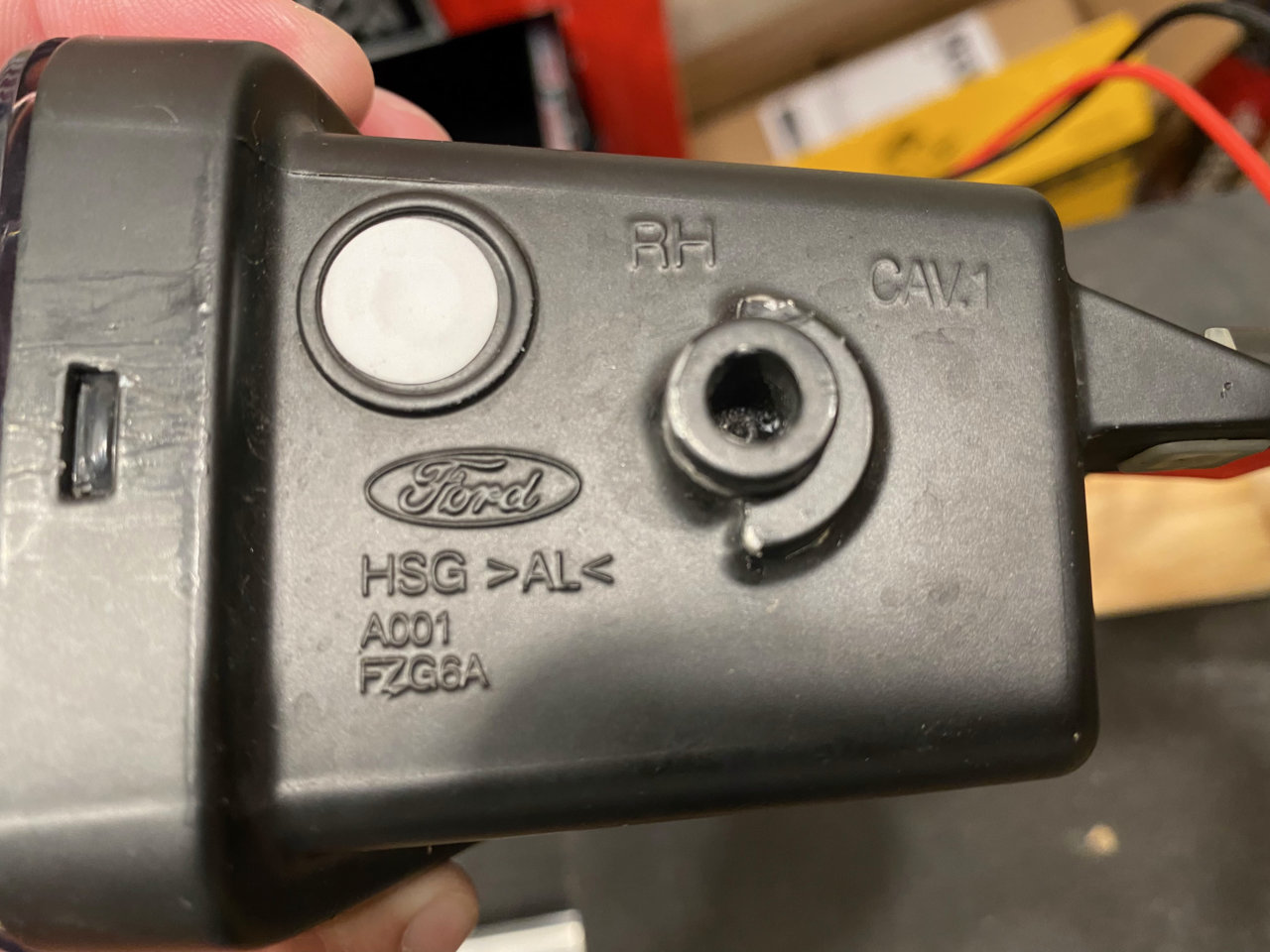

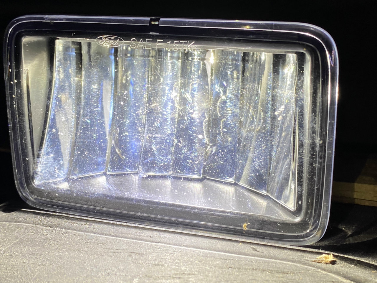

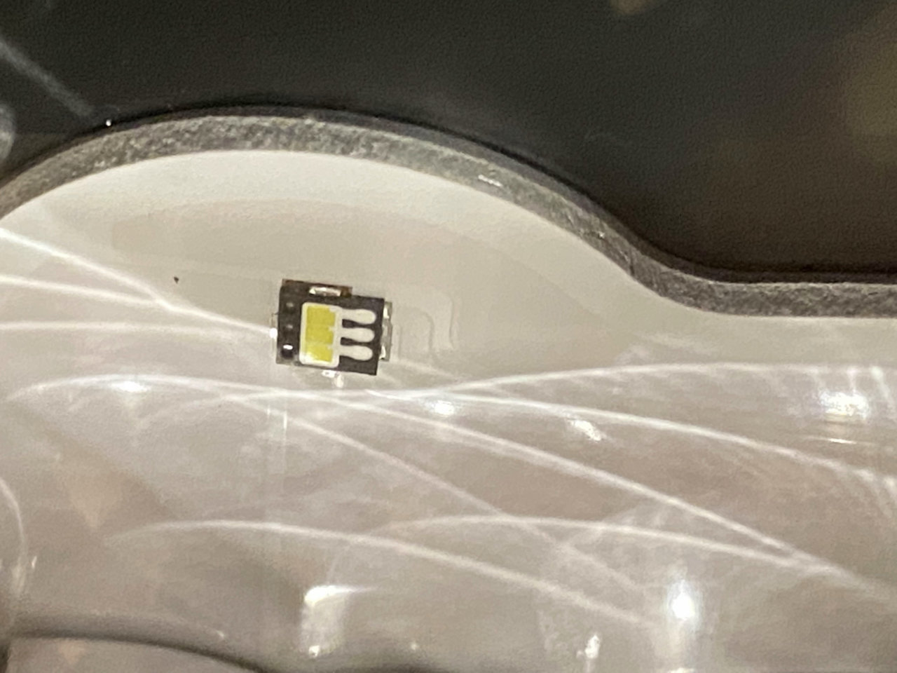

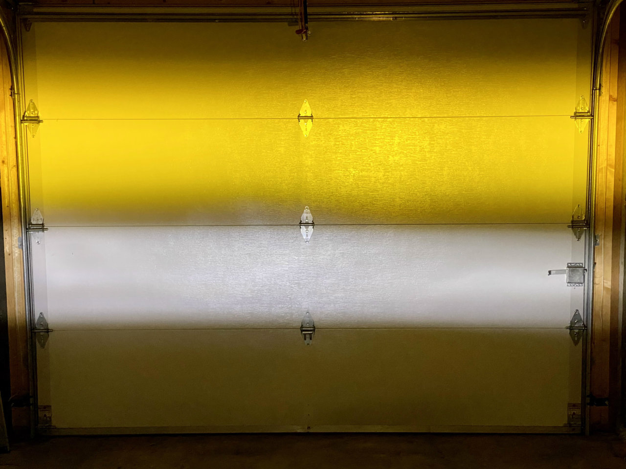

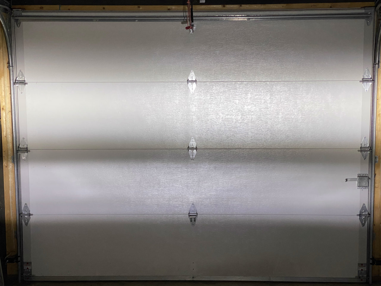

    2020 Ford F150 OEM LED Fog comparison
    The 2020 F150 LED fogs are a top mount multi-LED unit firing down into reflector optics similar to early Toyota LED fogs and the same way the Toyota's OEM Tacoma LED headlights are designed. Top down firing LEDs into reflector optics is designed to minimize glare output and un-reflected exposure to the LED.
    One of the things that should be minimized in this design is the flat surfaces below the LED emitters, as these will reflect uncontrolled light. Ford didn't bother to extend the reflectors and optics to cover the lower portion of the lamp and instead tried to mitigate the design by painting the lower surface black to avoid reflection. Unfortunately this isn't entirely effective and does result in stray glare above the cut off. I'm not even sure these would actually pass an SAE compliance test.
    Down facing emitters, surprisingly stacked in a front to back arrangement and not side-to-side.
    Also interesting, these OEM LED fogs were void of any branding or manufacturing info other than Ford. Valeo makes Toyota's OEM fogs as well as many other manufactures, power consumption is sometimes stamped on the lights, but with these no information is provided other than this side of the lamp. The breather is obviously above the Ford logo.
    Reflector lights are the most efficient light projection technology. Similar to how KC's Gravity series provide extreme performance for little power draw, or Toyota's OEM LED headlights have outstanding performance with minimal power input, Ford has also utilized reflector technology for their OEM LED fogs. After a stabilized runtime these consume about .6A, which translates to about 8.6w. For comparison the Max draws 2.66A, or about 37w, massively more than Fords OEM units.

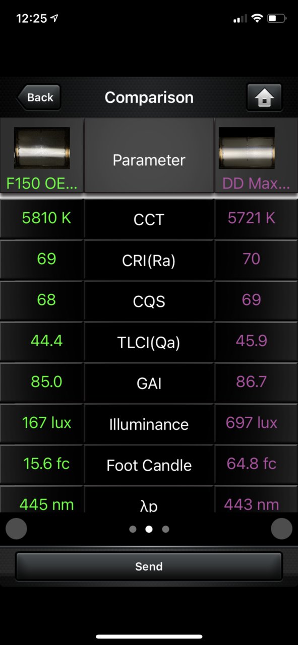

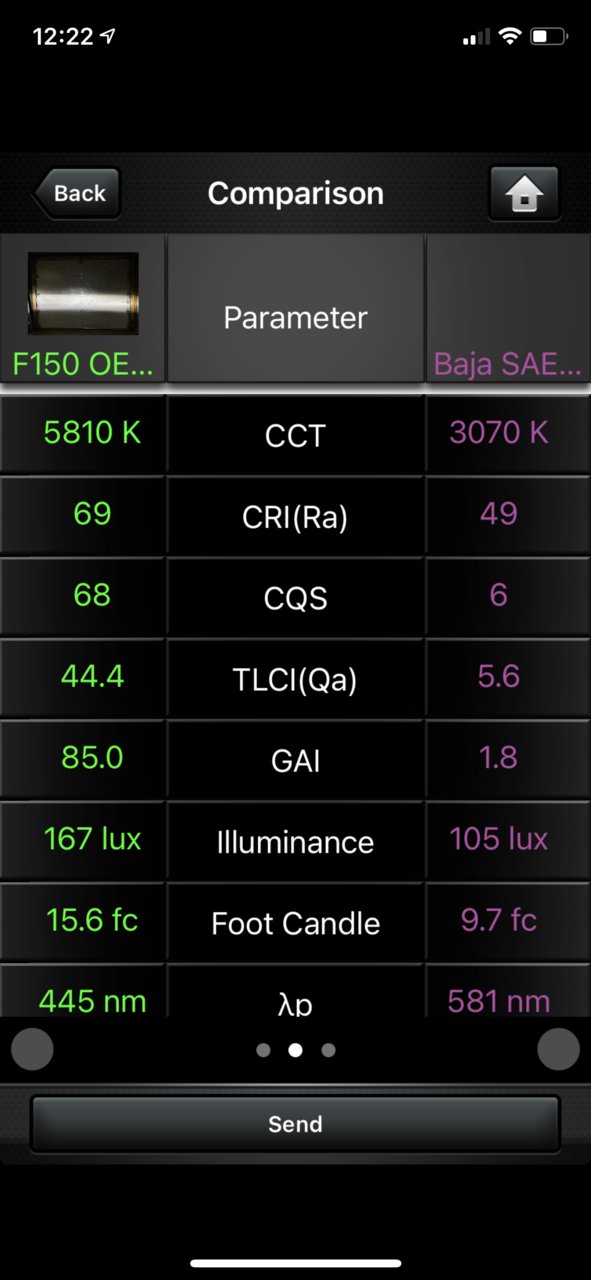

    Questions have been posed, how does the F150 OEM LED fogs compare to the DD Max?
    For starters the Max has 1.5 vertical panels vs the F150s OEM LED at 1 panel height, so the Max will cover a larger vertical area. But of course what is most interesting is output intensity.
    Max 560 lux vs OEM 167 Lux at 18', a performance increase of 3.35x while also utilizing a more poor weather effective selective yellow.

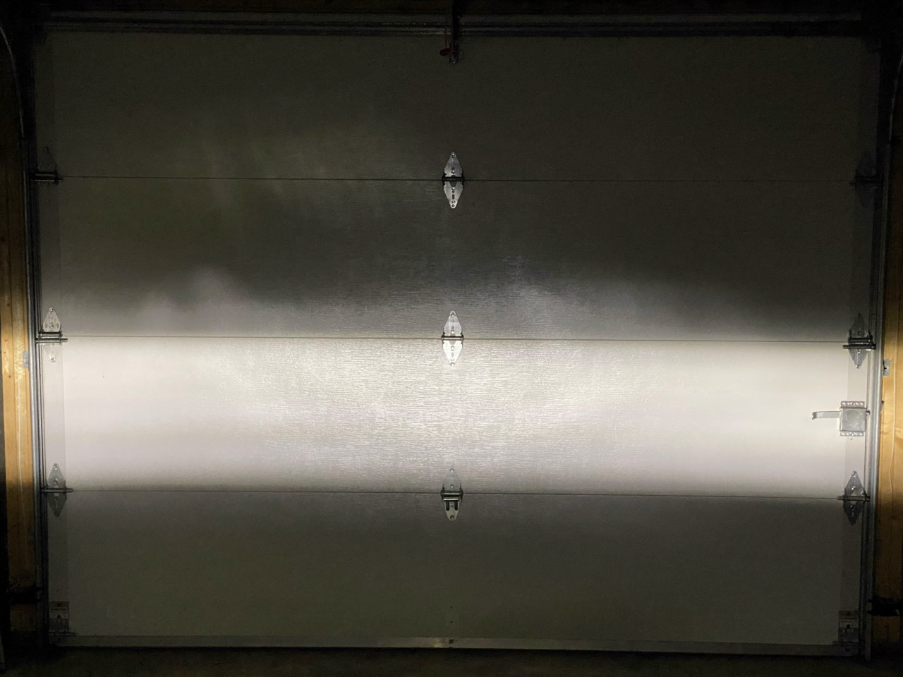

    What about white?
    White Max (top) vs F150 OEM LED fogs (bottom)
    Again the Max covers a larger vertical area but OEM covers a slightly wider area. Max on top.
    Output intensity difference is most interesting, as the pictures do not do it justice.
    The white Max is 4.17x higher output intensity vs stock LED. FOUR X+. That is absurd for a lighting performance improvement in something like a fog light.

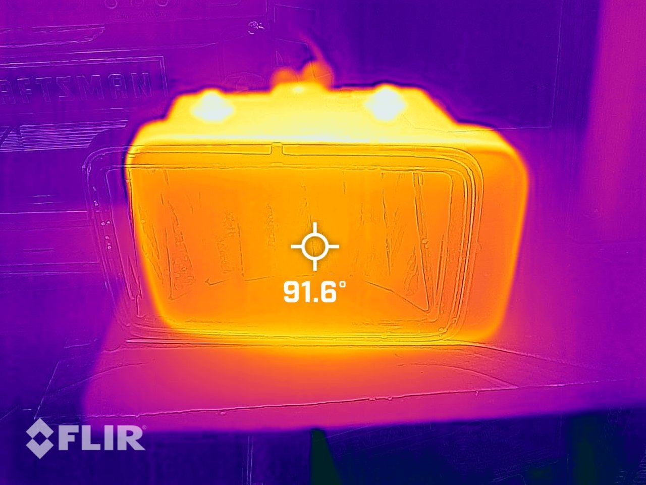

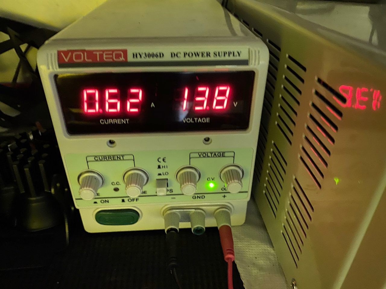

    If you look at operating temps, the Max is 100+ degrees over 65 degree ambient, to the point the light will melt your skin and boil water.
    At 76 degrees tonight, the Ford OEM LED fog runs just 15 degrees over ambient. As typical with the efficient reflector optics, the output and heat generation will be insufficient to self clear in slow conditions. These were barely warm to the touch, meaning these lights will be a poor choice for snow conditions, which is one of the purposes of a fog lamp.
    Another interesting comparison is comparing Fords OEM LED output to Baja's SAE LEDs. The OEM Tacoma halogen H11 fogs outperform the Baja SAE's in peak output intensity, but how do the OEM Ford LED fogs compare?
    Baja 105 lux for yellow and 121 lux for white.
    So if you have F150 OEM LED fogs and swapped to Baja SAEs, you'd be paying to take a 28-37% loss in output intensity vs stock.
    Thanks to @toledoupsguy for sending me the OEM Ford LED fog. Hopefully this information has helped you in your decision making. In the case of the selective yellow, the Max completely blows away the OEM Ford LED fogs to a ridiculously extreme extent, so I really think it is the yellow color you are struggling with. I'd encourage you to try it in poor weather, but if you don't like it the clear lens swap will result in even higher output. I'll get that OEM LED fog shipped back to you ASAP.

    Interesting, the SAE "F 15TK" lens marking doesn't really seem to pull up any sort of published standard in a cursory search of SAE's site.
    Great comparison Crash.
