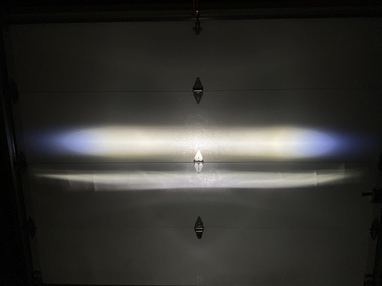

    One more test with @toledoupsguy F150 OEM LED Fog. Comparison width test of the F150 fog vs the SS3 Max. The F150 fog has just a slightly wider pattern vs the Max (top).

    OEM Ford beam saturation is a bit weak. Intensity looks way lower too. Am I surprised? Nope.

    Do you happen to have a full shot of the SS3 pro vs max together?

    Off hand, no. But could certainly take one. I have these comparison shots from the Max review.
    SS3 Pro SAE Fog
    The new SS3 Max SAE Fog
