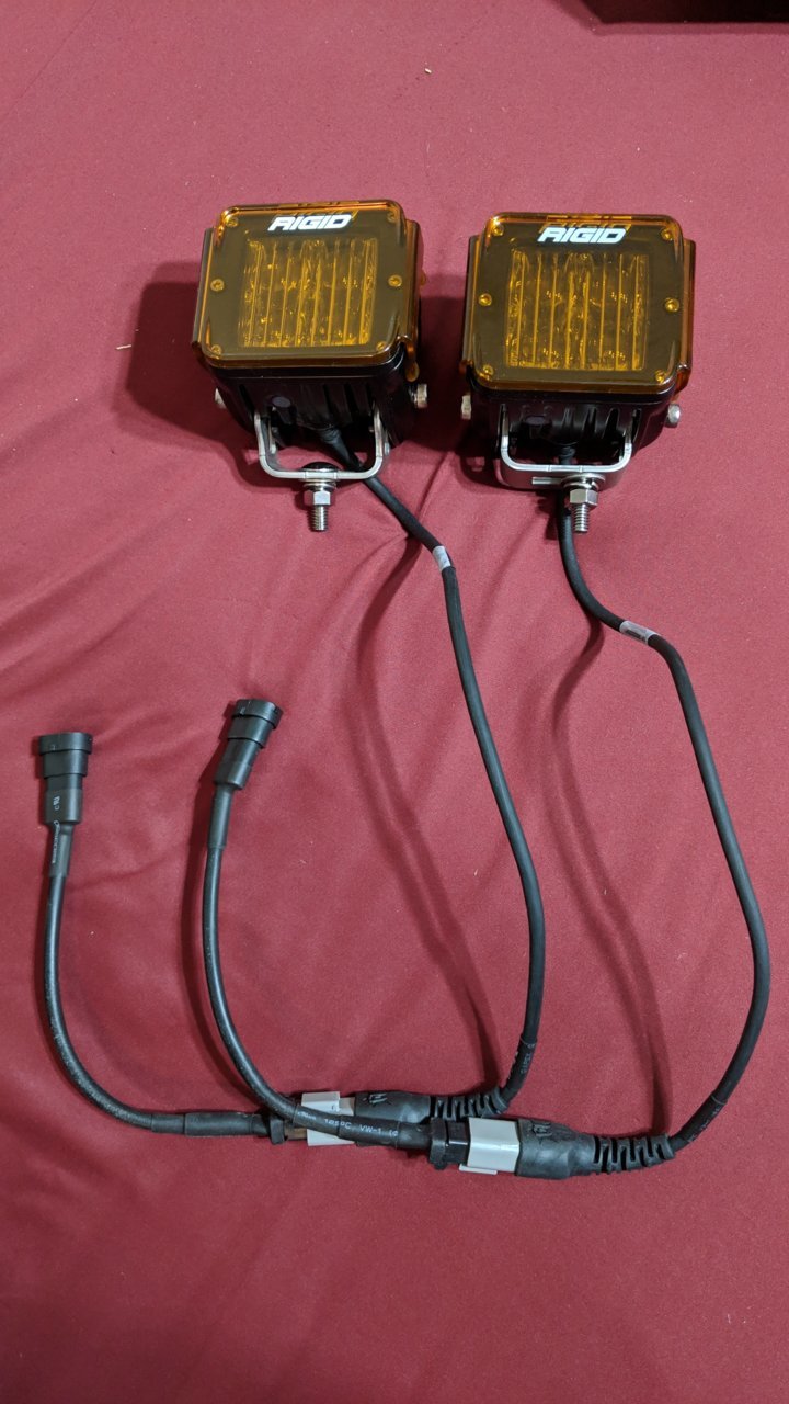

    Would love to put the Rigid led fog pods on my civic, but unsure of how to mount them. Does anyone have any suggestions? Circled in the picture is where I like them to be placed. Also, would hanging them upside down create the same beam pattern?

    Welcome! I get plenty of non-Tacoma lighting questions.
    Quick google search doesn’t return anything helpful, this looks like you would have to make/figure out your own mount. I’m guessing all that up front is just plastic, you’d want to mount these to some type of metal base, otherwise on a plastic mount you’d get lots of beam bouncing.
    The Rigids can be run upside-down although that will mean the branding on the front is also upside-down. You can also position the mount to go straight out the back for a rear mount for other mounting options.
    snahfu[QUOTED] likes this.

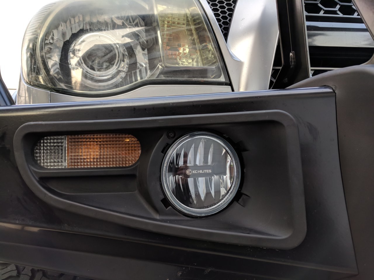

    I don't know how I missed this post, but thank you for the excellent information and testing of the fog light products. Good fog lights make a huge difference at night in rainy conditions and in the thick fog that is common in the morning on the hill I live on. I currently have the KC Gravity G4 amber fogs retrofitted onto my ARB bumper. I initially hesitated due to the price, but they are significantly better than the ARB units though I am interested in what Baja Designs will come out with.

    Nice! Looks very clean. ARBs bumper light terminology is very confusing, they call their bumper lights driving/fog lights, which are exact opposite patters. The ARB lights are a high beam driving light (not fog), so switching to a true fog light for your use case should have a major performance improvement as it is actually the needed pattern for what you are trying to accomplish.

    Those look excellent in there!
